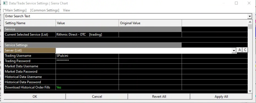

Why cant I connect any Rithmic connection to Sierra? I tried both Apex paper trading login and with the broker Advantage futures and neither of them work and it will not give me a server option for the live broker.
image2025-01-29_17-32-43.png / V - Attached On 2025-01-30 00:37:15 UTC - Size: 153.26 KB - 304 views

Refer to steps 7 through 11 at the following link:
Rithmic Trading Platform Service: Setup Instructions
Date Time Of Last Edit: 2025-01-31 13:55:51
[2025-01-31 13:17:27]
User135243 - Posts: 328
I guess we all have the same problem (or at least most). If you try to connect to Apex, enter your username/password and click A and Apply All and thereafter shut down SC and come back to the connection area and now you should see the servers

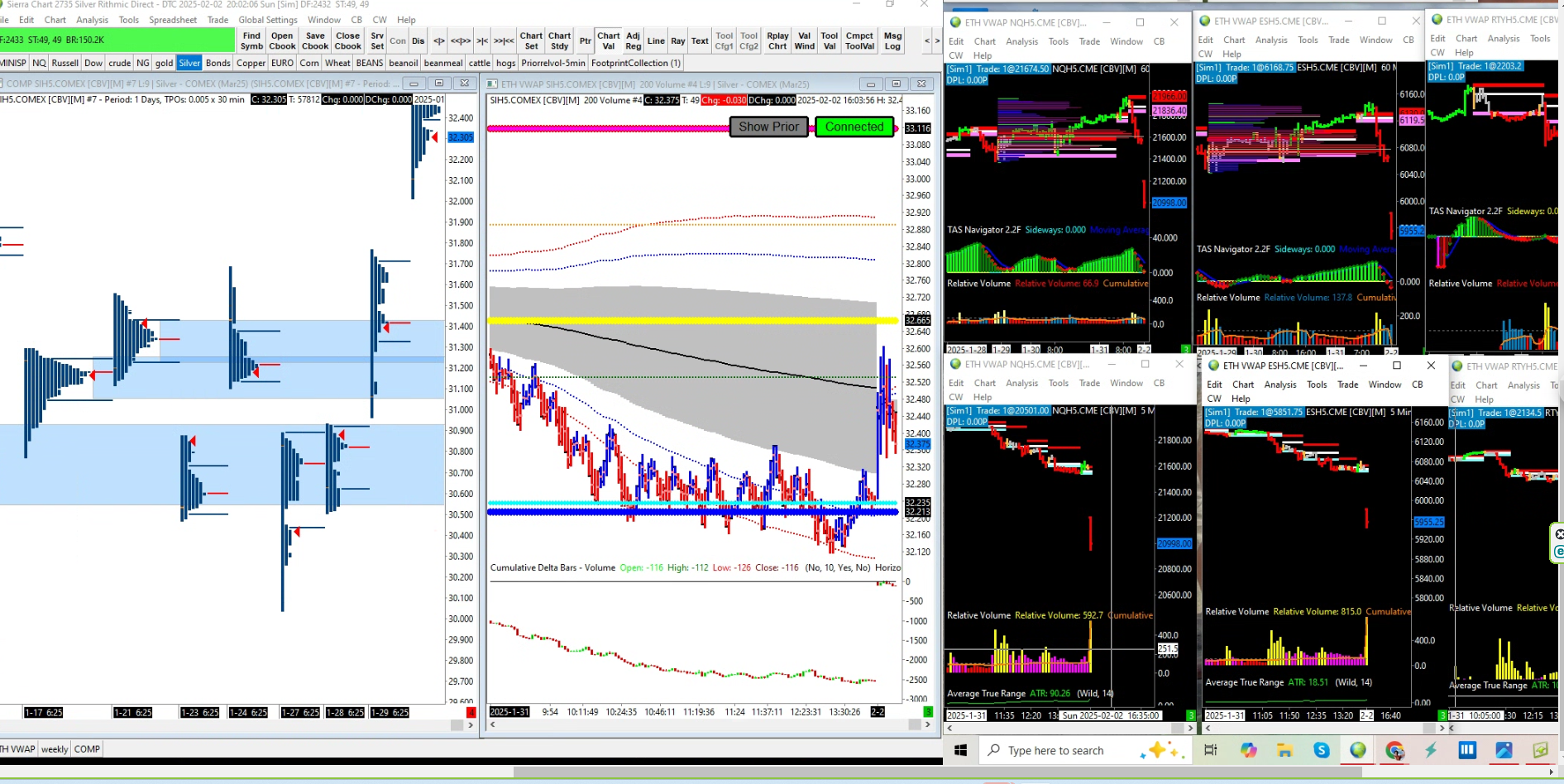

Thank you. That worked and it shows I am connected but my charts are not updating.
image2025-02-02_20-02-12.png / V - Attached On 2025-02-03 03:03:46 UTC - Size: 1.44 MB - 334 views

Sierra_Chart Engineering - Posts: 25341
Regarding post #4, activate the exchanges that you need here:

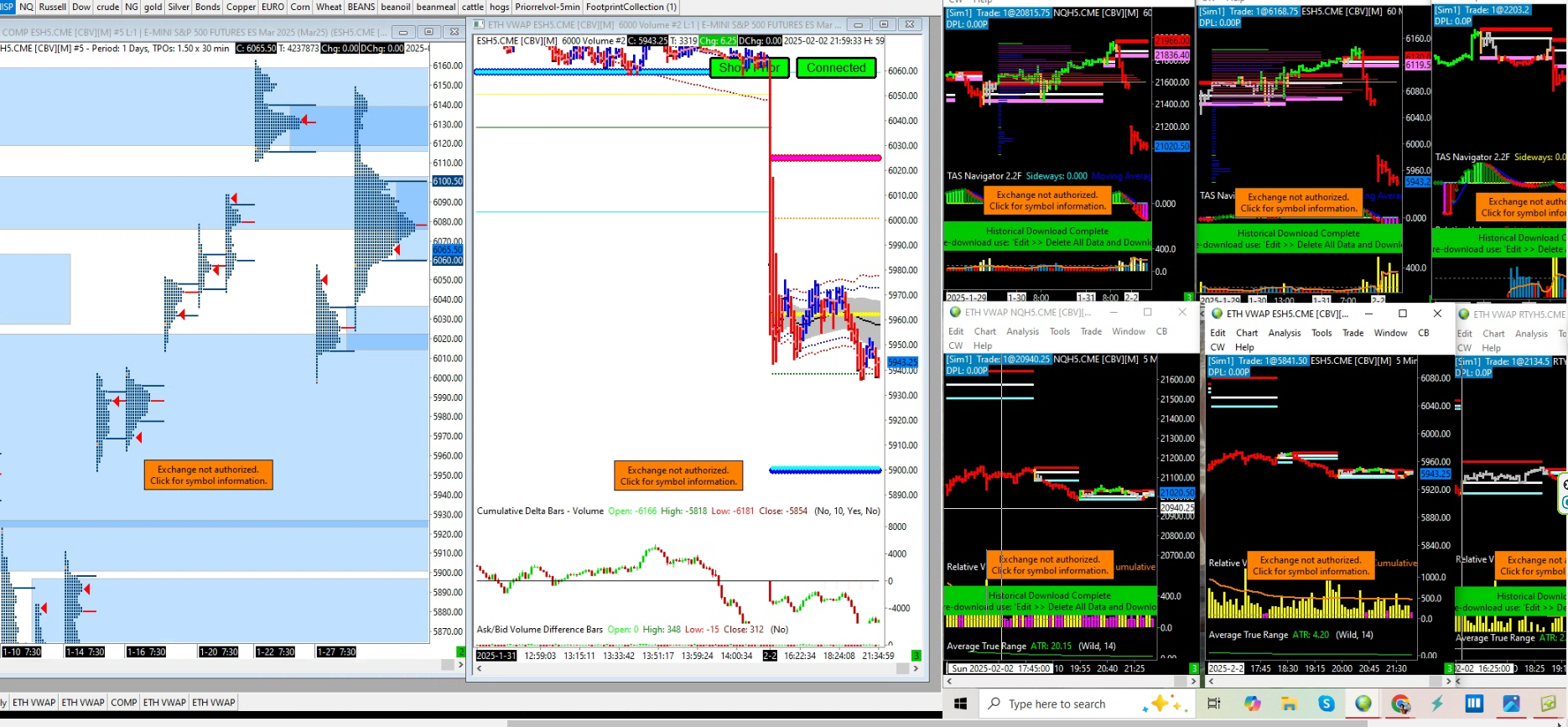

User968091 - Posts: 48
Im getting the following messages in the screenshot.
image2025-02-02_22-10-03.png / V - Attached On 2025-02-03 05:10:24 UTC - Size: 1.26 MB - 326 views
The easiest thing to do is to activate the CME Top of Book exchange here:
This will resolve the problem for you.
Also newer versions of Sierra Chart, require the Denali Data Feed be used with Rithmic. This is 2727 and higher.
