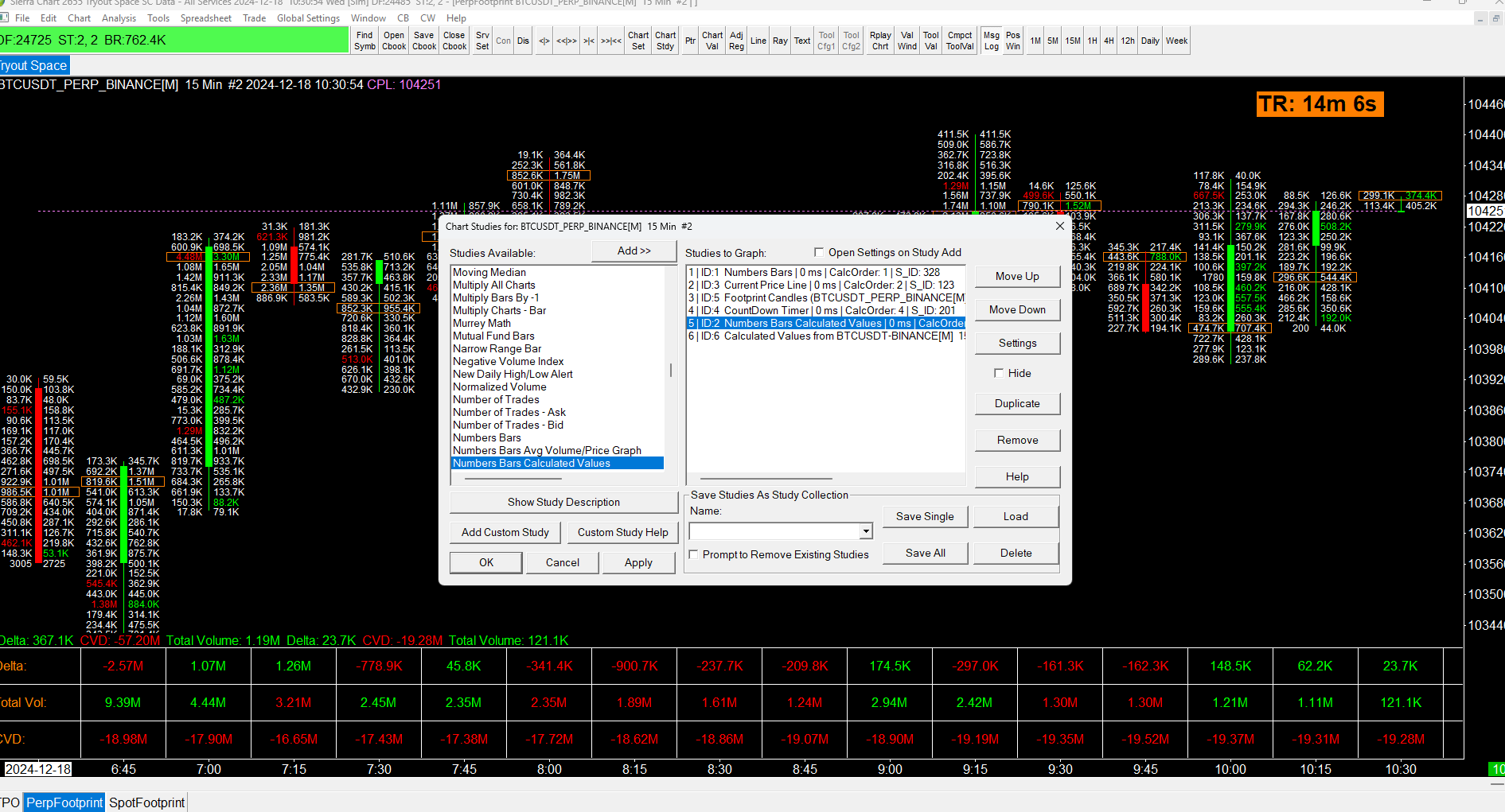

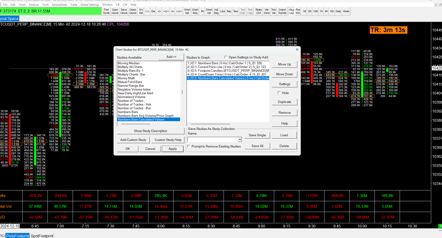

RocMarci - Posts: 21
So what I did was duplicate my initial number bars calculated values study and the only thing I changed is to reference one of them to the spot market.
As soon as I do that my initial calculated values rows disappear from the chart and get replaced with the ones from the spot market.
If I then delete the calculated Values study that references the Spot Market, the initial rows from the futures market appear again.
imageScreenshot 2024-12-18 112705.png / V - Attached On 2024-12-18 10:32:11 UTC - Size: 186.71 KB - 176 views
imageafter.png / V - Attached On 2024-12-18 10:32:14 UTC - Size: 201.26 KB - 232 views
[2024-12-18 10:34:27]
It does show me the values from the initial study above the new rows, even though I didn't change any settings, but the initial rows are missing.
If I use move up/down in the study window the rows switch to the one that is below the other
Date Time Of Last Edit: 2024-12-18 10:43:39
[2024-12-18 15:48:25]
Since you duplicated it, the Region is most likely set be the same. Make sure the region for the two Numbers Bars Calculated Values are different. Refer to the following:
Chart Studies: Settings and Inputs Tab >> Chart Region
[2024-12-18 15:55:51]
Ah, makes sense, tyty!
