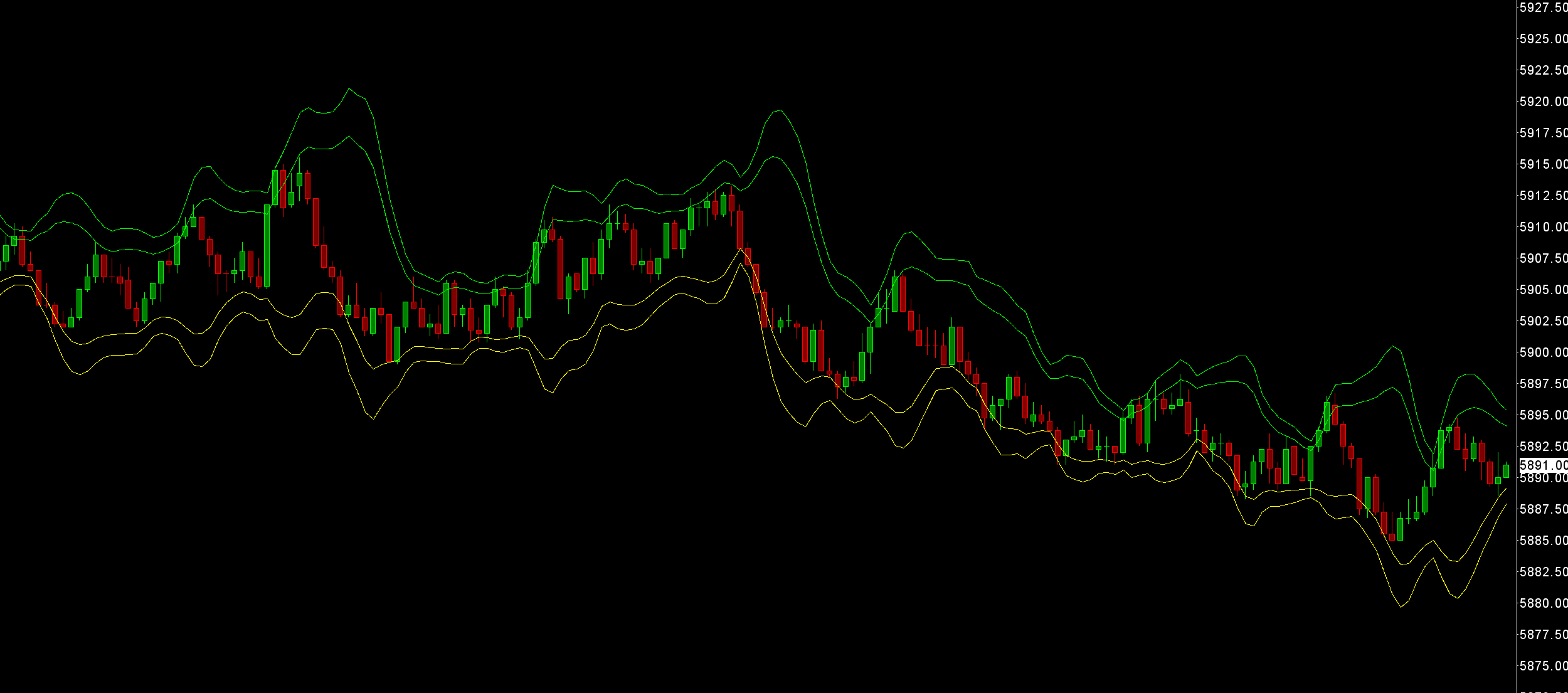

User585104 - Posts: 162
This pic is 2 Bollinger band studies, how can I shade the 2 bands that have been created?
Thank you
imageScreenshot 2024-11-15 180729.png / V - Attached On 2024-11-15 18:10:34 UTC - Size: 82.02 KB - 233 views

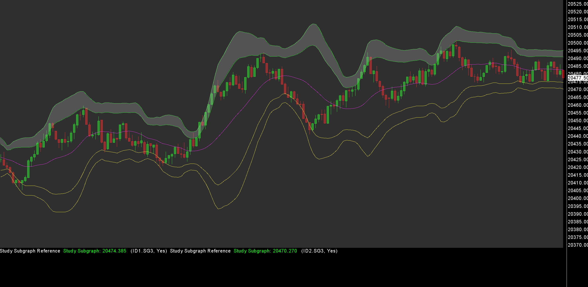

So I've done the top ribbon here for you too see, this is all I can ever manage. So it kind of works but for some reason it shades the entire chart not just the ribbon and I can make it not shade the entire chart. I'm using transparent fill to do this. I do this with automatic scale but I for this demo I just tried same as region with the same result. Any further guidance would be awesome
imageScreenshot 2024-11-15 204107.png / V - Attached On 2024-11-15 20:45:05 UTC - Size: 108.52 KB - 232 views
[2024-11-15 21:03:39]
Attached is a Study Collection that does what you are wanting. Use it directly or as a guide. Refer to the following for how to use it:
Study Collections: Using a Study Collection Provided by Sierra Chart Support
With regards to the issue you are seeing, it would imply that you have the Top and Bottom fill options reversed, or if you can think of it as having the subgraphs reversed. But again, take a look at our Study Collection to help you figure it out.
attachmentFilledBollingerBands.StdyCollct - Attached On 2024-11-15 21:03:37 UTC - Size: 64.31 KB - 496 views
[2024-11-15 21:27:52]
Amazing thank you!
Looking at the study collection I can see where I was going wrong now, awesome thanks!
[2024-11-16 07:53:51]
Yep so your collection works perfectly =]
I was trying to reproduce it myself for future reference and it wouldn't work, then I realised that all along I was using study subgraph reference and the not study SubgraphS reference. All good now thanks
