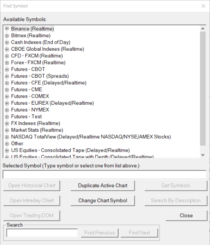

Goldsea - Posts: 13
Thank you, when I open find symbols this is not what I see.
Is this because of my data fee? I currently under the Denali - Full CME Group (CME, CBOT, COMEX, NYMEX) for non-professional Trading accounts - @ $5.5 per month.
Appreciate your help on this matter.

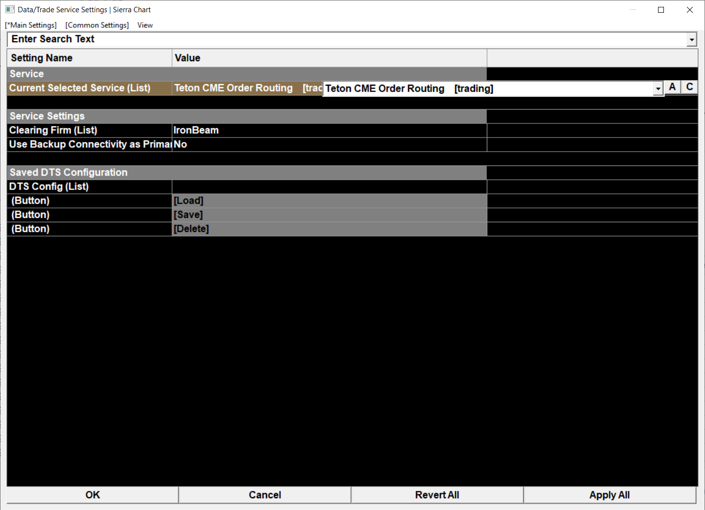

[2024-10-29 23:37:17]
John - SC Support - Posts: 48526
What is "Global Settings >> Data/Trade Service Settings >> Main Settings >> Current Selected Service" set to?
[2024-10-30 10:45:13]
Goldsea - Posts: 13
It is set to Teton CME Order Routing, under ironbeam.
[2024-10-30 10:45:47]
Goldsea - Posts: 13
See attached
imagesierrachart2.PNG / V - Attached On 2024-10-30 10:45:38 UTC - Size: 127.2 KB - 207 views
[2024-10-30 15:54:16]
The correct symbol for this is the following:
NGZ24-NGH25.FUT_SPREAD.CME
You have an Underscore instead of a Period before the CME at the end.
If you found the symbol through "File >> Find Symbol" then it should have been correct, and we are curious as why it would not be.
[2024-10-30 20:25:11]
Goldsea - Posts: 13
Many thanks, this works now.

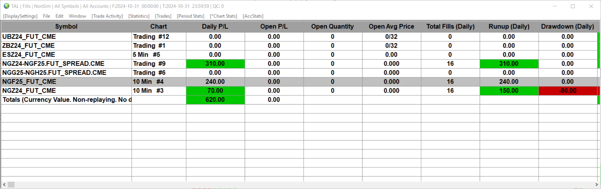

[2024-11-01 10:33:28]
Goldsea - Posts: 13
Can you advice on how to remove NGF25 and NGZ24 from my Chart Stats, I have removed those charts from my chartbook, but it is still there.
As right now, it is showing double PnL
Date Time Of Last Edit: 2024-11-01 10:47:29
imagesierrachart3.PNG / V - Attached On 2024-11-01 10:31:07 UTC - Size: 221.18 KB - 214 views
[2024-11-01 15:15:30]
Sierra_Chart Engineering - Posts: 25421
Go to each of those charts, #3 and #4, and set this Chart Setting to No:
Chart Settings: Include Chart Trade List in Trade Statistics for Chart Window (Chart >> Chart Settings >> Trading menu)
Also those charts must actually exist. They must. Maybe in another Chartbook that is open.
