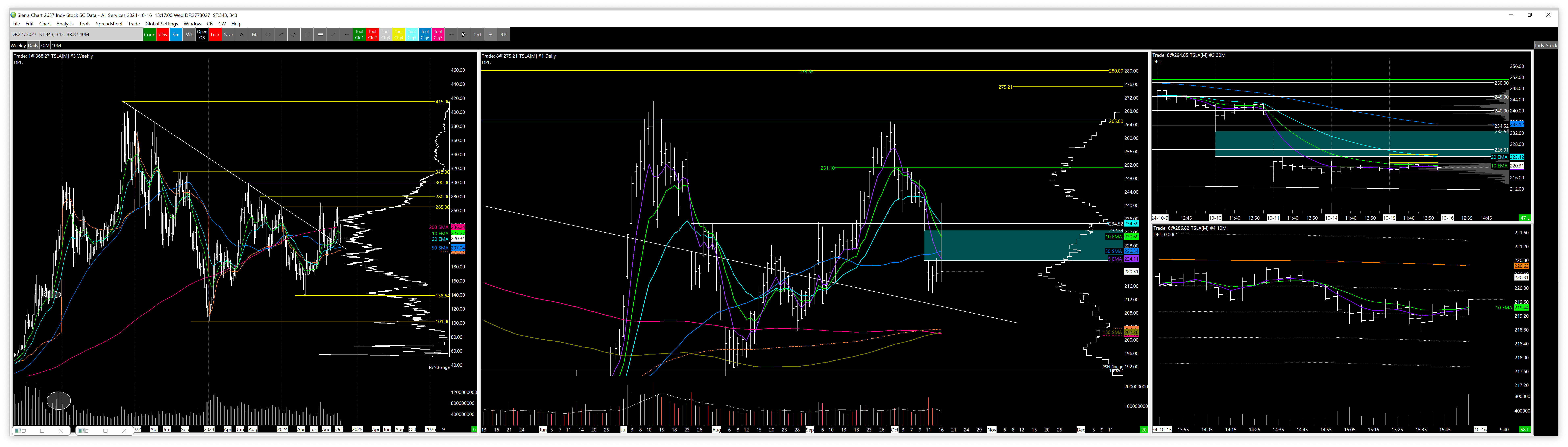

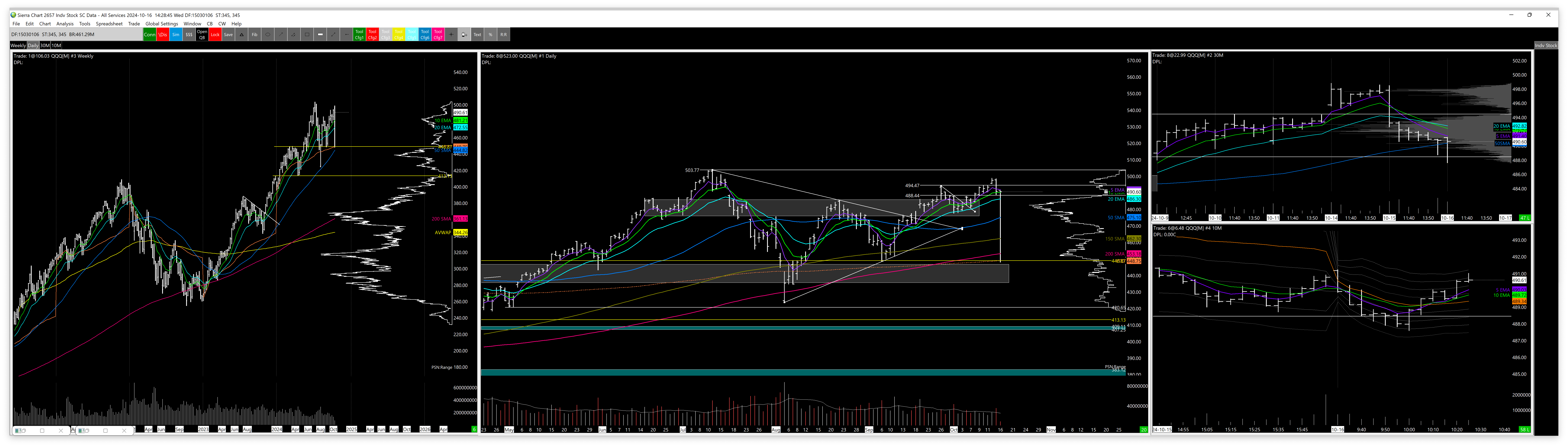

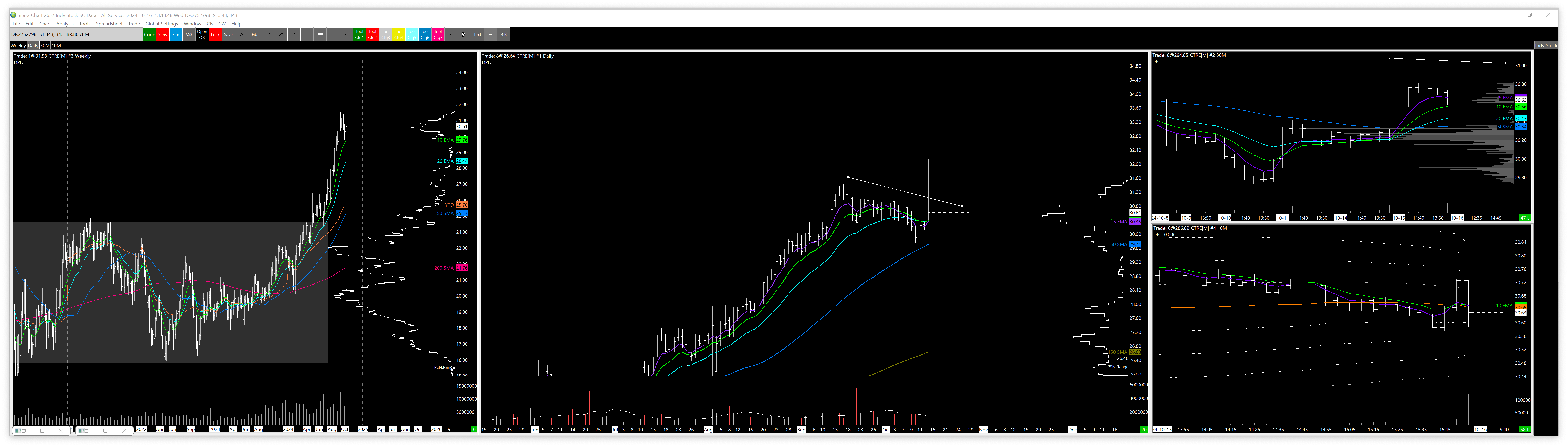

This is an ongoing issue that has been reported once before and a solution to my problem has not been found.
some of my daily and weekly charts are showing data that does not exist. Price has never traveled to the levels showing on day’s bar. attached are a few examples from today. this is only accruing on daily and weekly charts that are marked Historical in the chart setting. how do I fix this issue so it reflects the same data im showing on the intraday charts.
In the past a sierra engineer had said that this is how the data comes in and there is nothing they can do. that same data is registering correctly on intraday charts but not on historical charts so I believe the issue is somehow related to the chart settings.
Thank you in advance.
imageScreenshot 2024-10-16 at 7.28.46 AM.png / V - Attached On 2024-10-16 18:18:35 UTC - Size: 1.22 MB - 237 views
imageScreenshot 2024-10-16 at 6.17.01 AM.png / V - Attached On 2024-10-16 18:18:43 UTC - Size: 1.29 MB - 356 views
imageScreenshot 2024-10-16 at 6.14.48 AM.png / V - Attached On 2024-10-16 18:18:51 UTC - Size: 1.17 MB - 350 views

The closing price is not the problem, the high and low are the problem. look again at the pictures attached. the range of the daily and weekly bar is sometimes 3-10 times the range of what they should be.
for example in the qqq chart picture the high of day is roughly 491 and the low is about 448. the actual high and low are 491 and 487 roughly. the difference is 11 times greater. this is no small mistake this is a huge problem that needs to be addressed. please take a closer look at the images attached and compare them to the actual daily quotes. I am unable to conduct business with errors like this.
also, please note that at the end of the day the charts fix themselves and the weekly and daily historical charts reflect the same data in the intraday charts.
thank you in advance. looking forward to hearing back from you and getting this fixed.
