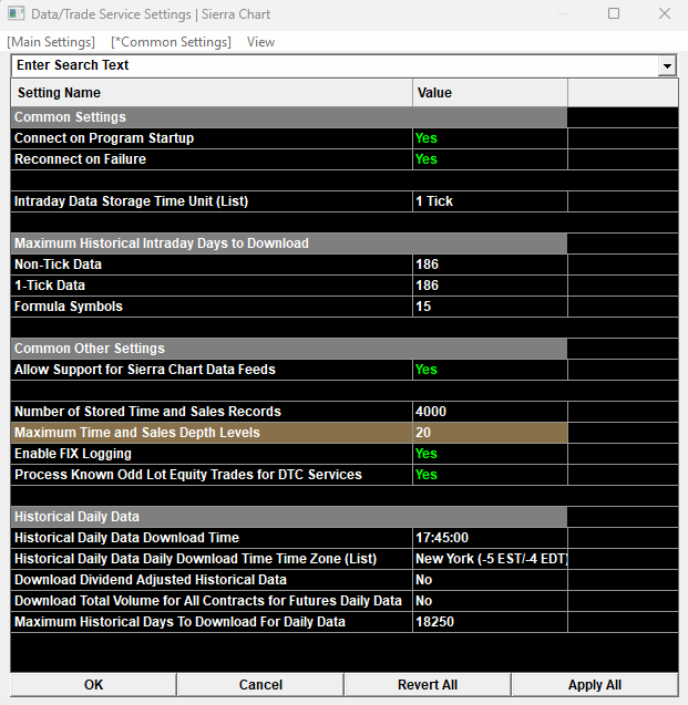

My data provider (Rithmic) gives Lvl 2 data. Until 2 days ago i could see the depth in DOM but for some reason now they appear as Lvl 1 data. When i try to reconnect it gives me for a second the Lvl 2 data and then goes back to Lvl 1. I have enabled the allowance of Lvl 2 data stream in both Global Settings > Data/ Trade Service Settings and within the chart itself as you can see on the screenshots. Is there something i'm missing or something i changed without realising it?

[2024-10-15 15:40:17]
Refer to the following:
File Menu: Not Receiving the Full Number of Market Depth Levels
Separately, we want to point out that you have the following exchange active with our Denali Exchange Data Feed:
- CME with Market Depth for non-professional Trading accounts
But you are not getting this data from us, as your "Verified Until" date is in the past (it is currently set to "2024-08-31"). This means that you have not connected to your live, funded, futures trading account since before that date. As such, you are not verified as a Non-Professional for the CME Group and you are not able to get the data from our data feed.
If you do not want this data from us, then be sure to deactivate that exchange at the following link:
https://www.sierrachart.com/UserControlPanel.php?page=DenaliDataFeed#Exchanges
Or, if you do want to get the data from us, then you need to connect to your live trading account. Once you make that connection, your "Verified Until" date will change to be 30 days in the future. You can view this date at the same link given just above.

I had changed the setting of depth of market data in the symbol settings and i hadnt noticed it. Once i set the correct option then everything works fine.
