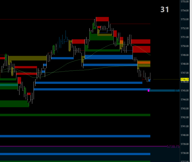

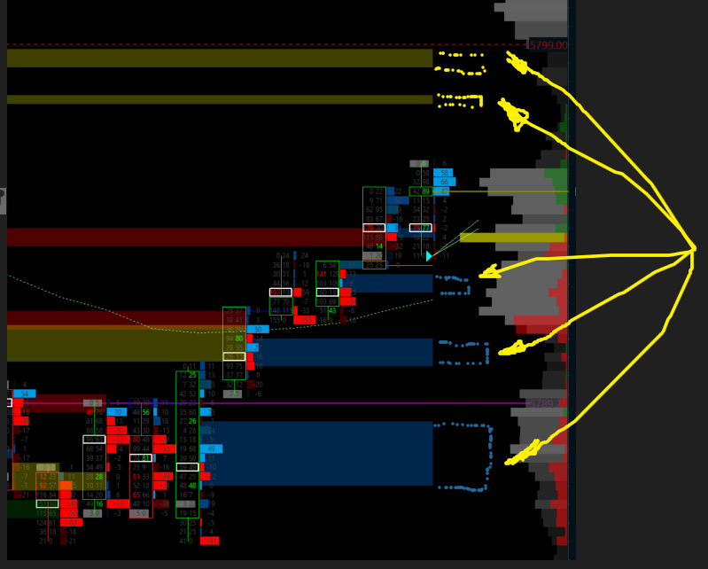

hi this is giovanny. is there any way to extend the studies drawings like the blue, red, gren, wvaw etc beyond the last?? candle.??
or maybe move only candles like little back so i can see the studies forming.
i have studies like stacked imbalances or value area for candles and wont show until the last candle is completed and because is on the edge will not show until the next candle start forming.
lock fill space will not work because moves everything drawing and last candle too.
please help. thank you

If these are drawings, such as rectangles, then use the "Extending Rectangle" drawing instead of the rectangle.
If these are subgraph displays from a study (such as VWAP) and you are displaying lines, then you can set the "Draw Style" to be "Line Extend to Edge", which will then project the last value forward. Refer to the following:
Chart Studies: Line Extend To Edge (ACSIL: DRAWSTYLE_LINE_EXTEND_TO_EDGE)

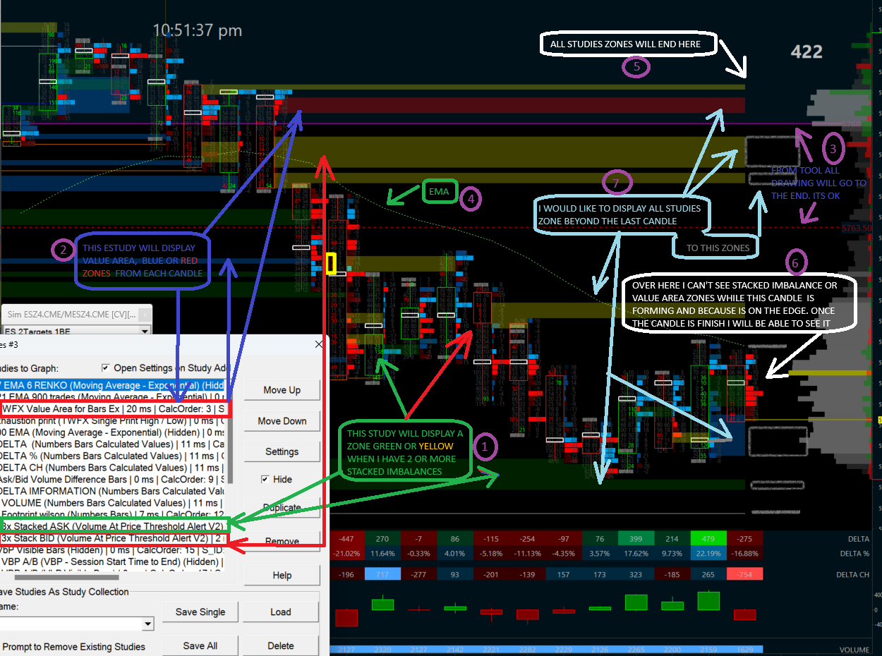

HI. SORRY FOR BOTHERING YOU. LINE EXTEND TO EDGE DOES NOT WORK. DRAWINGS FROM TOOLS ARE OK. WILL DISPLAY ALL THE WAY TO THE END, BUT ALL MY STUDIES ZONES WILL FINISH ON THE SAME SPOT, WHERE THE LAST CANDLE IS AND WONT DISPLAY ZONES WHILE THE CANDLE IS FORMING. I WOULD LIKE TO DISLPLYA BEYOND THE LAST CANDLE. I GONNA ATTACH ANOTHE PICTUREC PLEASE TAKE A LOOK. THANK YOU

The drawings you are referencing from the "Volume at Price Threshold Alert" are extension lines. These are different from the above and there is not a way to get them to display into the forward area.
We are not sure what study you are using that is labeled as "WFX Value Area For Bars". But the above information probably applies - if those are extension lines, then there is not a way to extend them forward.
