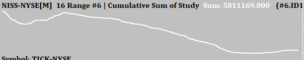

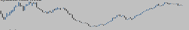

[2024-09-30 22:32:30]
BigBagel - Posts: 69
Thanks. Im still a little new to it, but how is it such a big difference in the information when comparing the normal NISS-NYSE to the adv/decline line. Shouldn't they be exactly the same?
imageadvdec line.png / V - Attached On 2024-09-30 22:32:04 UTC - Size: 6.52 KB - 292 views
imagenyse chart.png / V - Attached On 2024-09-30 22:32:11 UTC - Size: 1.78 KB - 213 views
[2024-10-01 14:30:03]
The Advance/Decline Line will be a lagging indicator, as it is the cumulative sum of the Last of the Net Issues. So it adds up all the previous values and displays the current sum total.
[2024-10-01 14:36:08]
So the NISS-NYSE alone is the current difference between the adv and decline?
[2024-10-01 15:24:49]
Yes. Refer to the following:
