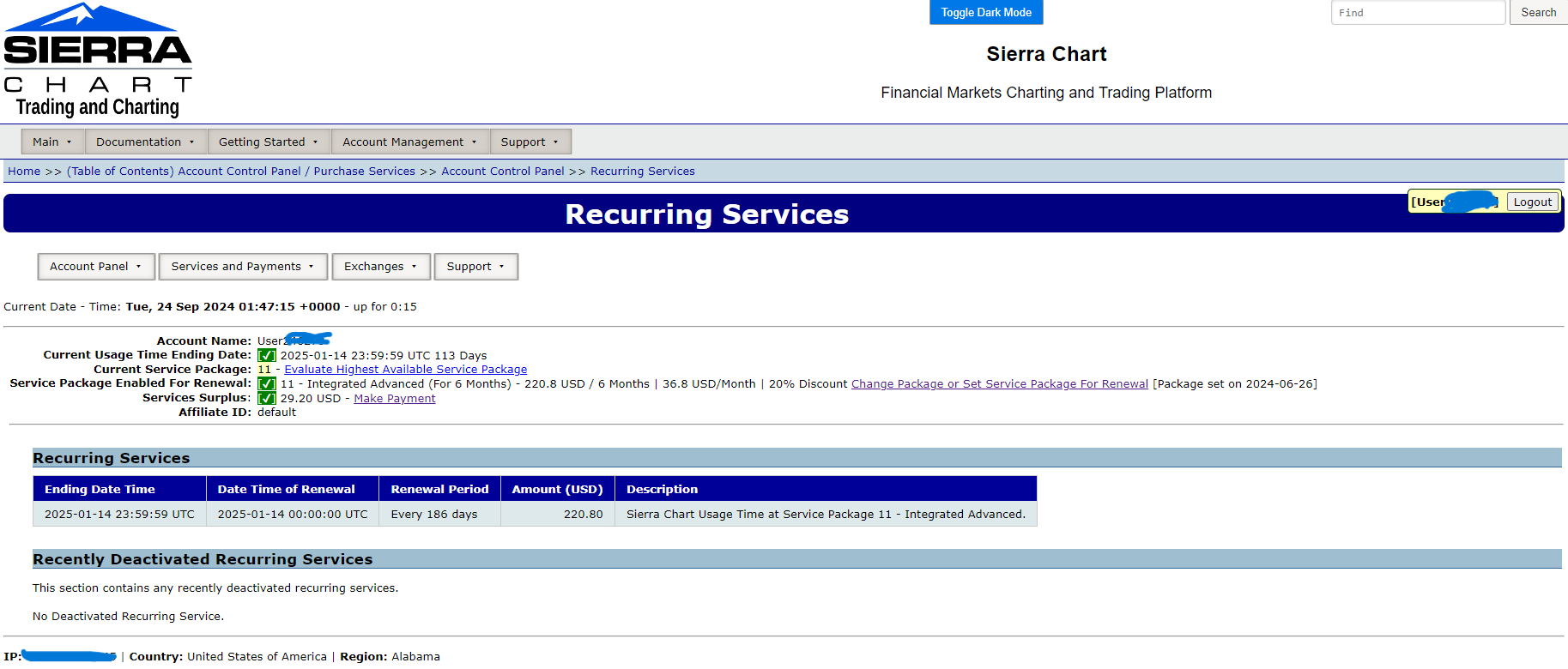

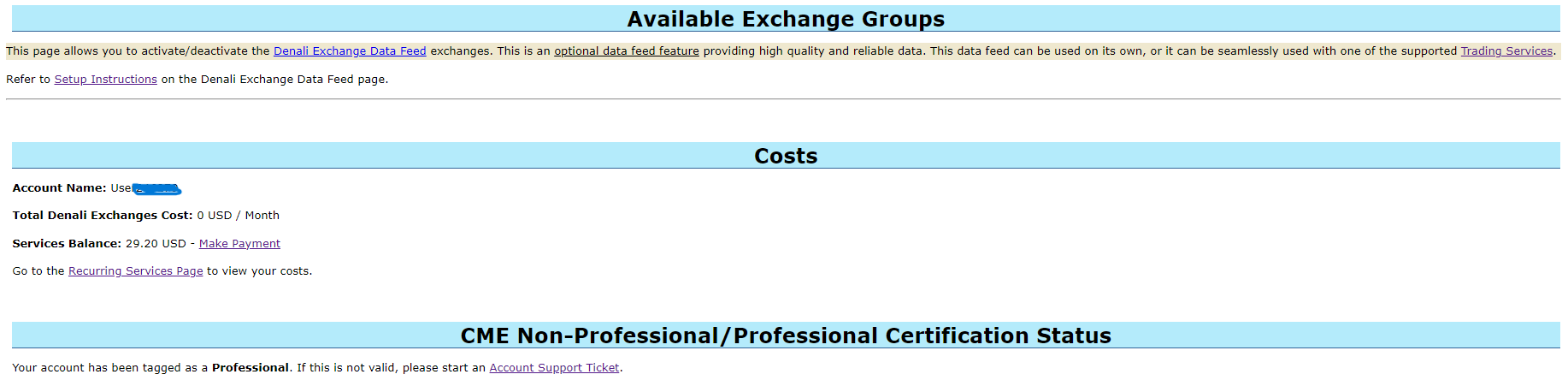

Thank You for responding. I do have Denali data, but when I was just checking it looks like I was flagged for professional data. Pls see screenshot. Also please point me to where I may be requesting to download too much data.
Thank you

[2024-09-24 13:31:52]
You are NOT currently setup to get any data from our Denali Exchange Data Feed. You were at one time, but since you did not fill out the exchange agreements properly you could not continue to be tagged as a Non-Professional and your status was changed, which also deactivated the exchange(s) that you had active.
To get our Denali data again, you need to complete the agreements at the following link:
https://www.sierrachart.com/UserControlPanel.php?page=ExchangeAgreements
When filling out the "Uniform Subscriber Agreement", you need to enter the "Clearing Firm" (or brokerage name if you do not know your Clearing Firm) and "Account Number" for your live, funded, futures trading account. Refer to the following for more information on what is required to be a Non-Professional for the CME Group:
Real-Time Exchange Data Feeds Available From Sierra Chart: Understanding and Accessing Data From the CME, CBOT, NYMEX, COMEX Exchanges
After you take care of the agreements and they are accepted, then you can activate the Non-Professional exchange(s) at the following link:
https://www.sierrachart.com/UserControlPanel.php?page=DenaliDataFeed#Exchanges
