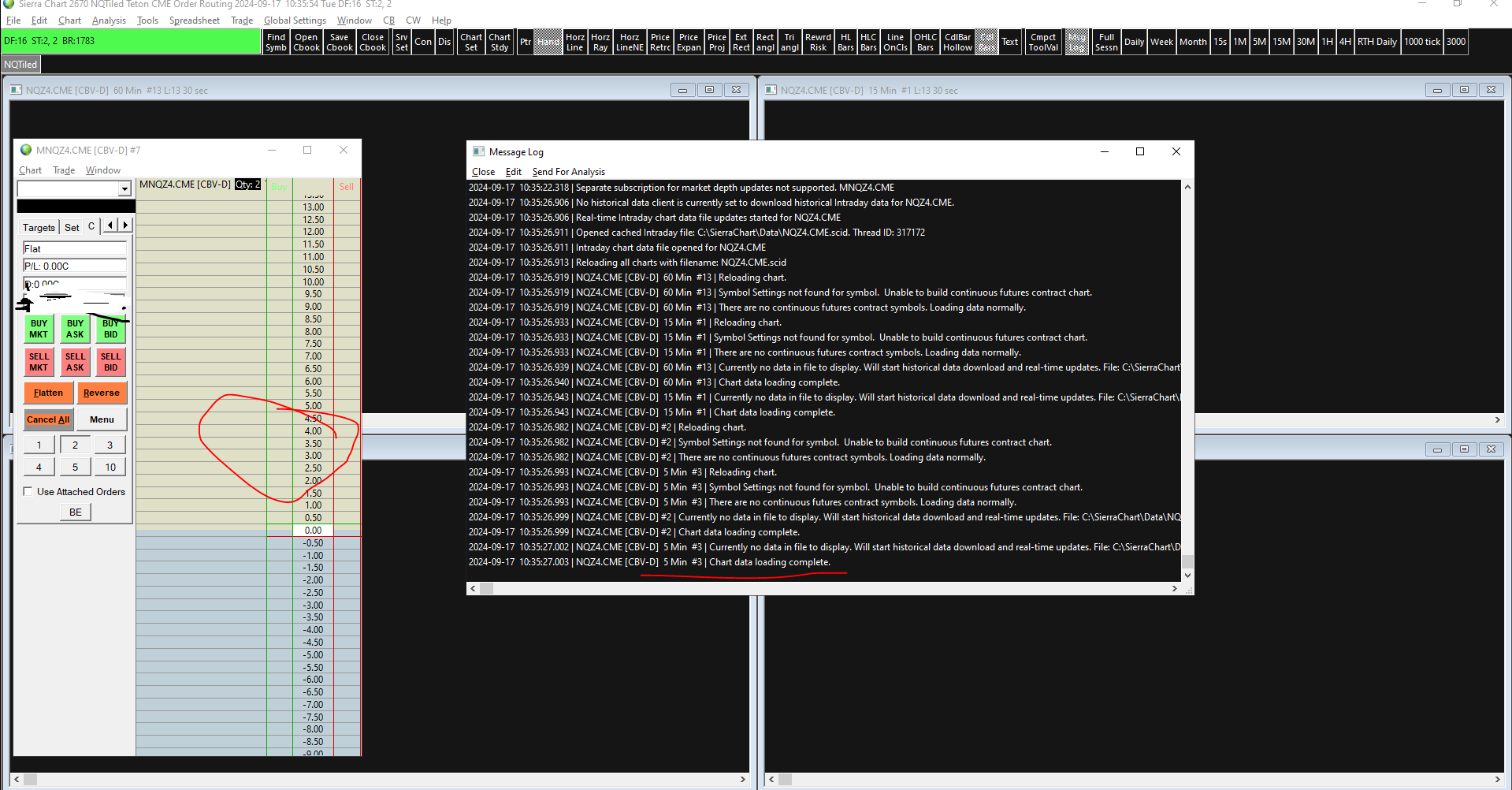

Please refer to the attached image. I tried opening the charts using the rithmic login as well as the teton login but the charts are either frozen or blank. Can you please assist.
imageCapture.PNG / V - Attached On 2024-09-17 14:47:28 UTC - Size: 169.73 KB - 232 views

You need to ensure that your charts have the proper symbol for the service you are connected to. Open your chartbooks and select "Edit >> Translate Symbols to Current Service".
If you continue to have an issue after this, then we would need to see your Message Log by following these instructions:
Close all of the Chartbooks with "File >> Close All Chartbooks".
Open a single chart for the symbol you have an issue with through "File >> Find Symbol". Tell us that symbol of the chart. Tell us about *one* symbol only.

Hi John. So the 'Translate Symbols to Current Service' does the trick but I am having to do it frequently. I do not change tickers and trade only MNQ while charting NQ. Below is the log. I just opened the charts and had to do the translate step.

2024-09-17 17:39:40.814 | Opened cached Intraday file: C:\SierraChart\Data\MNQZ4.CME.scid. Thread ID: 329316
2024-09-17 17:39:40.814 | Intraday chart data file opened for MNQZ4.CME
2024-09-17 17:39:40.840 | Teton CME Order Routing | Security Definition request has been rejected. Reason: Unsupported symbol: MNQZ4.CME. ID = 2
2024-09-17 17:39:42.549 | Requesting market depth updates for: MNQZ4.CME if supported. NumLevels=1400
2024-09-17 17:39:42.549 | Separate subscription for market depth updates not supported. MNQZ4.CME
2024-09-17 17:40:20.394 | Teton CME Order Routing | Waiting for socket receive thread to end
2024-09-17 17:40:20.394 | DTC Client socket (1) | CloseSocket call.
2024-09-17 17:40:20.394 | DTC Client socket (1) | Max send buffers used during socket life: 3
2024-09-17 17:40:20.394 | DTC Client socket (1) | Max send buffer size during socket life: 236
2024-09-17 17:40:20.395 | DTC Client socket (1) | Shutdown started. Waiting for graceful close.
2024-09-17 17:40:20.395 | Teton CME Order Routing | Disconnected.
2024-09-17 17:40:20.397 | Will reconnect to the server in 2.0 seconds. Select 'File >> Disconnect' to prevent further connection attempts.
2024-09-17 17:40:20.407 | MNQZ24_FUT_CME #7 | Reloading chart.
2024-09-17 17:40:20.420 | NQZ24_FUT_CME [CV-D] #2 | Reloading chart.
2024-09-17 17:40:20.422 | DTC Client socket (1) | Socket gracefully closed by remote side.
2024-09-17 17:40:20.423 | DTC Client socket (1) | Closed.
2024-09-17 17:40:20.455 | NQZ24_FUT_CME [CV-D] #2 | Performing continuous chart historical Daily data download for symbol NQU24_FUT_CME starting at last date in file.
2024-09-17 17:40:20.455 | Starting DelayedDownloadMonitoringTimer
2024-09-17 17:40:20.455 | Starting HDTimeoutTimer
2024-09-17 17:40:20.456 | Added historical Daily data request for NQU24_FUT_CME to the queue.
2024-09-17 17:40:20.458 | Triggering next historical data download in queue.
2024-09-17 17:40:20.466 | Starting DelayedDownloadMonitoringTimer
2024-09-17 17:40:20.466 | Starting HDTimeoutTimer
2024-09-17 17:40:20.466 | Added historical Intraday data request for NQZ24_FUT_CME to the queue.
2024-09-17 17:40:20.467 | Triggering next historical data download in queue.
2024-09-17 17:40:20.474 | NQZ24_FUT_CME [CV-D] #2 | Performing continuous chart historical Daily data download for symbol NQZ24_FUT_CME starting at last date in file.
2024-09-17 17:40:20.474 | Added historical Daily data request for NQZ24_FUT_CME to the queue.
2024-09-17 17:40:20.511 | NQZ24_FUT_CME [CV-D] #2 | Waiting for historical downloads to complete with the IDs: 1, 2, 3,
2024-09-17 17:40:20.519 | MNQZ24_FUT_CME #7 | StartDateTimeForLoadingOrderFills: 2023-09-11 00:00:00
2024-09-17 17:40:20.521 | MNQZ24_FUT_CME #7 | Chart data loading complete.
2024-09-17 17:40:20.521 | Mapping NQU24_FUT_CME to NQU24. Service code: cme
2024-09-17 17:40:20.523 | HD Request # 1 | Downloading Historical Daily chart data for NQU24_FUT_CME. Starting date: 2024-09-12. Service: sc_futures_direct.dtc.trading
2024-09-17 17:40:20.523 | Mapping NQZ24_FUT_CME to NQZ24. Service code: cme
2024-09-17 17:40:20.523 | HD Request # 2 | Downloading Intraday chart data for NQZ24_FUT_CME to the file NQZ24_FUT_CME.scid. Service: cme
2024-09-17 17:40:20.527 | HD Request # 2 | Download start date-time: 2024-09-17 14:16:15.000000. File last date-time: 2024-09-17 14:16:15.000000
2024-09-17 17:40:20.528 | HD Request # 2 | Using server: ds28.sierracharts.com port 10149
2024-09-17 17:40:20.537 | NQZ24_FUT_CME [CV-D] 60 Min #13 | Reloading chart.
2024-09-17 17:40:20.558 | Socket (2) | Creating socket.
2024-09-17 17:40:20.558 | Socket (2) | New receive buffer size: 0
2024-09-17 17:40:20.558 | Socket (2) | Connecting to IP: 67.214.125.5.
2024-09-17 17:40:20.626 | HD Request # 2 | Setting DTC encoding to Binary VLS
2024-09-17 17:40:20.626 | HD Request # 2 | Sending historical data logon request message.
2024-09-17 17:40:20.700 | NQZ24_FUT_CME [CV-D] 60 Min #13 | Waiting for historical downloads to complete with the IDs: 1, 2, 3,
2024-09-17 17:40:20.710 | NQZ24_FUT_CME [CV-D] 15 Min #1 | Reloading chart.
2024-09-17 17:40:20.751 | NQZ24_FUT_CME [CV-D] 15 Min #1 | Waiting for historical downloads to complete with the IDs: 1, 2, 3,
2024-09-17 17:40:20.756 | NQZ24_FUT_CME [CV-D] 1 Min #3 | Reloading chart.
2024-09-17 17:40:20.776 | NQZ24_FUT_CME [CV-D] 1 Min #3 | Waiting for historical downloads to complete with the IDs: 1, 2, 3,
2024-09-17 17:40:20.777 | Mapping MNQZ24_FUT_CME to MNQZ24. Service code: cme
2024-09-17 17:40:20.777 | Added historical Intraday data request for MNQZ24_FUT_CME to the queue.
2024-09-17 17:40:20.777 | Intraday data recording state for symbol MNQZ24_FUT_CME is set to download 'Pending'.
2024-09-17 17:40:20.777 | Triggering next historical data download in queue.
2024-09-17 17:40:21.116 | HD Request # 1 | Requesting historical Daily data for NQU24 starting at 2024-09-11. SC External HD service.
2024-09-17 17:40:21.139 | HD Request # 2 | Requesting Intraday data. Start date-time: 2024-09-17 14:16:15. Record interval: 5. Symbol: NQZ24
2024-09-17 17:40:21.167 | HD Request # 2 | Decompressing data.
2024-09-17 17:40:21.215 | HD Request # 2 | Receiving Intraday data for NQZ24_FUT_CME starting at 2024-09-17 14:16:15.437000
2024-09-17 17:40:21.245 | Socket (2) | CloseSocket call.
2024-09-17 17:40:21.245 | Socket (2) | Shutdown started. Waiting for graceful close.
2024-09-17 17:40:21.248 | Historical data download thread signaled to stop.
2024-09-17 17:40:21.248 | HD Request # 2 | Timestamp of first Intraday data file record written: 2024-09-17 14:16:15.437000.
2024-09-17 17:40:21.248 | HD Request # 2 | Received 1861 Intraday data records from 2024-09-17 14:16:15.437000 to 2024-09-17 16:59:55.308000 (2.7 hours. Delay: 40.4 minutes) and wrote 1861 records for NQZ24_FUT_CME
2024-09-17 17:40:21.251 | HD Request # 2 | Completion time: 1s.
2024-09-17 17:40:21.251 | HD Request # 2 | Intraday data download complete for NQZ24_FUT_CME. Unique request ID: 2
2024-09-17 17:40:21.251 | Removing historical data download ID 2.
2024-09-17 17:40:21.251 | Real-time Intraday chart data file updates started for NQZ24_FUT_CME
2024-09-17 17:40:21.256 | Opened cached Intraday file: C:\SierraChart\Data\NQZ24_FUT_CME.scid. Thread ID: 329316
2024-09-17 17:40:21.256 | Intraday chart data file opened for NQZ24_FUT_CME
2024-09-17 17:40:21.256 | HD Request # 2 | Enabling Intraday chart updating for symbol.
2024-09-17 17:40:21.256 | Triggering next historical data download in queue.
2024-09-17 17:40:21.256 | Historical data for NQZ24_FUT_CME is delayed because connection to main data feed is not present. Current data will be received upon connection.
2024-09-17 17:40:21.256 | HD Request # 3 | Downloading Intraday chart data for MNQZ24_FUT_CME to the file MNQZ24_FUT_CME.scid. Service: cme
2024-09-17 17:40:21.259 | HD Request # 3 | Download start date-time: 2024-09-17 14:16:15.000000. File last date-time: 2024-09-17 14:16:15.000000
2024-09-17 17:40:21.259 | HD Request # 3 | Using server: ds32.sierracharts.com port 10150
2024-09-17 17:40:21.274 | Socket (2) | Socket gracefully closed by remote side.
2024-09-17 17:40:21.274 | Socket (2) | Closed.
2024-09-17 17:40:21.277 | HD Request # 1 | Receiving historical Daily data for NQU24_FUT_CME starting at 2024-09-12.
2024-09-17 17:40:21.279 | HD Request # 1 | Writing historical Daily data to the file NQU24_FUT_CME.dly.
2024-09-17 17:40:21.280 | HD Request # 1 | Bytes received: 305
2024-09-17 17:40:21.280 | HD Request # 1 | Received 5 Daily data records from 2024-09-12 00:00:00 to 2024-09-17 00:00:00 (6.0 days) and wrote 4 records for NQU24_FUT_CME
2024-09-17 17:40:21.283 | HD Request # 1 | Completion time: 1s.
2024-09-17 17:40:21.284 | HD Request # 1 | Daily data download complete for NQU24_FUT_CME. Unique request ID: 1
2024-09-17 17:40:21.284 | Removing historical data download ID 1.
2024-09-17 17:40:21.284 | Triggering next historical data download in queue.
2024-09-17 17:40:21.287 | HD Request # 4 | Downloading Historical Daily chart data for NQZ24_FUT_CME. Starting date: 2024-09-12. Service: sc_futures_direct.dtc.trading
2024-09-17 17:40:21.288 | Socket (4) | Creating socket.
2024-09-17 17:40:21.288 | Socket (4) | New receive buffer size: 0
2024-09-17 17:40:21.288 | Socket (4) | Connecting to IP: 67.214.125.3.
2024-09-17 17:40:21.353 | HD Request # 3 | Setting DTC encoding to Binary VLS
2024-09-17 17:40:21.353 | HD Request # 3 | Sending historical data logon request message.
2024-09-17 17:40:21.846 | HD Request # 4 | Requesting historical Daily data for NQZ24 starting at 2024-09-11. SC External HD service.
2024-09-17 17:40:21.860 | HD Request # 3 | Requesting Intraday data. Start date-time: 2024-09-17 14:16:15. Record interval: 5. Symbol: MNQZ24
2024-09-17 17:40:21.888 | HD Request # 3 | Decompressing data.
2024-09-17 17:40:21.959 | HD Request # 3 | Receiving Intraday data for MNQZ24_FUT_CME starting at 2024-09-17 14:16:15.436000
2024-09-17 17:40:21.988 | Socket (4) | CloseSocket call.
2024-09-17 17:40:21.988 | Socket (4) | Shutdown started. Waiting for graceful close.
2024-09-17 17:40:21.988 | Historical data download thread signaled to stop.
2024-09-17 17:40:21.988 | HD Request # 3 | Timestamp of first Intraday data file record written: 2024-09-17 14:16:15.436000.
2024-09-17 17:40:21.988 | HD Request # 3 | Received 1922 Intraday data records from 2024-09-17 14:16:15.436000 to 2024-09-17 16:59:55.097000 (2.7 hours. Delay: 40.4 minutes) and wrote 1922 records for MNQZ24_FUT_CME
2024-09-17 17:40:21.990 | HD Request # 3 | Completion time: 0s.
2024-09-17 17:40:21.990 | HD Request # 3 | Intraday data download complete for MNQZ24_FUT_CME. Unique request ID: 4
2024-09-17 17:40:21.990 | Removing historical data download ID 4.
2024-09-17 17:40:21.990 | Real-time Intraday chart data file updates started for MNQZ24_FUT_CME
2024-09-17 17:40:21.994 | Opened cached Intraday file: C:\SierraChart\Data\MNQZ24_FUT_CME.scid. Thread ID: 329316
2024-09-17 17:40:21.994 | Intraday chart data file opened for MNQZ24_FUT_CME
2024-09-17 17:40:21.994 | HD Request # 3 | Enabling Intraday chart updating for symbol.
2024-09-17 17:40:21.994 | No download requests in the queue to start downloads for.
2024-09-17 17:40:21.994 | Historical data for MNQZ24_FUT_CME is delayed because connection to main data feed is not present. Current data will be received upon connection.
2024-09-17 17:40:22.015 | Socket (4) | Socket gracefully closed by remote side.
2024-09-17 17:40:22.015 | Socket (4) | Closed.
2024-09-17 17:40:22.050 | HD Request # 4 | Receiving historical Daily data for NQZ24_FUT_CME starting at 2024-09-12.
2024-09-17 17:40:22.052 | HD Request # 4 | Writing historical Daily data to the file NQZ24_FUT_CME.dly.
2024-09-17 17:40:22.054 | HD Request # 4 | Bytes received: 305
2024-09-17 17:40:22.054 | HD Request # 4 | Received 5 Daily data records from 2024-09-12 00:00:00 to 2024-09-17 00:00:00 (6.0 days) and wrote 4 records for NQZ24_FUT_CME
2024-09-17 17:40:22.058 | HD Request # 4 | Completion time: 1s.
2024-09-17 17:40:22.058 | HD Request # 4 | Daily data download complete for NQZ24_FUT_CME. Unique request ID: 3
2024-09-17 17:40:22.058 | Removing historical data download ID 3.
2024-09-17 17:40:22.058 | No download requests in the queue to start downloads for.
2024-09-17 17:40:22.058 | NQZ24_FUT_CME [CV-D] #2 | Download is complete for all contract months in chart. Proceeding with data load.
2024-09-17 17:40:22.063 | NQZ24_FUT_CME [CV] #2 | Reloading chart.
2024-09-17 17:40:22.080 | NQZ24_FUT_CME [CV-D] 15 Min #1 | Download is complete for all contract months in chart. Proceeding with data load.
2024-09-17 17:40:22.086 | NQZ24_FUT_CME [CV] 15 Min #1 | Reloading chart.
2024-09-17 17:40:22.100 | NQZ24_FUT_CME [CV-D] 60 Min #13 | Download is complete for all contract months in chart. Proceeding with data load.
2024-09-17 17:40:22.105 | NQZ24_FUT_CME [CV] 60 Min #13 | Reloading chart.
2024-09-17 17:40:22.141 | NQZ24_FUT_CME [CV-D] 1 Min #3 | Download is complete for all contract months in chart. Proceeding with data load.
2024-09-17 17:40:22.147 | NQZ24_FUT_CME [CV] 1 Min #3 | Reloading chart.
2024-09-17 17:40:22.174 | NQZ24_FUT_CME [CV] 15 Min #1 | Reloading chart.
2024-09-17 17:40:22.306 | NQZ24_FUT_CME [CV] 1 Min #3 | StartDateTimeForLoadingOrderFills: 2023-09-11 00:00:00
2024-09-17 17:40:22.312 | NQZ24_FUT_CME [CV] 1 Min #3 | Chart data loading complete.
2024-09-17 17:40:22.318 | NQZ24_FUT_CME [CV] 60 Min #13 | Reloading chart.
2024-09-17 17:40:22.683 | NQZ24_FUT_CME [CV] #2 | Reloading chart.
2024-09-17 17:40:22.919 | NQZ24_FUT_CME [CV] 1 Min #3 | Reloading chart.
2024-09-17 17:40:23.029 |
2024-09-17 17:40:23.035 | Teton CME Order Routing | Firm: AMP
2024-09-17 17:40:23.035 | Teton CME Order Routing | Connecting to the server futurestrading14.sierracharts.com. Port 11067
2024-09-17 17:40:23.036 | DTC Client socket (1) | Creating socket. Using TLS 1.2.
2024-09-17 17:40:23.036 | DTC Client socket (1) | New receive buffer size: 0
2024-09-17 17:40:23.036 | DTC Client socket (1) | Connecting to IP: 208.185.224.130.
2024-09-17 17:40:23.064 | Teton CME Order Routing | Network connection to server complete.
2024-09-17 17:40:23.064 | Teton CME Order Routing | Starting socket receive thread.
2024-09-17 17:40:23.064 | Teton CME Order Routing | Sending encoding request to server: Binary VLS. Compression: none
2024-09-17 17:40:23.106 | NQZ24_FUT_CME [CV][M] 1 Min #3 | StartDateTimeForLoadingOrderFills: 2023-09-11 00:00:00
2024-09-17 17:40:23.114 | NQZ24_FUT_CME [CV][M] 1 Min #3 | Chart data loading complete.
2024-09-17 17:40:23.153 | Teton CME Order Routing | Setting DTC encoding to Binary VLS
2024-09-17 17:40:23.153 | Teton CME Order Routing | Sending logon request message.
2024-09-17 17:40:23.192 | NQZ24_FUT_CME [CV][M] 60 Min #13 | StartDateTimeForLoadingOrderFills: 2023-09-11 00:00:00
2024-09-17 17:40:23.193 | NQZ24_FUT_CME [CV][M] 60 Min #13 | Chart data loading complete.
2024-09-17 17:40:23.668 | Teton CME Order Routing | Received logon response.
2024-09-17 17:40:23.668 | Teton CME Order Routing | Server Name: SC DTC Server. Build=50174.
2024-09-17 17:40:23.668 | Teton CME Order Routing | Server protocol version: 8. Client protocol version: 8
2024-09-17 17:40:23.668 | Teton CME Order Routing | Successfully connected. Connected to SC DTC Protocol server. Service=cme_ilink.trading|SymbolSettings=cme_ilink_live.trading.
2024-09-17 17:40:23.668 | Teton CME Order Routing | Trading is supported.
2024-09-17 17:40:23.668 | Teton CME Order Routing | Order cancel and replace is supported.
2024-09-17 17:40:23.668 | Teton CME Order Routing | OCO Orders supported.
2024-09-17 17:40:23.668 | Teton CME Order Routing | Bracket Orders supported.
2024-09-17 17:40:23.668 | Teton CME Order Routing | MarketDepthIsSupported: 1
2024-09-17 17:40:23.668 | Teton CME Order Routing | Connected to server complete.
2024-09-17 17:40:23.680 | No download requests in the queue to start downloads for. | Number times message added: 3
2024-09-17 17:40:23.680 | Updated verified funded futures trading account ending date to: 2024-10-17 21:40:23
2024-09-17 17:40:23.681 | Teton CME Order Routing | Performing query for most recent Order Activity Date-Time.
2024-09-17 17:40:23.682 | Mapping NQZ24_FUT_CME to NQZ24. Service code: cme
2024-09-17 17:40:23.682 | Using symbol data fast lookup vector
2024-09-17 17:40:23.682 | Denali Data Feed | Starting real-time market data updates for: NQZ24_FUT_CME (NQZ24). ID: 1 Service code: cme
2024-09-17 17:40:23.684 | Denali Data Feed | Connecting to the server ds28-2.sierracharts.com. Port 10048
2024-09-17 17:40:23.690 | Denali Data Feed | Requesting security definition data for: NQZ24_FUT_CME (NQZ24). ID: 1
2024-09-17 17:40:23.691 | Added historical Intraday data request for NQZ24_FUT_CME to the queue.

[2024-09-18 14:06:27]
Are you changing between services? Every time you change your "Current Selected Service" you need to update your symbols. When you do change your service and select OK on that page, you are prompted to update the symbols, you need to answer Yes to that query.
Also, if you had already updated your symbols and then got us the log, then we see that there are still some symbols that did not update properly. If this is the case, then you will need to find the particular location of those symbols and update them manually.
[2024-09-18 17:32:10]
L2Ltrades - Posts: 65
I am using two separate installations. One using teton for personal account and other using rithmic through a prop firm.
[2024-09-18 17:40:16]
The log file you sent shows that you are connected to the "Teton Order Routing Service", but you do have some charts that are still set to the Rithmic symbol. For instance, there is the following in the log:
2024-09-17 17:39:40.433 | NQZ4.CME [CV] 60 Min #13 | Reloading chart.
If "Edit >> Translate Symbols to Current Service" is not catching all of the symbols, then you will need to update them manually. Refer to the following for all the places to look for symbols (although the following is meant for deleting old symbols, the information applies for changing symbols):
Chart Data and Chart Data Files: Cleaning Up Old and Unused Symbols for Efficiency
[2024-09-18 17:48:49]
Got it. Thank you.
