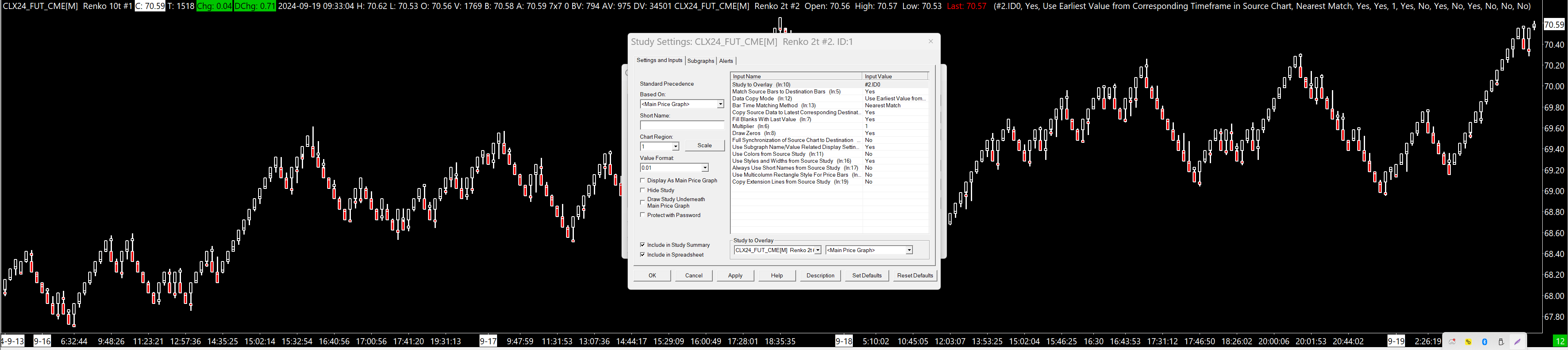

[2024-09-19 07:47:48]
User258227 - Posts: 8
Thank you for your reply.
I have already tried to solve this several times using the study/price overlay, but I can't get it to work.
Attached is a photo of what it looks like for me.
It would be very nice if you could give me the correct settings or attach a chart book with the correct settings.
Thank you very much,
Kind regards,
Stefan
imageoverlay renko 2 auf 10.png / V - Attached On 2024-09-19 07:46:47 UTC - Size: 168.9 KB - 225 views
[2024-09-19 14:31:19]
There is nothing wrong with what you are seeing. From what we can tell, you are overlaying a 2 Tick Renko onto a 10 Tick Renko. Therefore, the system is finding the earliest 2 Tick bar that is closest in time to the 10 tick bar and placing that onto the chart.
The only recommendation we can make to your settings is to change the Input for "Bar Time Matching Method" to "Containing Match". This will then make it that the earliest 2 tick renko bar that is within the range of the 10 tick bar time frame will be displayed.
We are not sure what exactly you are looking for that you state that this is not correct. What exactly are you wanting to do?
