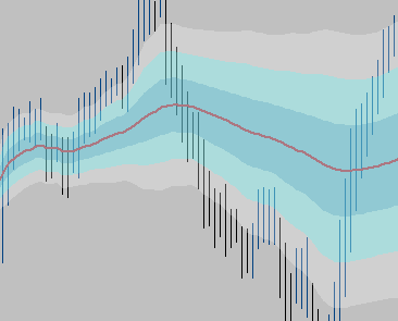

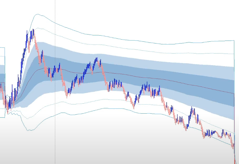

ik its a heikin ashi study, but my candle stick type doesnt look like that. im trying to get mine to look like the "model" file i attached

As far as we can tell, it is just a difference in colors, and possibly the widths of the bars.
To change an Up bar color, you change the color of the "High" subgraph color for the Heikin-Ashi study. And to change the Down bar color, change the "Low" subgraph color for the Heikin-Ashi study.
The above assumes that the option at the top of the Subgraph tab for "Use Chart Graphics Settings for Subgraph Colors" is not checked. If that option is checked then you would need to change the color and widths using the graphics settings noted below for the widths.
To change the widths, you need to change the size for the following graphics settings:
- Bar High-Low Down
- Bar High-Low Up
Refer to the following:
Chart Studies: Subgraphs Tab >> Color
Chart Studies: Subgraphs Tab >> Use Chart Graphics Settings for Subgraph Colors
Graphics Settings: Bar High-Low Down
