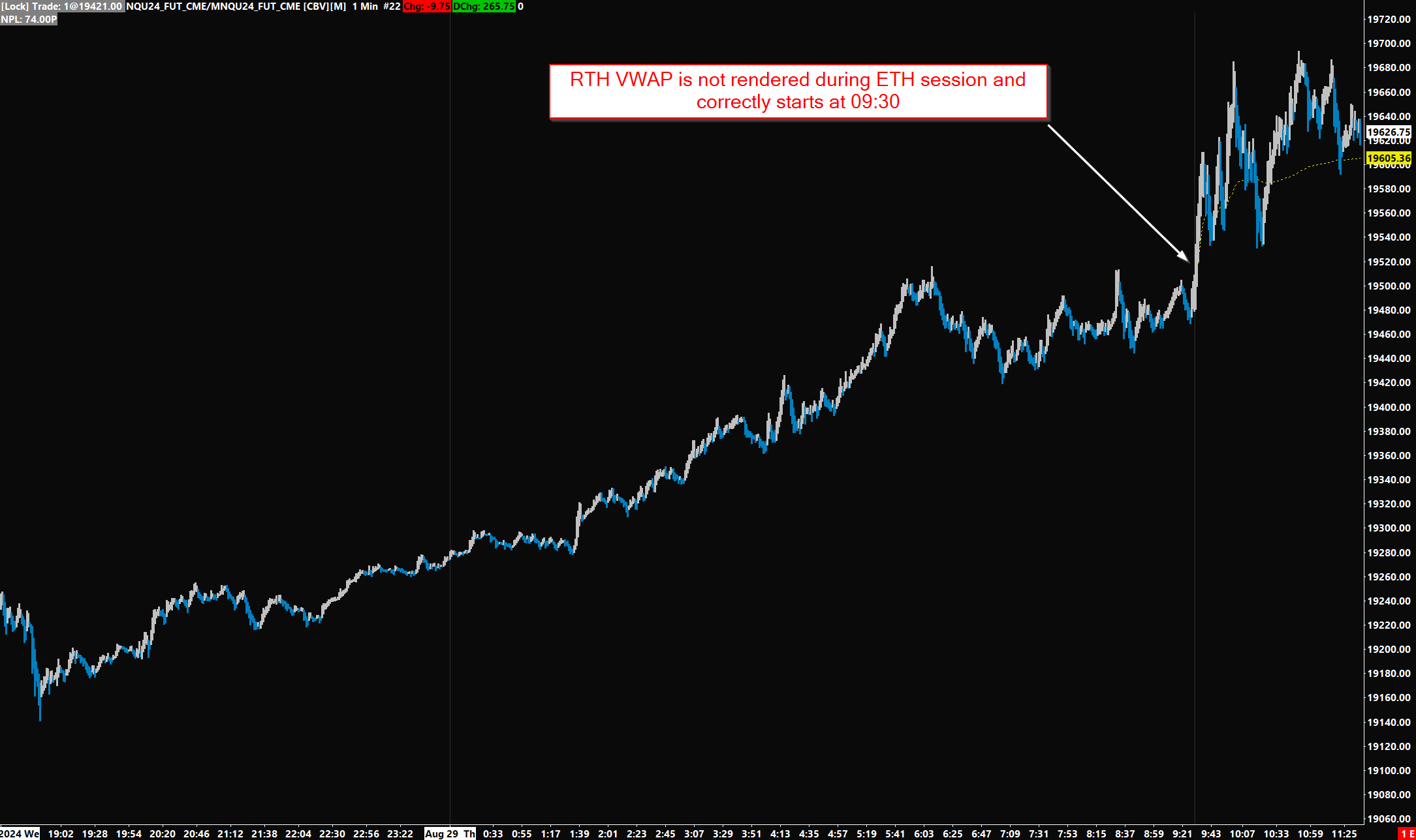

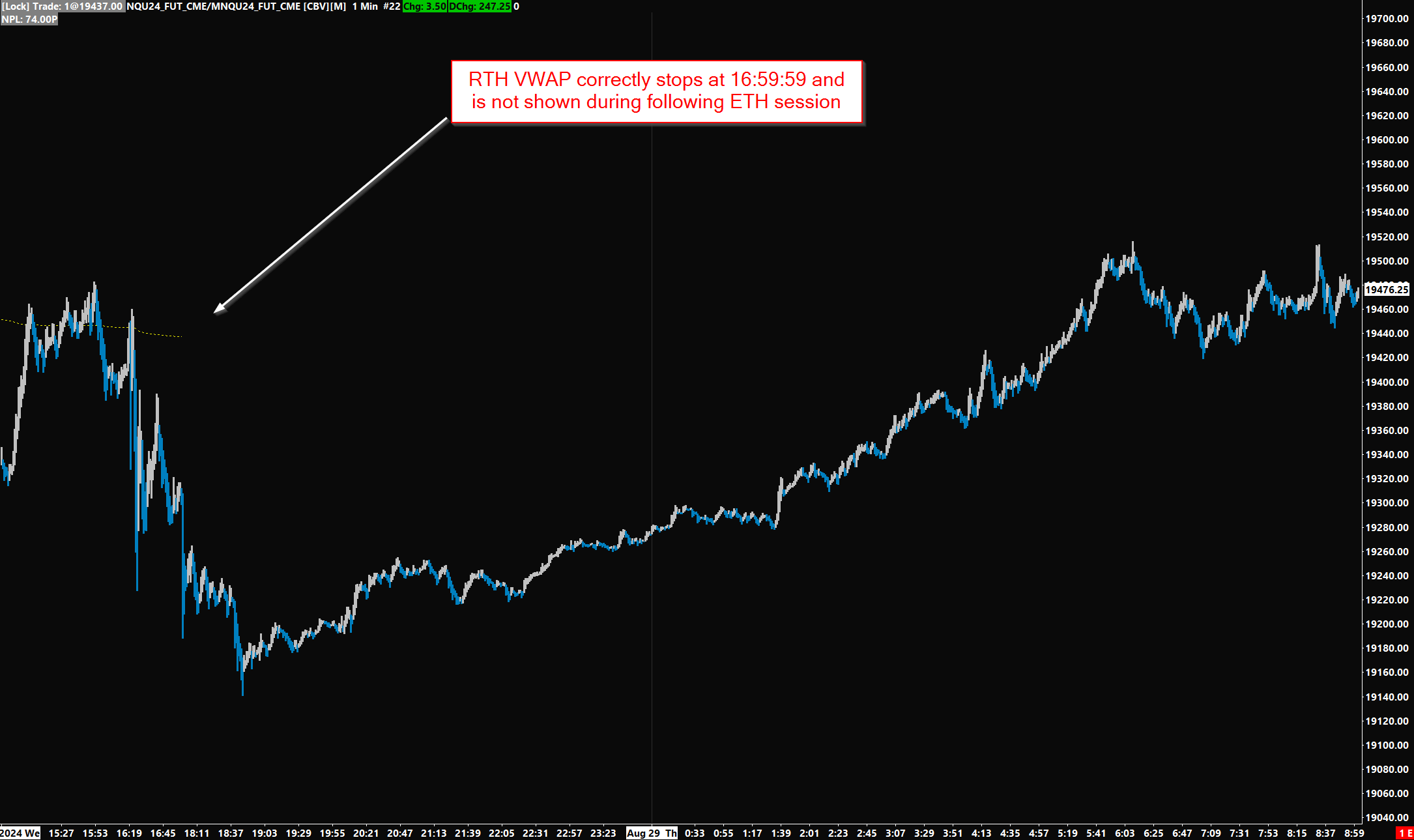

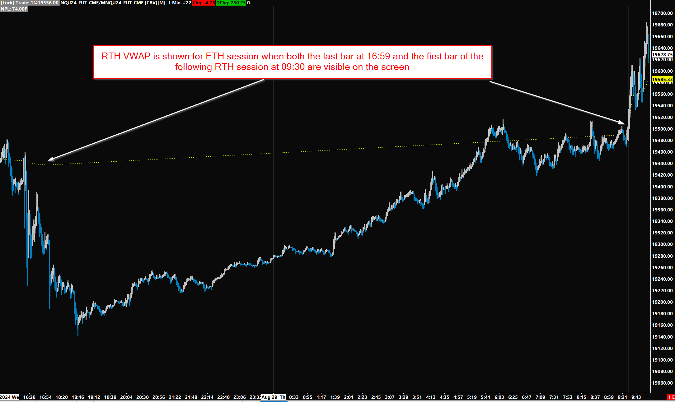

I attached some screenshots to illustrate that (it's a 1 minute chart, but the same occurs on all other timeframes as well):
(i) Screenshot 1: the last bar at 16:59 of the previous day is visible, the first bar at 09:30 of the following day is not. RTH VWAP correctly stops at 16:59 and is not rendered for the following ETH session.
(ii) Screenshot 2: both the last bar at 16:59 and the first bar of the following RTH session at 09:30 are visible - RTH VWAP doesn't stop at 16:59 but is incorrectly continuing during ETH session.
(iii) Screenshot 3: the last bar at 16:59 of the previous day is not visible, the first bar at 09:30 of the following day is. RTH VWAP is not rendered for the ETH session and correctly starts at 09:30.

[2024-08-29 17:46:47]
What you are seeing is actually the correct functioning of the system. The reason for this is that you are using a Line for the Draw Style, so when your chart shows both the end of the VWAP for one day and the start at the next day, it is connecting those two points. To solve this, change the "Draw Style" to "Line - Skip Zeros". Refer to the following:
Chart Studies: Line - Skip Zeros (ACSIL: DRAWSTYLE_LINE_SKIP_ZEROS)
Depending on how you have your Study/Price Overlay setup, you may need to change the Draw Style in the actual VWAP study on the source chart.
