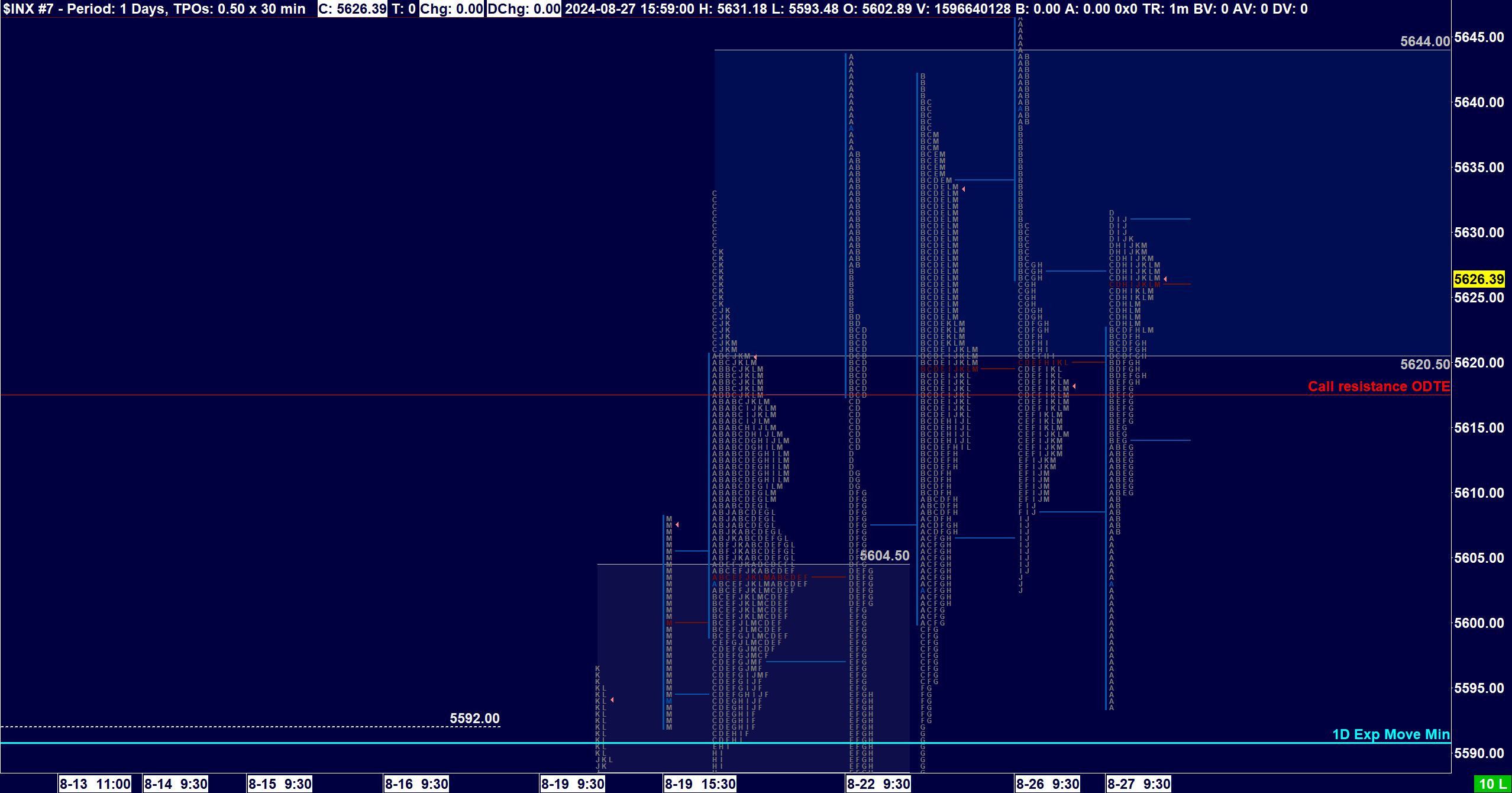

Dear Sierra Chart Support Team,
I am experiencing an issue with Sierra Chart software where it crashes whenever I attempt to exclude a specific day from the chart data for the symbol $INX on the TPO chart. This issue occurred with the previous version of the software and continues to happen even after I updated to the latest version, 2670.
This problem does not occur when I perform the same operation for other symbols, such as ESU24_FUT_CME, which works perfectly fine.
To assist in diagnosing the issue, I have attached a screenshot of the error and the relevant log file.
Could you please provide guidance or a solution to prevent the software from crashing when excluding a day for the $INX symbol on the TPO chart?

Unfortunately, the issue persists, and I'd like to provide some additional details to clarify the problem.
When I have just one $INX chart in a separate chartbook, it works fine. However, as soon as I duplicate this $INX chart into my existing chartbook, which contains 14 other charts for the symbol ESU24_FUT_CME, it works only until I change the Tick Size to 0.25. After changing the Tick Size, the software crashes, even without using the "Dates To Exclude" option.
I have attached the message log file for further analysis. I also utilized the "Send for Analysis" option within Sierra Chart.
Please let me know if you need any further information or if there are additional steps I should follow.

A problem like this must be related to the Chart Tick Size. You need to increase it significantly. Try using 1, 5 or 10. Certainly do not use .01. Refer to:
High CPU Usage | Inactive User Interface | Poor Performance | Long Time to Load Chart Data | Charts Reloading Often: 30.23 - Chart Tick Size and Volume at Price Processing
