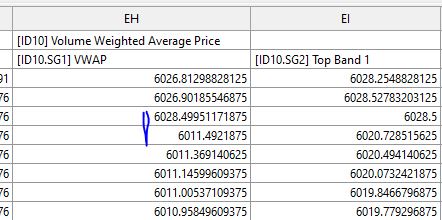

Hi John, seeing an odd behaviour in VWAP Rolling study (ID15) and normal VWAP(ID10). Both the VWAPs are jumping abruptly with a big gap intraday. Whereas the VbP visible Bars(ID17) VWAP is more consistent and smooth and tallies with other chart providers.
Can you pls advice as I was relying on ID10 & ID15 and its trigerring bad signals thru spreadsheet trader.
In the attached file, see how the VWAP jumped from 6011 to 6028 for ES .
The timestamp was 2024-11-13 17:15:00 & 2024-11-13 17:11:48 in Range chart.
Also attached is the chart, where you see the Pink bold line for VWAP coming from VbP (ID17) study which is fine, but I cant get this in the spreadsheet apparently, is there a way ?

We really do not have enough information to say what exactly is occurring, but within the Volume Weighted Average Price study there is an option for "Base on Underlying Data", you should have this set to "Yes", unless there is a specific reason you do not want it to be. Refer to the following:

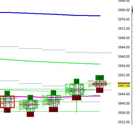

Can you pls confirm if the VWAP & VWAP(Rolling) is based on Tick/Transactions Or discreet Last/OHLC etc candle numbers ? It seems the later , hence am always finding the VWAP from VbP study always different from the standard VWAP indicators (attached see the diff between the Blue line on standard VWAP vs Pink based on VbP ). The Pink VWAP from VbP studies seems to be more accurate in reflecting all transactions. But it changes as I scale the chart including ore/less bars and I need a consistent VWAP to refer from the spreadsheet trading. The Blue one (standard VWAP with setting of Underlying Data set to Yes) is definitely not correct ti seems.

It depends on the setting for "Base on Underlying Data". If this is set to "No", then the study uses the Last price for each bar along with the bar Volume. If this is set to "Yes", then it is using the per tick information. When this option is set to "Yes", then you will get the exact same VWAP between the Volume Weighted Average Price and the Volume by Price study, as long as the periods are set to be the same.

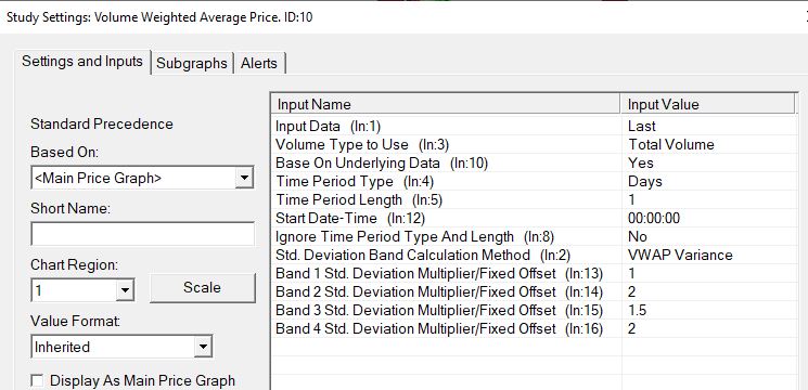

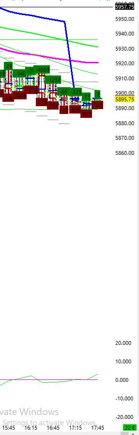

That is clearly not happening. see the attached screenshot, the Blue (normal)VWAP abruptly drops, pls find the setting am using.
The Pink VWAP(from VbP) aligns with the external provider like TradingView, if I show only the current day's bars.
I have tried changing the 'Input' setting for the VWAP from Last to OHLC avg etc, it doesn't change much.
The attached screenshot shows the time too, its London timezone for ES.
Date Time Of Last Edit: 2024-11-15 17:51:21
imageVWAP Discrepancy2.JPG / V - Attached On 2024-11-15 17:49:25 UTC - Size: 33.81 KB - 301 views
imageVWAP setting.JPG / V - Attached On 2024-11-15 17:49:30 UTC - Size: 60.46 KB - 387 views

There is something in your setup between those two studies that is making them different.
Please get us a chart that has just those two studies on it so we can see how you have them setup. Refer to the following:
Just so you are aware, we did test this after your first post and before we responded to ensure that there were no changes that would cause a difference. We get the exact same VWAP with both studies. But again, they have to be setup to start at the same point in time.
