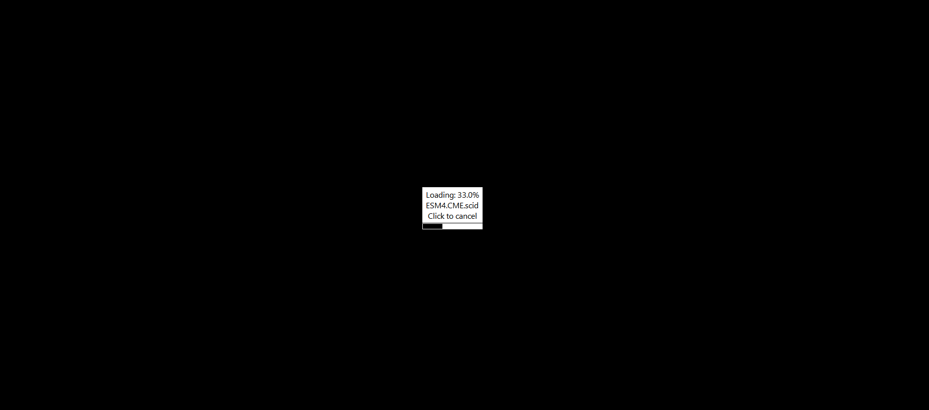

[2024-08-21 17:49:46]
User787249 - Posts: 20
What could be the reason that my chart book for ES loads the entire data after a short disconnect and the CL chart book only the small data delta from the disconnection?
Thanks;
imagefull.png / V - Attached On 2024-08-21 17:49:19 UTC - Size: 10.55 KB - 221 views
imageno_full.png / V - Attached On 2024-08-21 17:49:39 UTC - Size: 10.18 KB - 289 views
[2024-08-21 19:58:02]
That loading you see is just loading from a local data file. To improve the loading performance:
Changing Chart Bars Period: Improving Performance of Loading Chart Data

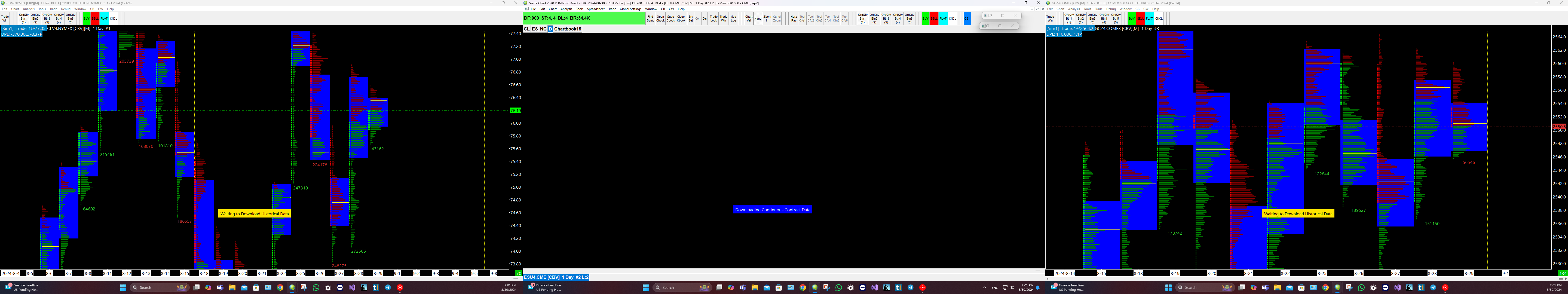

I have attached a new image that may explain the issue better.
3 products CL, ES, GC ( all copy charts from CL just change the symbol later to ES & GC, didn't change and chart properties )
Why ES symbol decide to fully upload from disk when CL & GC were satisfied to append the missing data without disk upload.
Thanks;
imageScreenshot 2024-08-30 140150.png / V - Attached On 2024-08-30 18:21:27 UTC - Size: 362.29 KB - 258 views
[2024-08-30 19:13:00]
If you had changed the symbol for that chart, then the system needs to download the data for that chart. Also, even if you had other ES charts open previously, this one is a Continuous Futures Contract chart, so it may have needed additional data that you did not already have on your system.

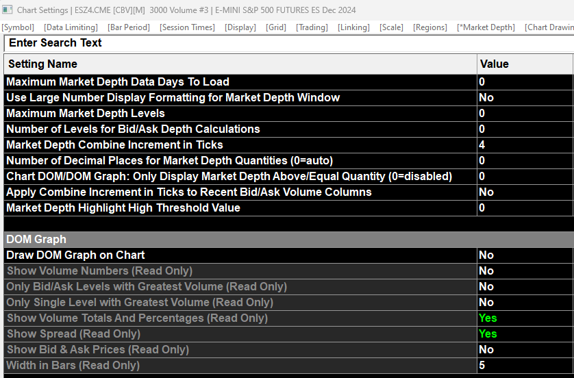

This is my current setting but ES continues to download depth data - img attached
imagesetting.png / V - Attached On 2024-09-18 15:02:17 UTC - Size: 57.41 KB - 175 views
[2024-09-18 17:09:30]
The settings you show have nothing to do with whether Market Depth data is going to be downloaded or not. The setting that is important is the following:
Global Settings >> Sierra Chart Server Settings >> General >> Support Downloading Historical Market Depth Data
Which needs to be set to "No". If you have changed this, then you need to reconnect to the data feed (having restarted Sierra Chart will also take care of this).
