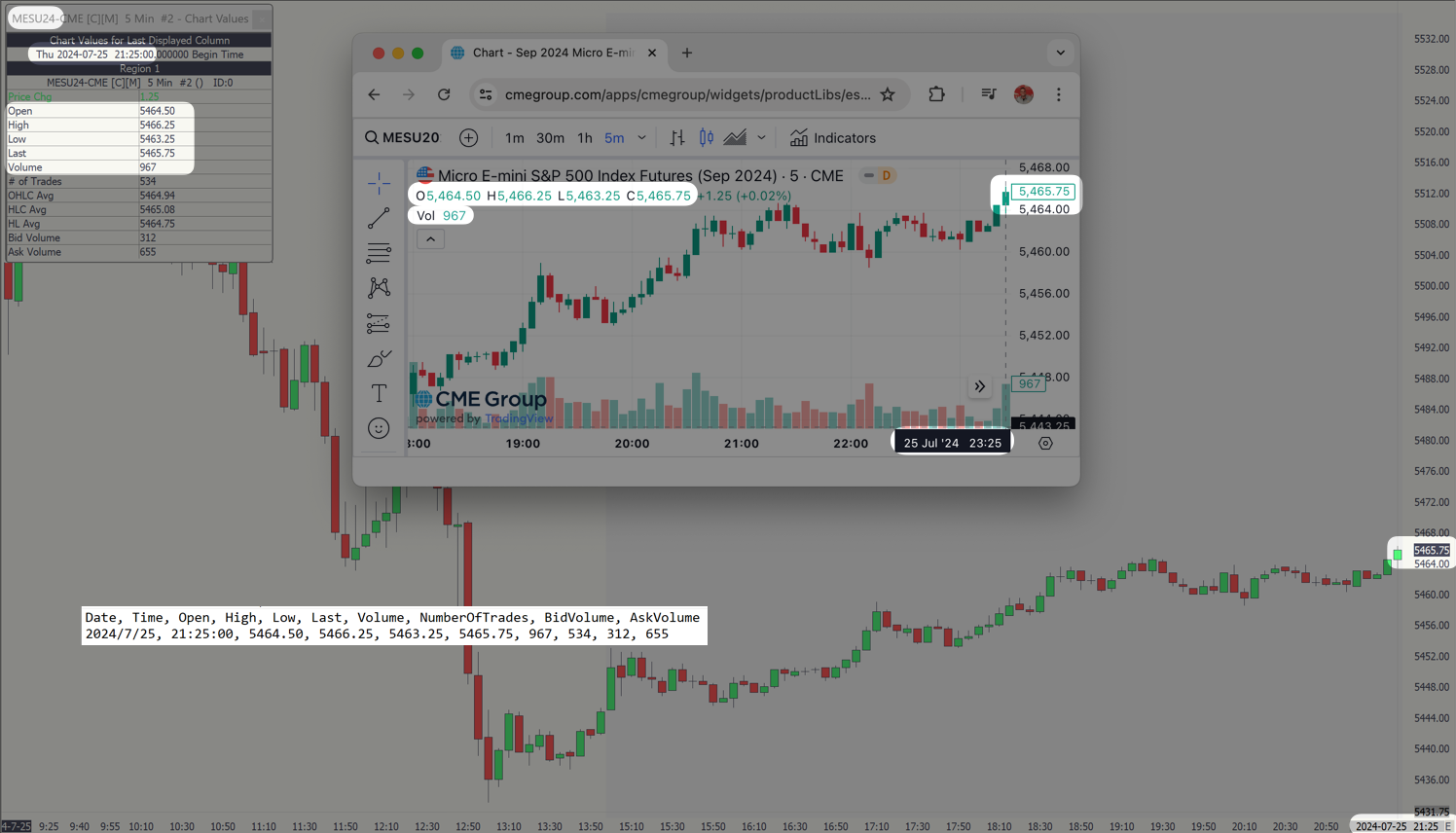

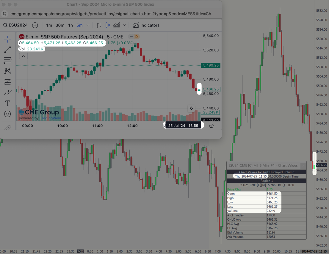

seandunaway - Posts: 399
denali's data aligns to the tick perfectly with cmegroup's own chart data from their website.. i used your screenshot's bar as an example, attached.
imagedenali vs cme.png / V - Attached On 2024-07-27 15:05:56 UTC - Size: 293.34 KB - 290 views

[2024-07-27 16:52:51]
matches cme data, attached.
Date Time Of Last Edit: 2024-07-27 17:00:28
imagedenali vs cme mes 2.png / V - Attached On 2024-07-27 16:52:36 UTC - Size: 360.22 KB - 198 views
separately, @scengineering, do you have an https://en.wikipedia.org/wiki/Off-by-one_error when accumulating ticks to time bars?
my time resolution data
Date, Time, Open, High, Low, Last, Volume, NumberOfTrades, BidVolume, AskVolume
2024/7/25, 21:25:00, 5464.50, 5466.25, 5463.25, 5465.75, 967, 534, 312, 655
@user431178's presumably tick resolution data
Date, Time, Open, High, Low, Last, Volume, BidVolume, AskVolume
2024/7/26, 04:25:00, 5464.50, 5466.25, 5463.25, 5465.75, 968, 313, 655,
one extra trade at the bid has snuck into their export, when compared to cme
Date Time Of Last Edit: 2024-07-27 17:40:18
