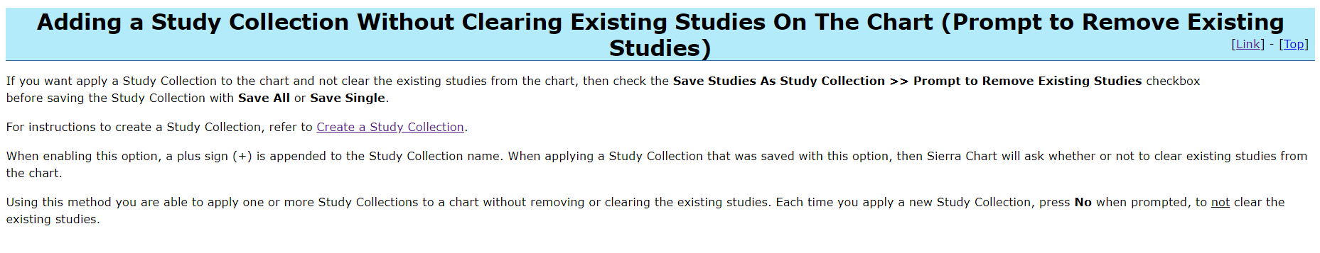

SafSaf - Posts: 160
unless i'm going mad.... please read your instructions in the attached and compare them to your advice above... they seem to contradict one another... you're saying to uncheck the plus sign, which sounds logical, but the attachment says to check it. it states it on the first line
imageScreenshot 2024-06-07 110447.png / V - Attached On 2024-06-07 15:07:12 UTC - Size: 57.99 KB - 281 views
[2024-06-07 17:05:28]
There is not a conflict. We just pointed you to the information on why you were being prompted to remove the studies.
If you do not get prompted to remove the studies, then the other studies will be removed. The only other option is to be prompted on whether you want to remove other studies or not by having a '+' sign at the end of the Study Collection name.
There is not a third option where the Study Collection is added to the existing studies without being prompted.
