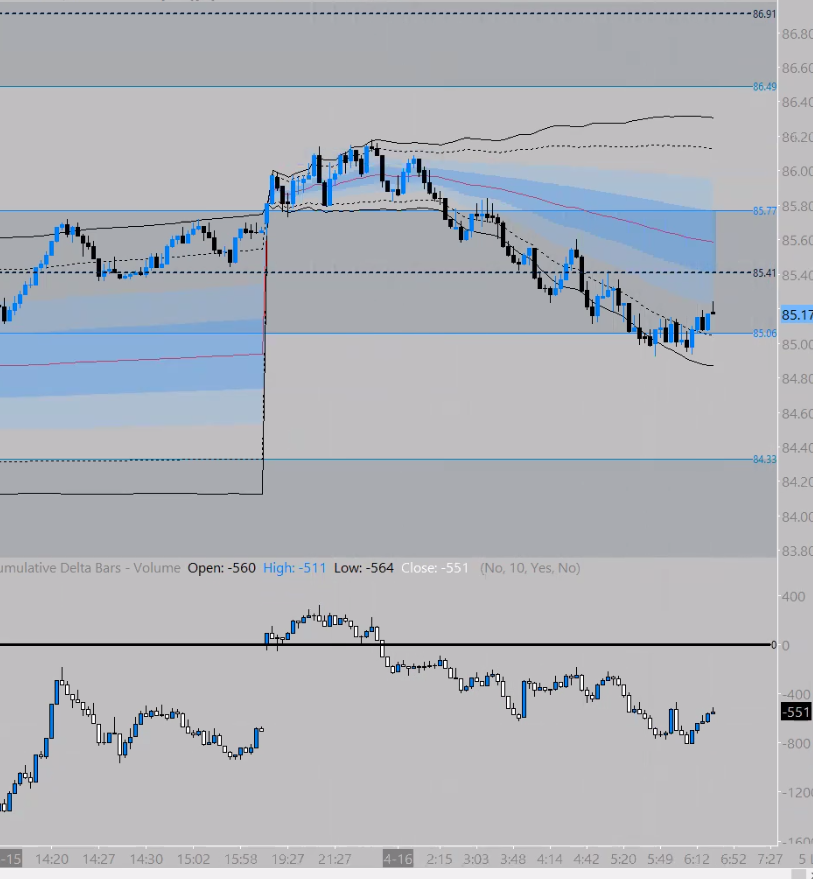

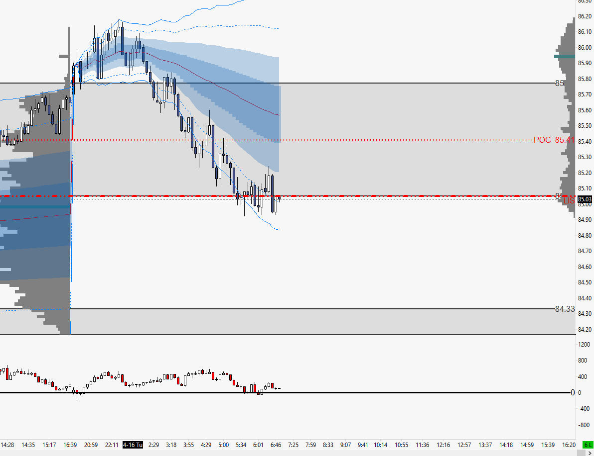

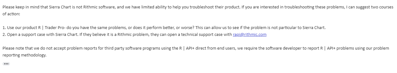

so I compared my Cumulative Delta Bars table with other traders and everyone sees identical market orders movements but for me it looks different (you can see two screenshots and the Delta bars chart at the bottom). I thought it may be a rhithmic problem and I wrote an email for them but it looks like they have no idea what to do so I wanted to ask Sierra support. I have also added a screenshot about what they advised me to do.
Best regards, Mantas.

[2024-04-17 16:22:10]
First, use the Denali Data Feed:
Denali Exchange Data Feed
This is mandatory.
Set Sierra Chart to a Tick by Tick Data Configuration. Follow the instructions here to do this:
When posting an image of a chart only use the method documented here:
