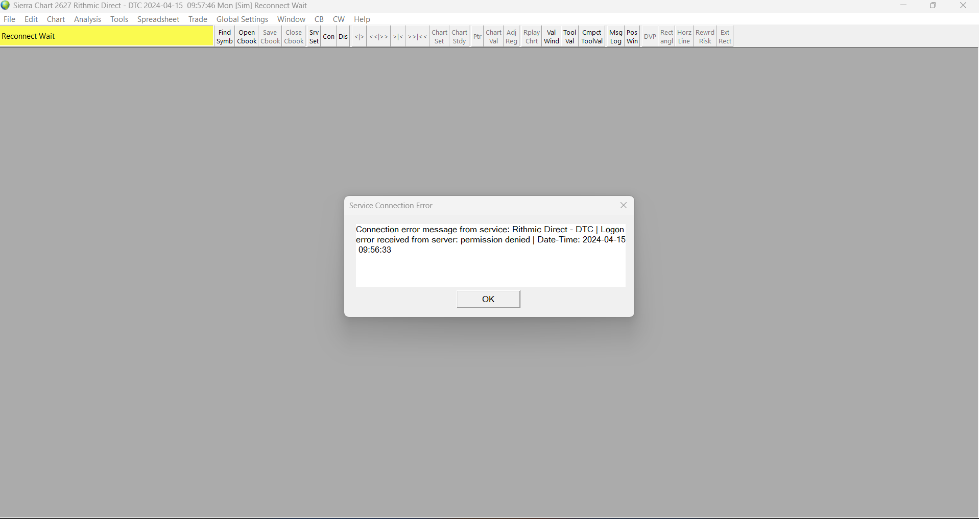

Tomas Herka - Posts: 5
Hello SC,
I have an issue with conecting into Apex /Rithmic. I have correct username and password from Rithmic but wehenever I try to connect to Sierra chart there is pop of error. I gave my username and password to my friend to try and he has no issue to connect his Sierra chart. Any idea where could be possible problem? Thank you very much.
imageissue.png / V - Attached On 2024-04-15 13:58:30 UTC - Size: 50.81 KB - 178 views
[2024-04-15 17:10:34]
Refer to the following:
Rithmic Trading Platform Service: Permission Denied Resolution Procedure
