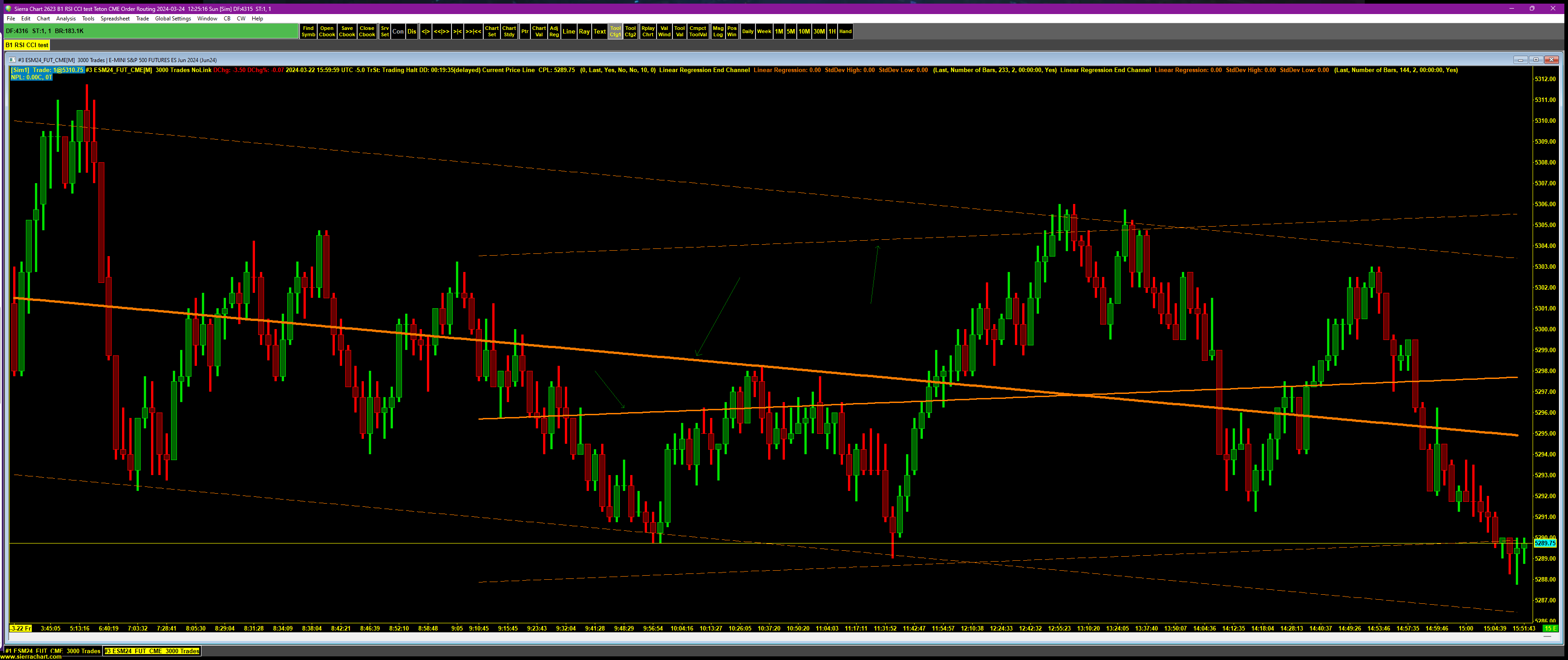

Rui S I hope this upload will illustrate my case Be so kind and let me know how it compares to your charts Thank you very much again https://www.sierrachart.com/image.php?Image=1711301118291.png |

I hope this upload will illustrate my case Be so kind and let me know how it compares to your charts Thank you very much again https://www.sierrachart.com/image.php?Image=1711301118291.png Ok, I see what you mean now. I'm so used to it that I don't even notice it anymore. You are right, when drawing lines other than horizontal or vertical, SC does that. With the higher graphical definition you are using it must be much more noticeable. What I usually do as a turnaround to minimize that effect is using dotted lines or even just a dot per candle depending on the case. I hope you can find the best solution to serve your purpose. |

Graphics rendering is performed by the operating system not Sierra Chart: On visual side of SC I am experiencing a bit of discomfort
If you do not notice this with other programs it is because they must be using some visual effect to make it not noticeable to the eye. It is not possible to eliminate this. There is a technique which is used to make it not noticeable. Even though it is actually still there.
Most of studies/drawings seem very much to appear as "lower resolution" (they are very tooth edgy) The same showed up when I switched to OpenGL with additional misaligning and different shapes (OpenGL is now off) My video cards are high end Sapphire Nitro+ (AMD); 12 Gb ; monitors are perfect ones (Asus 34" 2k) Sierra Chart Support - Engineering Level Your definitive source for support. Other responses are from users. Try to keep your questions brief and to the point. Be aware of support policy: https://www.sierrachart.com/index.php?l=PostingInformation.php#GeneralInformation For the most reliable, advanced, and zero cost futures order routing, use the Teton service: Sierra Chart Teton Futures Order Routing Date Time Of Last Edit: 2024-03-25 17:53:46
