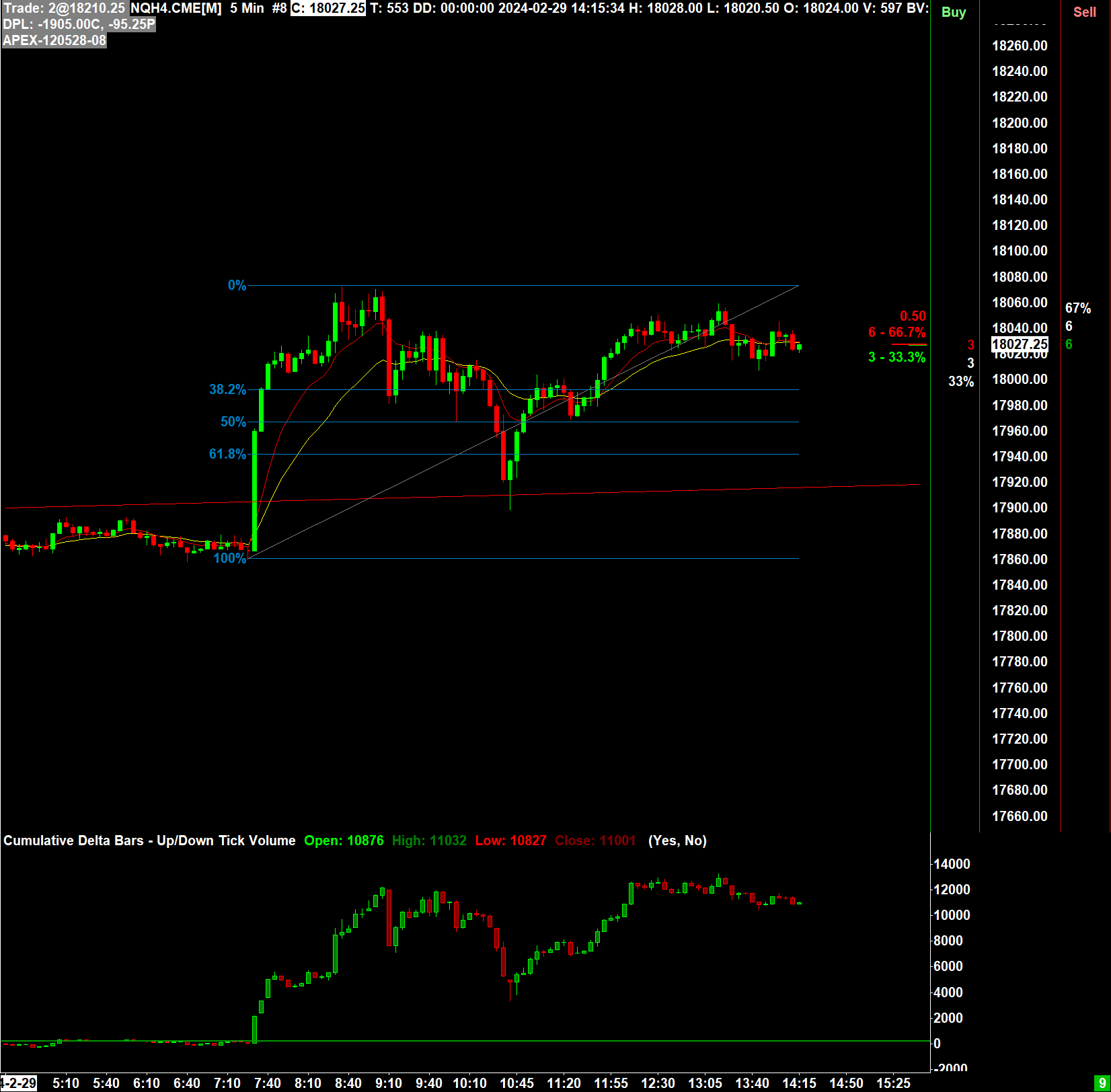

| User463335 - Posts: 14 |
https://www.sierrachart.com/image.php?Image=1709231627410.png Hello John, pls find the link, let me know if you can get the link correctly. By the way, the data is live as of now.. this happens in between especially during the initial peak hours market hours. Do let me know how we can fix this issue. Best Regards Saju |

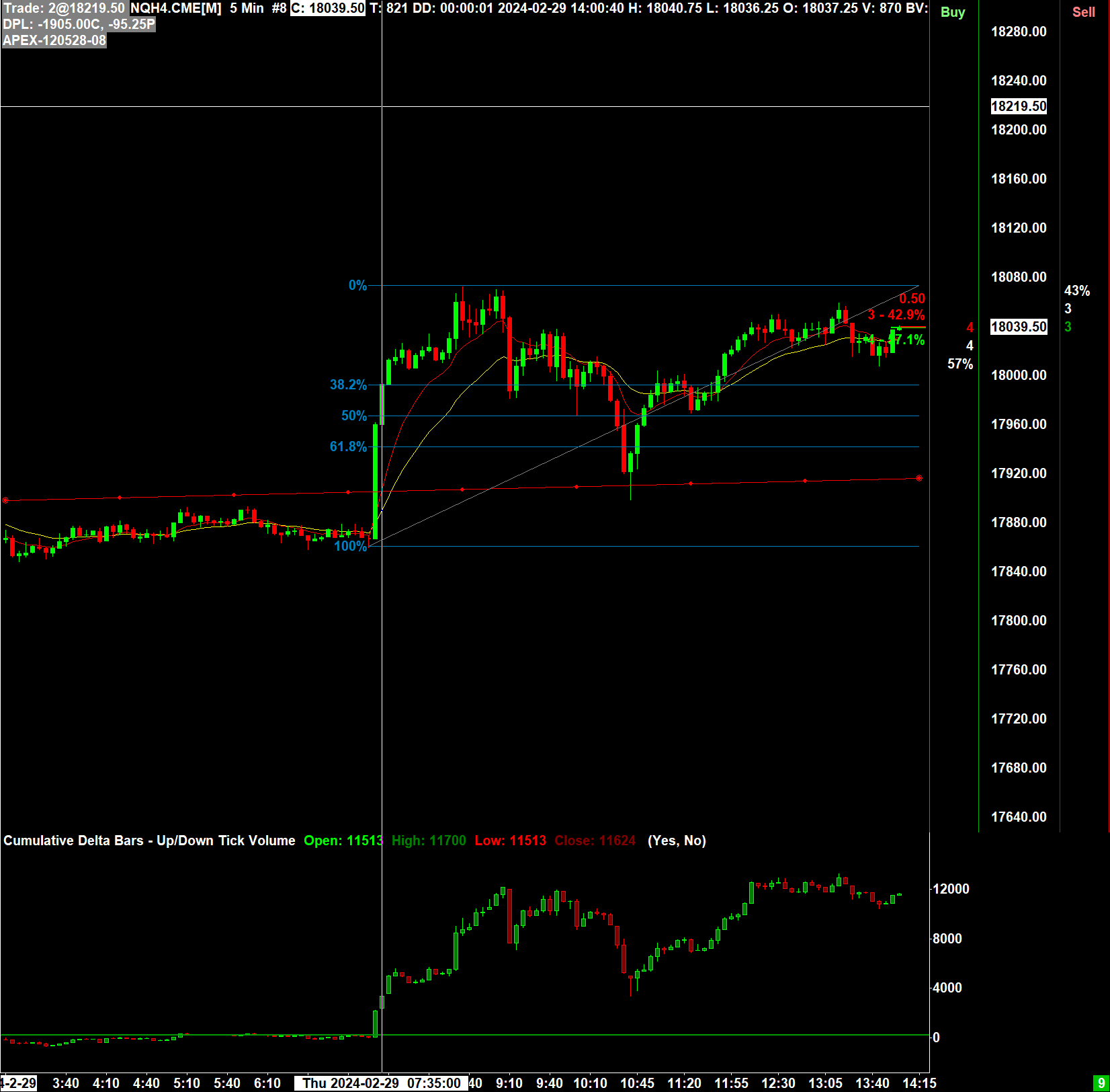

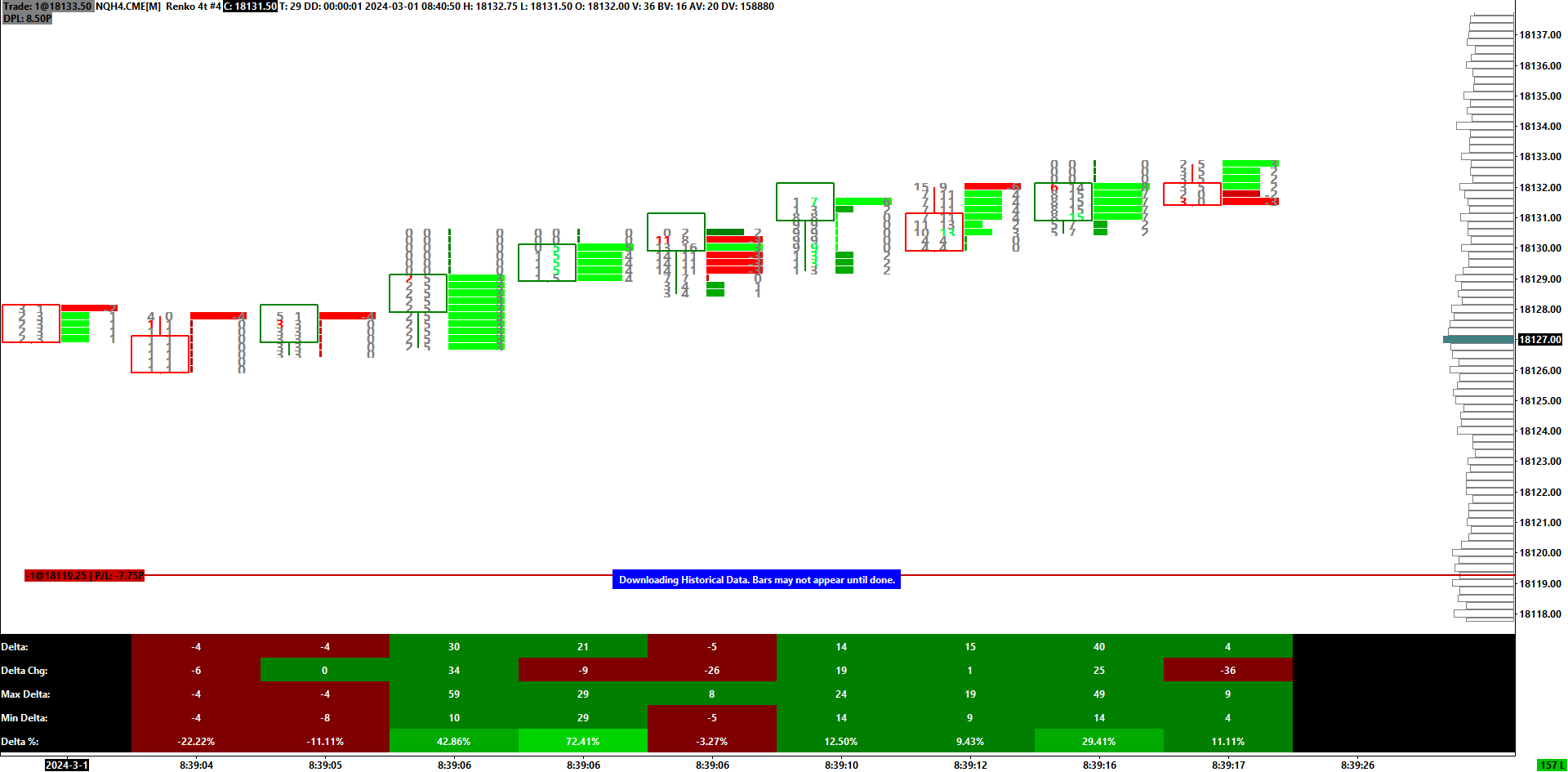

Hello john, Just not it was delayed to 002..., hopefully, its captured in this image https://www.sierrachart.com/image.php?Image=1709236435716.png It happens during the opening hour and now which is the closing hour when there is trading volume volatility... Hopefully, you can find and resolve it.. |

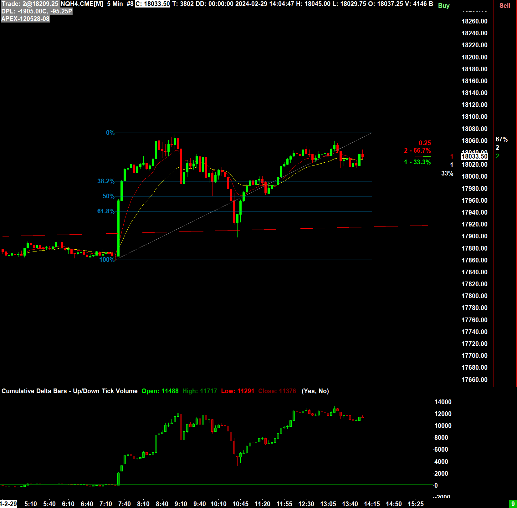

I mean Just now.. https://www.sierrachart.com/image.php?Image=1709236843889.png -- this image should show 00:00:02 https://www.sierrachart.com/image.php?Image=17092370926.png you can check all three images.. Hello john, Just not it was delayed to 002..., hopefully, its captured in this image https://www.sierrachart.com/image.php?Image=1709236435716.png It happens during the opening hour and now which is the closing hour when there is trading volume volatility... Hopefully, you can find and resolve it.. |

| John - SC Support - Posts: 47889 |
The DD: at the top is showing 00:00:00. How do you know there is a 10 second delay?

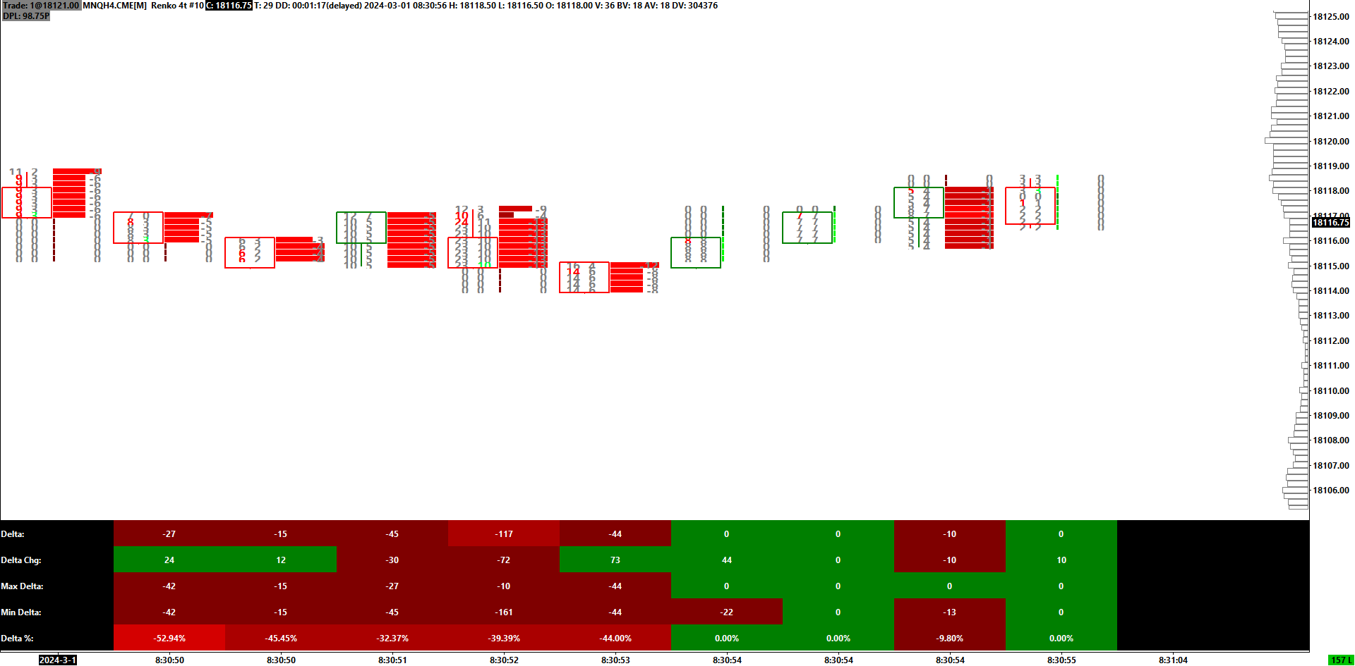

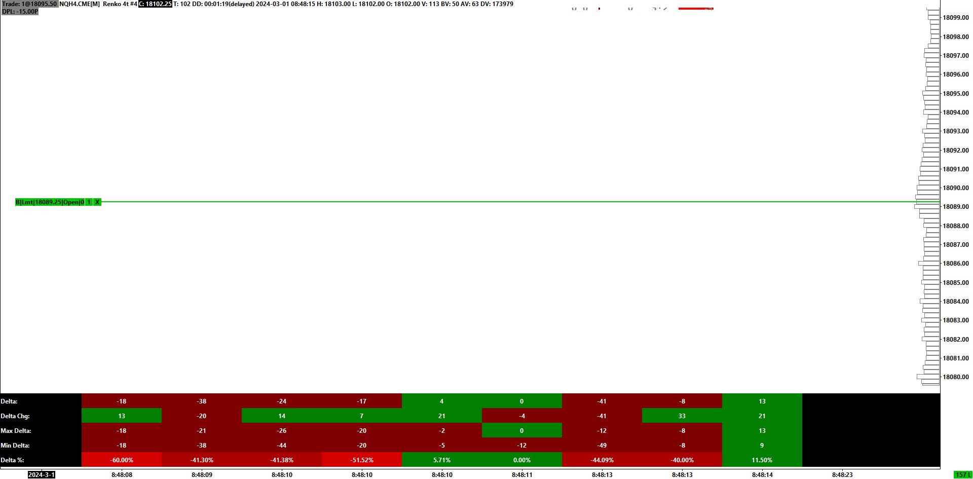

Hello John Attaching a few links showing the delay...maybe It's not getting correctly captured https://www.sierrachart.com/image.php?Image=1709304057438.png https://www.sierrachart.com/image.php?Image=1709303499351.png https://www.sierrachart.com/image.php?Image=1709303538722.png reading at @ 00.00.52 Please advise if we have any solutions.. Best Regards Saju |

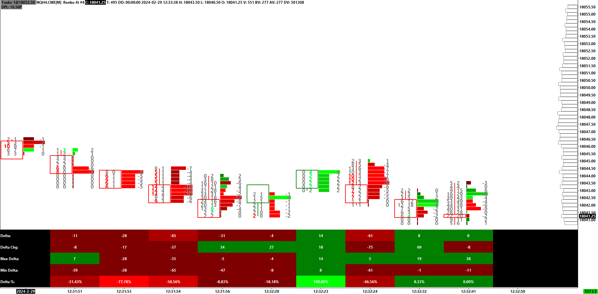

John, delay of a Minute.. https://www.sierrachart.com/image.php?Image=1709304578978.png |
