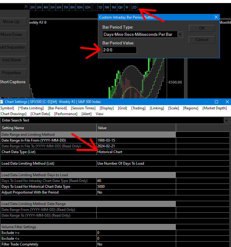

Is there any way to add a shortcut to the control bar for alternate daily historical data bar periods?
When I use the custom bar period set to two or four days, it switches the chart to intraday data. There are no historical custom daily chart period options available.

No, that is not the case. The charts are all historical charts set to Daily/Weekly/Monthly.
When I try to use the custom bar period to make custom daily timeframes... 2 Day, 4 Day, etc... It switches it to intraday.
See attached.
imageattache.png / V - Attached On 2024-02-21 17:19:46 UTC - Size: 43.33 KB - 204 views

esMike - Posts: 83
The problem might be that there is no shortcut option for custom daily historical bars? Only monthly bars?
See attached.
Date Time Of Last Edit: 2024-02-21 17:35:20
imagetheProblem.png / V - Attached On 2024-02-21 17:34:41 UTC - Size: 19.46 KB - 291 views
[2024-02-21 18:37:57]
You are correct, the issue is that the "Custom Bar Period" control bar buttons are set for the Intraday bar periods. There is not an option to create a "Custom Bar Period" control bar button for historical time periods.

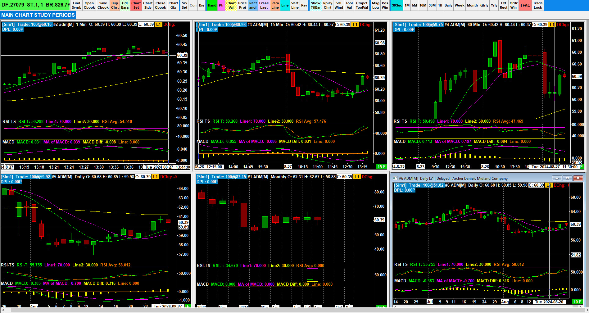

I would like to see a month with about 30 bars or a year chart with about 80 bars. The other important setting should be the chart title which should reflect the Chart Bar Period Type chosen from the settings. If I choose a month it should say Monthly or Yearly. I know I can create a daily chart and scale it to be a month. I created a grid of 6 charts and each chart represents a time period. I use it to study the stock at a glance at different time periods. Thank you.
imagesierra chart time studies.jpg / V - Attached On 2024-08-28 23:08:19 UTC - Size: 802.16 KB - 223 views
[2024-08-29 13:24:02]
A month with 30 bars means 1 day per bar and a year with 80 bars would 4 days per bar (giving ~90 bars). To do each of these follow these instructions:
- 1 Month:
-- Set "Chart >> Chart Settings >> Data Limiting >> Chart Data Type" to "Historical Chart". Select the "A" button to the right of the entry after selecting this to update the window after making this selection.
-- Set "Chart >> Chart Settings >> Data Limiting >> Days to Load for Historical Chart Type: to be at least "30"
-- Set "Chart >> Chart Settings >> Bar Period >> Historical Chart Bar Period Type" to be "Days".
-- Set "Chart >> Chart Settings >> Bar Period >> Historical Chart Days Per Bar" to be "1".
Do the same as above for another chart to get 1 year by setting the number of days to load to be at least 365 and then set the "Historical Chart Days Per Bar" to be "4".
Since you are wanting header information that is different from what is displayed (i.e. you want it to state "Month" for a months worth of data, not a month per bar), you would need to add text to each chart to get this. You can do this by using the Drawing Tool for "Stationary Text". Refer to the following:
Chart Drawing Tools: Type Text | Stationary Text
