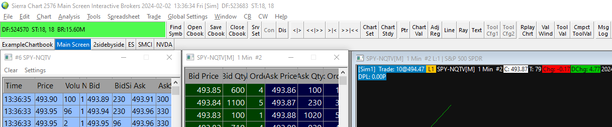

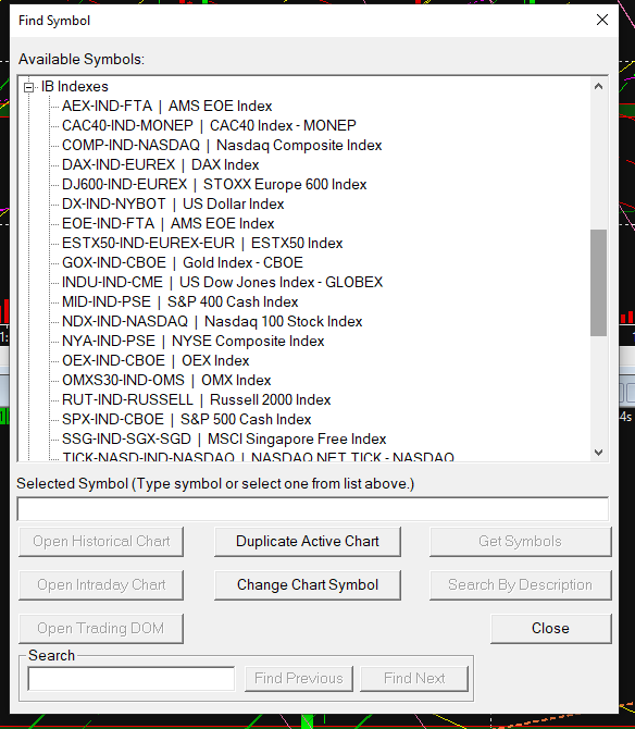

shajee08 - Posts: 11
I don't see SPY on the list of IB indexes. Only SPX and it isn't loading any data. However, I am currently connected using IBKR data and it seems like the delayed notification is gone and the SPY-NQTV is displaying live data.
Is it possible that my Sierra Nasdaq total view is pulling inconjuction with my IBKR CME data? All data is working as I type this but looking for you to confirm so that I know what I need to have subscribed to going forward for next month. Thankyou
imageCapture3.PNG / V - Attached On 2024-02-02 19:42:19 UTC - Size: 39.31 KB - 227 views
imageCapture2.PNG / V - Attached On 2024-02-02 19:42:25 UTC - Size: 43.78 KB - 210 views
[2024-02-02 22:31:29]
John - SC Support - Posts: 47955
SPY is not an index, it is an equity. So it would get pulled up like any other equity and not like an index.
Right now, you have the "NASDAQ TotalView" exchange active with us. Therefore, any U.S. Equity for which you add the suffix of -NQTV will come from our Denali Exchange Data Feed. Any other data would be coming from Interactive Brokers.
