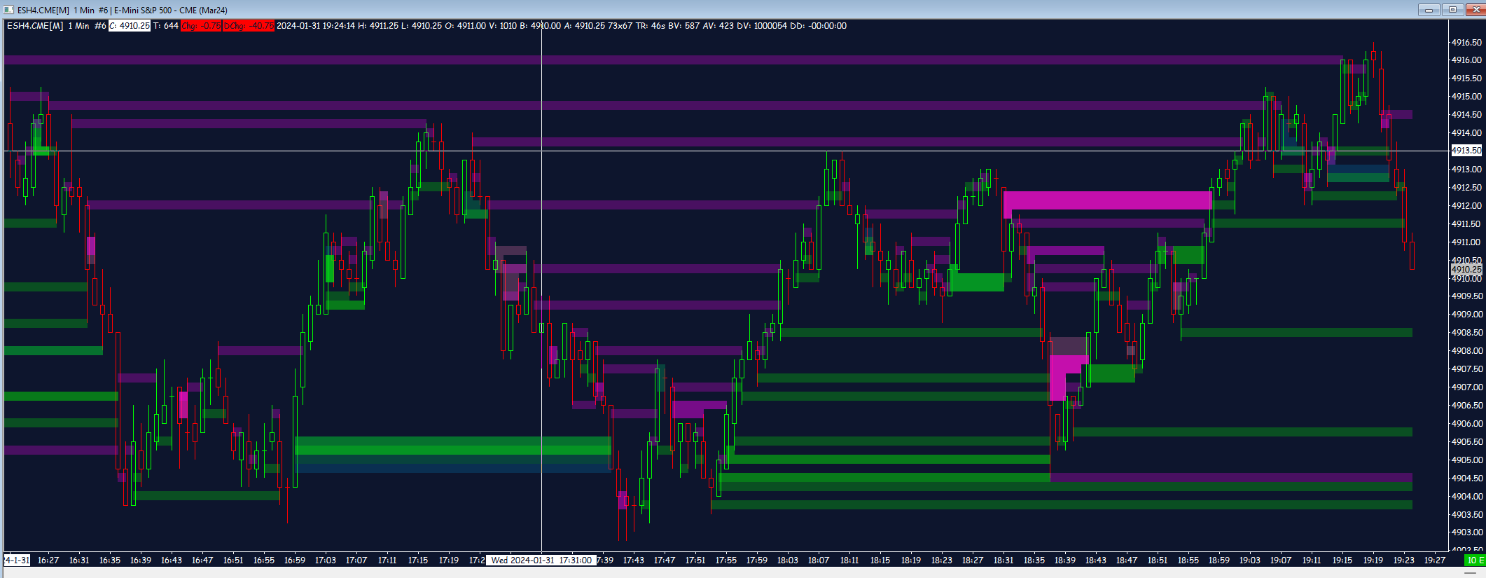

Thank you! I gave an example of 10 columns, but I've much more. So MINZ is the solution. Can I please ask another question. I want to reference all untouched Stacked Imbalances which are IDxx.SG60 under "Volumes at Price Threshold Alert 2", but SG60 doesn't return anything on the spreadsheet. Any clue how to get these fresh Imbalances into a Spreadsheet? Thanks

Looks like this subgraph is normally set to "Subgraph Name And Value Labels Only" which is not plotting any values.
Chart Studies: Subgraph Name and Value Labels Only (ACSIL: DRAWSTYLE_SUBGRAPH_NAME_AND_VALUE_LABELS_ONLY)
I don't fully understand what you try to do, but maybe setting this to a Line will give you it's value.

Usually, these imbalances zones are revisited, so they can serve as either Support/Resistance or Profit Target/Stop Loss, etc. What I'm trying to do is to get these levels on a spreadsheet.

But when looking up the default setting for SG60 on the "Volumes at Price Threshold Alert V2" I found that its default draw type is not set to a type which gives a value.
Did you try setting it to "Line"? Did that give you a value on your Spreadsheet?
[2024-01-31 21:02:48]
User347921 - Posts: 39
It is by default set to line and it doesn't show price levels in the spreadsheet. Thank you anyway.
Prices of line extensions within a bar are not available in a spreadsheet.
Volume at price within a bar is available when (ln:53) is set to Yes, in the spreadsheet study settings.
However, volume at price is listed horizontally, beginning in column BA and to the right.
This setting disallows any other study's output in columns BA and to the right.
This might not be useful because it would be difficult to access it with a formula.
