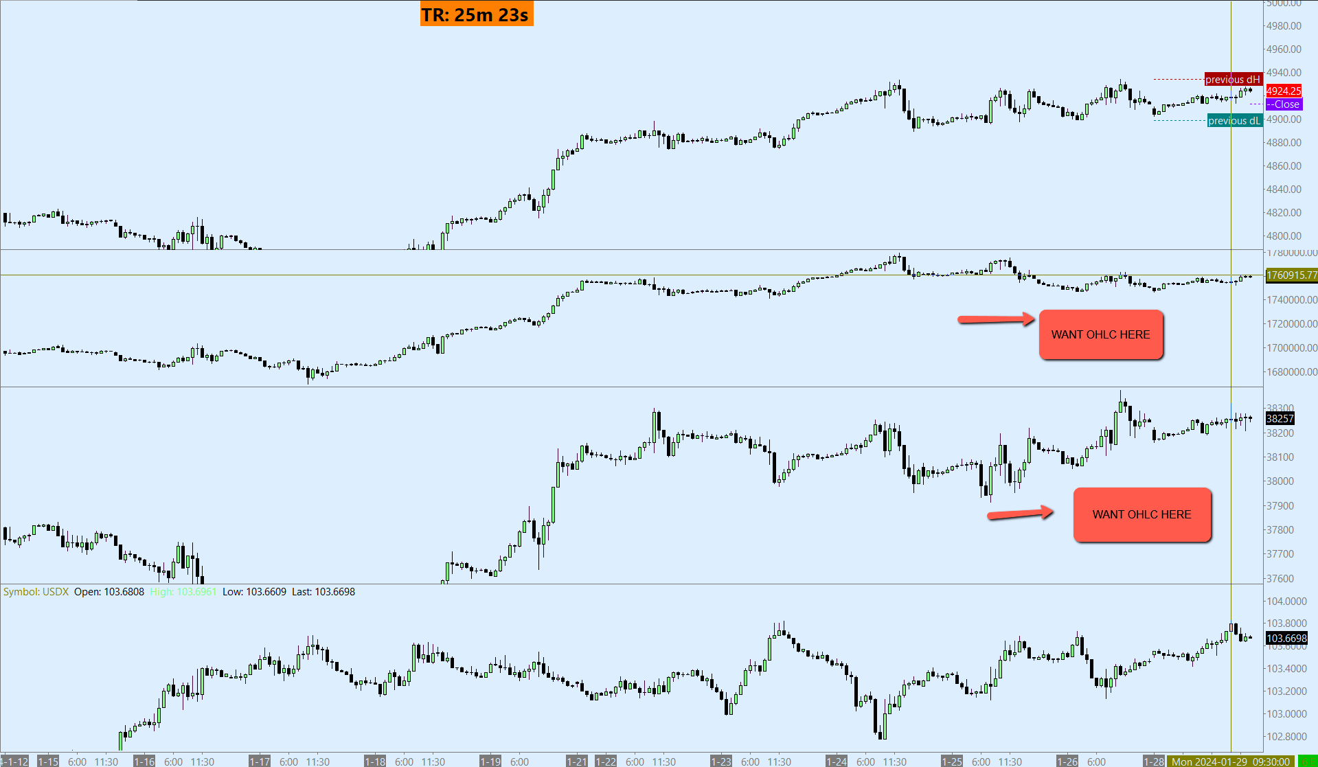

I have problem applying OHLC study on the addtiional symbol charts added to a chart. Please find the attached picture for reference.

You can definitely do this. Just make sure the OHLC study you are using has the "Based On" set to the "Add Additional Symbol" study and that you put it in the same region. Refer to the following:
Chart Studies: Settings and Inputs Tab >> Based On - Basing a Study on Another Study
Chart Studies: Settings and Inputs Tab >> Chart Region

The issue is that your OHLC studies are driving the scaling, and the Scale Setting for that study is "Same as Region", which means that you can not change the scale settings.
All you need to do is to move the "Add Additional Symbol" studies to the top of the list of studies, in particular they need to be above the OHLC studies. Then you will be able to adjust the scaling.
