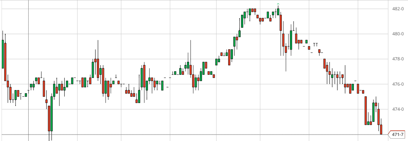

For some reason the 2024 Dec Corn chart is not charting correctly. Showing an almost .30 candle today, that is not accurate, https://www.sierrachart.com/image.php?Image=1706541312376.png
[2024-01-29 15:26:49]
User841161 - Posts: 348
Chart Should look like this.
imageDecCorn24.PNG / V - Attached On 2024-01-29 15:26:39 UTC - Size: 47.1 KB - 188 views

You are trying to use a Continuous Futures Contract chart but with a contract further out in the future than the current front contract. This will not work. You would need to either set the "Continuous Futures Contract" option to "None", or change the symbol to ZCH24_FUT_CME.
[2024-01-30 20:31:35]
k, thanks. I had duplicated a continuous front month chart, and just changed the symbol. I didn't realize you couldn't do a continuous further out month.
