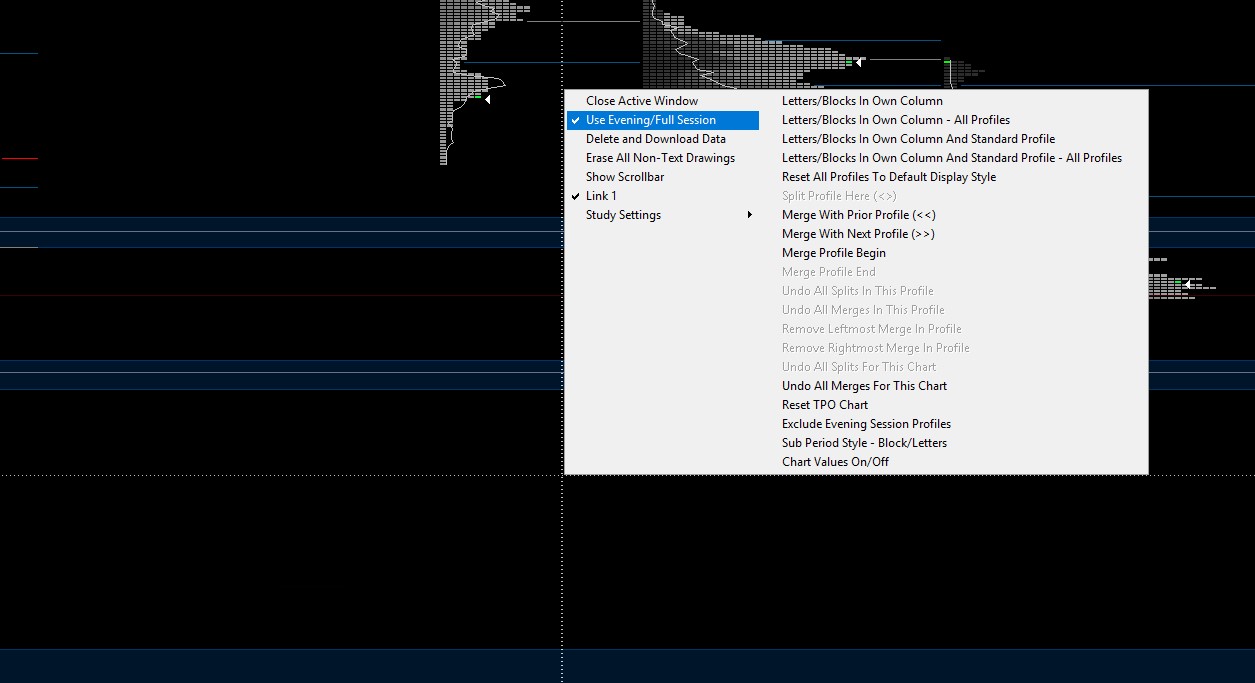

[2024-01-29 05:20:18]
mmalgo - Posts: 6
Hello John!
I have two instances of Sierrachart running on my VPS. In the second instance i have a chart group where i have different TPO studies. I want the TPO studies to use "use evening/full session" by default. I switch to this session, save it. But the next time i open Sierrachart it opens the chart without the evening/full session. Where can i save my choice so that it opens the next time with the evening/full session?
Thank you
Best
Michael
imagesierrachart.jpg / V - Attached On 2024-01-29 05:19:39 UTC - Size: 104.48 KB - 159 views
[2024-01-29 18:12:54]
John - SC Support - Posts: 47955
The system will save the state of that chart as you saved it, so if you had the option to "Exclude Evening Session Profiles" disabled, then it will be disabled when you open the chart again.
Are you not saving the chart with the TPO profile study on the chart?

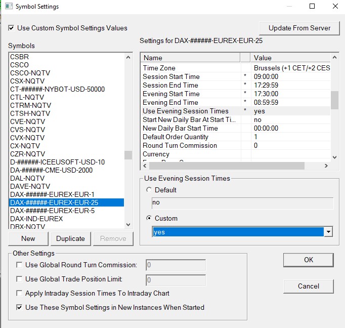

[2024-02-07 11:47:21]
mmalgo - Posts: 6
Hello John!
Many thanks for your response.
As I already described in my first post, the problem is that the changes in the symbol settings are not saved. I did everything exactly as in the instructions. But my settings are not saved.
Regards
Michael
imagesymbol settings.jpg / V - Attached On 2024-02-07 11:47:00 UTC - Size: 121.67 KB - 210 views
[2024-02-07 16:51:46]
So if you Select OK to close the Symbol Settings window and then open it again, the items you changed (such as the Session Times) are set back to the Default values?
