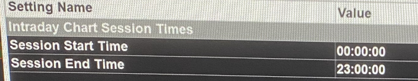

User913209 - Posts: 9
Merci pour la réponse , mais alors pour cette parti là je met quoi ? La parti ou c'est écrit session start time et session end time ? Car j'utilise le Tpo sur toute l'horaire de cotation journalièreEt non en use evening session

[2024-05-15 21:06:16]
From Google Translate:
Thank you for the answer, but then for this part what should I put? Where is it written session start time and session end time? Because I use the Tpo throughout the daily trading schedule and not in use evening session
The entries for "Evening Start Time" and "Evening End Time" are just below the "Session Start Time" and "Session End Time".
If you do not use the Evening Session, then it does not matter what you enter for the Evening Session Times, just make sure the option for "Use Evening Session" is set to "No".
All of the information on the Session Times is located here:
Chart Session Times
