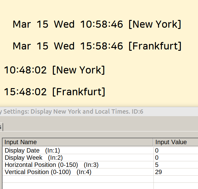

[2023-03-15 14:54:27]
Tony - Posts: 733
@Chris
You are welcome, just a quick and dirty solution, sorry, I was in a rush, if you are into coding,
you could definitely make it fancier, see the final result in the attach image.
I wrote on Sierra Chart's template, you will have to change the text color/size in Subgraphs tab,
and after change horizontal or vertical positions, you might have to hide and unhide the study to make
the change effective. Not sure why, could be my OS issue.
To display date or week, change those values from 0(No) to 1(Yes)

[2023-03-15 17:50:40]
Chris900 - Posts: 6
@Tony: Great Stuff, thanks a lot. I just loaded into the system and it works nicely. Really cool that you wrote a quick coding for me! Thanks :-) :-)
As for anybody else who might want to have this in the future.
Here is the guideline to load this:
How to Build an Advanced Custom Study from Source Code
And then make sure like Tony said to go into Analysis-->Studies-->click on settings for the study-->go to tab subgraph
And change the color and width/size (bigger) so that you can see it on the chart. Took me a while to figure this out.
Really nice, now I see both times all the time very quickly.

if (DisplayDate.GetYesNo())
displayText.AppendFormat("%s %d ", SHORT_NAME_FOR_MONTH[dT2.GetMonth()], dT2.GetDay());
if (DisplayWeekday.GetYesNo())
displayText.AppendFormat("%s ", SHORT_NAME_FOR_DAY_OF_WEEK[dT2.GetDayOfWeek()]);
displayText.Append(sc.DateTimeToString(dT2, FLAG_DT_COMPLETE_TIME));
displayText.AppendFormat(" [%s]\n\n", TIME_ZONE_NAME_STRINGS[TimeZone2.GetTimeZone()]);
sc.AddAndManageSingleTextUserDrawnDrawingForStudy(sc, 0, Horizontal.GetInt(), Vertical.GetInt(), TextSizeColor, 1, displayText, 1, 0, 0);
imagedisplaytimes.png / V - Attached On 2023-03-16 09:40:30 UTC - Size: 54.06 KB - 444 views
[2023-03-16 15:16:00]
Tony - Posts: 733
Thanks User431178! That was quick!
Good to know the sc.Input[0].SetTimeZone(), not listed in the Members List on Sierra's web site. I guess I will have to read head files in ACS_Source folder when I have time. For things like SHORT_NAME_FOR_MONTH[] etc.
Thanks again!
