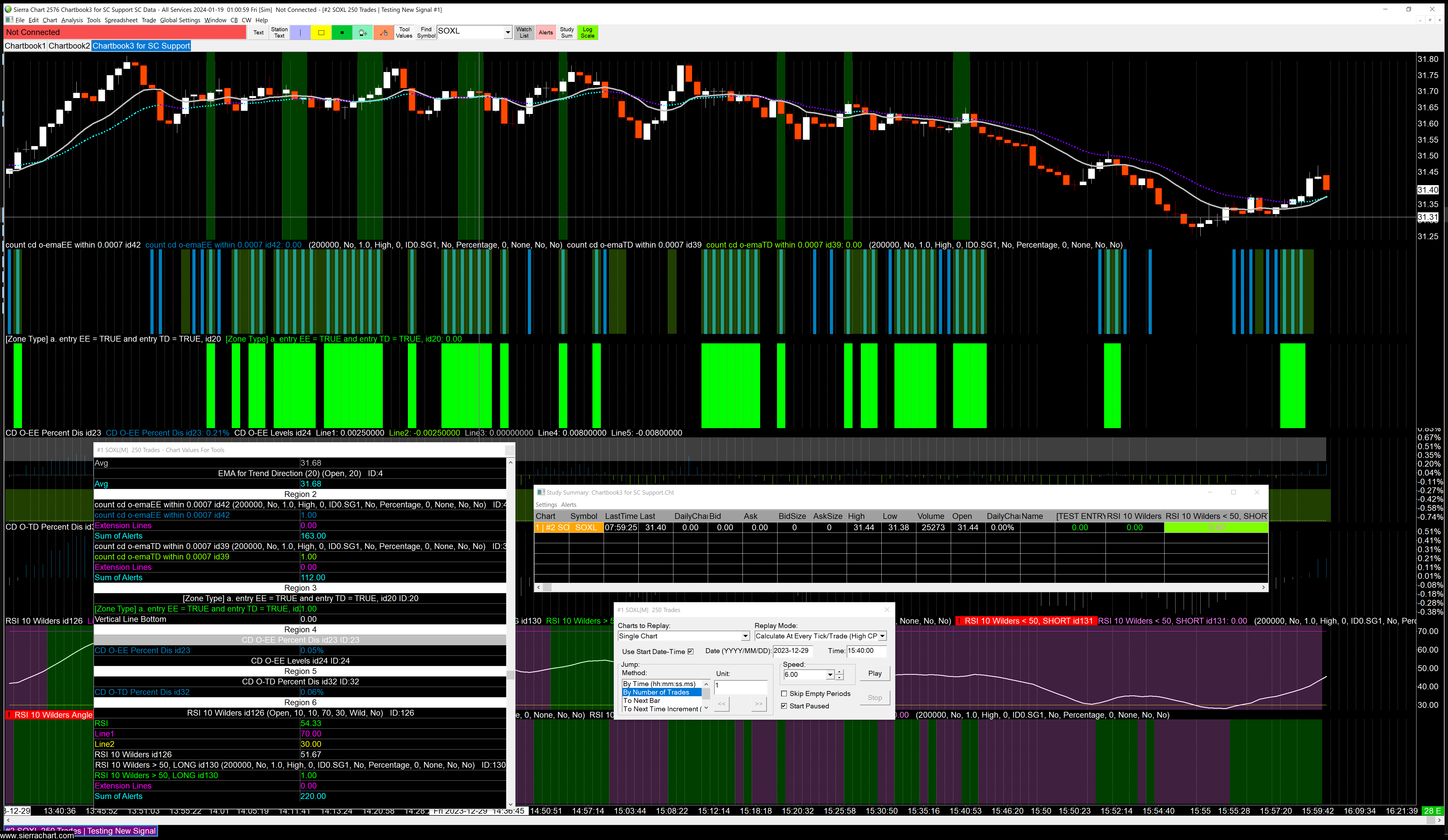

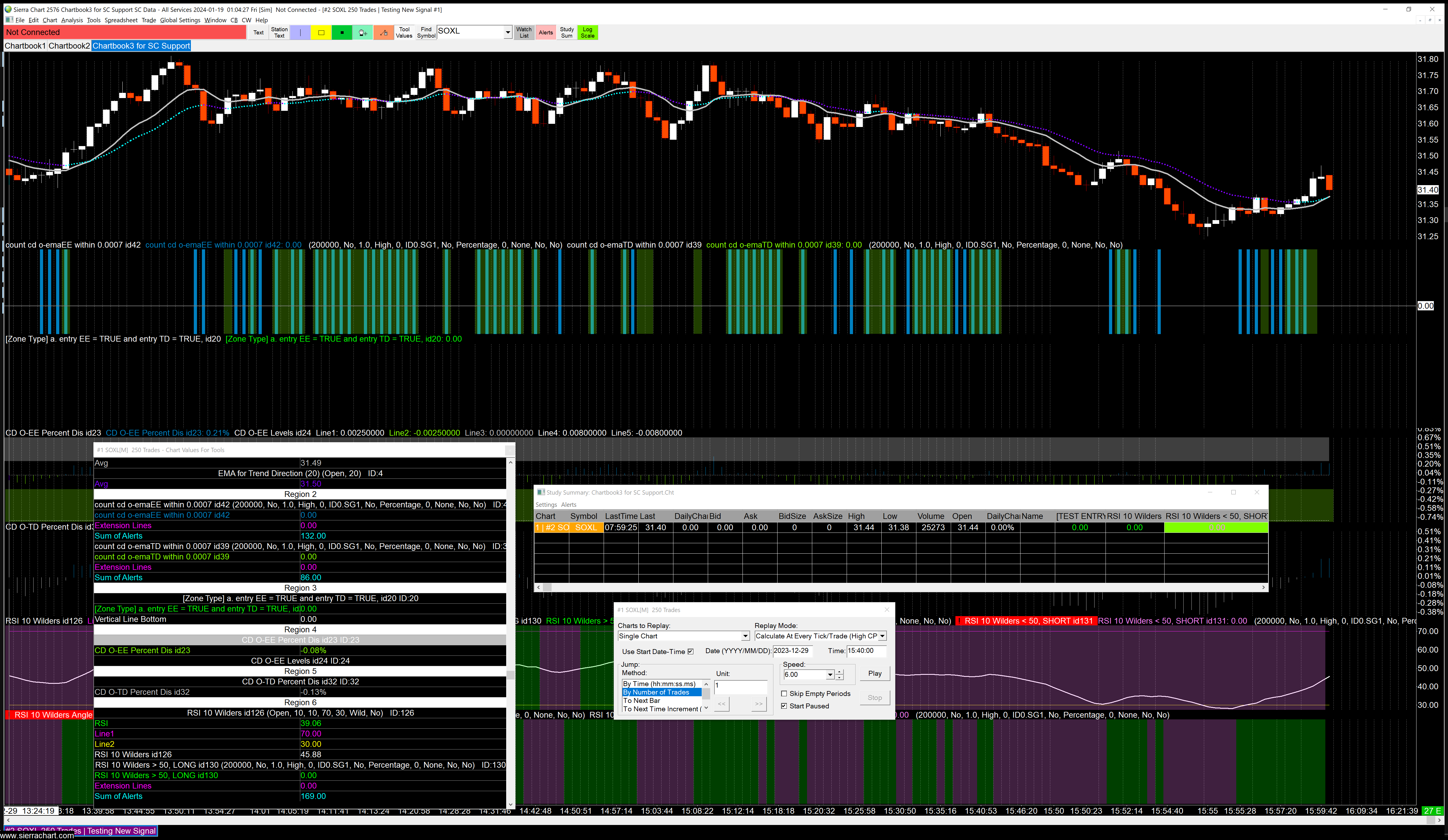

Did you press Ctrl+Ins? If you opened the studies in a new chart, please check that study 2 on the list, ID323 (OHLC), is set up correctly. It should reference the Open of the same chart. Nothing will work without this indicator set up correctly. For your reference, I'll attach a screenshot of my screen. I'll unhide ID20 and its underlying studies (ID39, ID42) and display them in the subgraphs directly below the chart. Their short names include their ID number. However, please note that ID20 is another one that will only show up by pressing ctrl+Ins, although ID39 and ID42 do not share this problem. ID20 references indicators that themselves reference the 'Study Overlay - OHLC' indicator, ID323 mentioned above. I'm using the OHLC study to reference not another chart but its own chart. ID39 and ID42 show no issues with this, but so I'm not sure why ID20 won't display unless Ctrl+Ins is pressed. After CTRL+INS
https://www.sierrachart.com/image.php?Image=1705644062300.pngBefore CTRL+INS - to recreate, press F6 -> OK
https://www.sierrachart.com/image.php?Image=1705644270461.png
