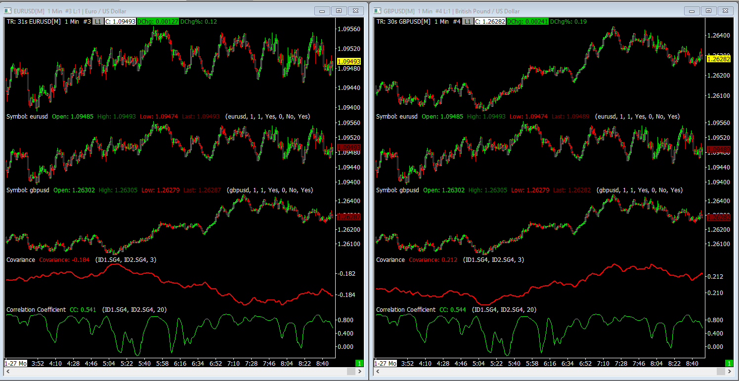

In the attached image same studies applied with same parameters on left and right chart.
I want to calculate covariance of the symbols in the subgraphs added via "add additional symbol" study.
If I change the symbol of the chart on the right in the main graph, covariance study change, but it shouldn't.
The correlation study, that is similar infact doesn't change.
The same behavior happen with symbols added via "study/price overlay" study from other two charts
Please can you check?
TY

Teorically the movement of covariance indicator MUST be the same in both charts because it is referred to studies (symbols) in the 2 subgraphs, not to the symbol in the main chart area (chart region 1)
As said, the correlation indicator at the bottom of charts that is very similar, as you can see don't change when you change the main symbol.

This is quite involved to analyze, bbut we will change the Covariance study in such a way that it is capable of calculating at an earlier index if the data it is referencing is changing at an earlier index compared to the calculation start index. This is normally what leads to the problem.
We have also verified that the Covariance calculation is stable when recalculated as compared to replay or real-time updating, and does not change.
The change will be out in version 2567.

I don't know if you understand which is the issue that I described in prior posts but now the indicator is totally useless, it plots an horizontal continuous line.

We understood it well enough, but there was a mistake with the change we made. We are correcting that now. We apologize.

It was not fixed in 2568. Should we expect it for the next version?

What was not fixed in version 2568 specifically?
The study has been updated to recalculate at an earlier index to support what is specified here:
Study/Price Overlay Study: Data Changing at Chart Bars Earlier Than Being Referenced in Source Chart
If you need another study to support this functionality let us know and we will update it to support that.
If you are still having an issue, with then you will need to implement your own custom study to accomplish what you specifically need:
Advanced Custom Study Interface and Language (ACSIL)
If you have an issue, with study interdependency that causes this:
Then also refer to the information here:
Chart Studies: Study Calculation Precedence And Related Issues
