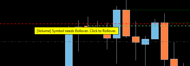

I'm using sierra to trade Crude Oil Futures. For some reason tonight I'm getting a message that is telling me "[Volume] Symbol needs Rollover."

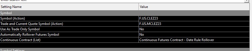

Only problem here is Crude oil is not ready for rollover. I checked on Trading View and Think or Swim as well as the CME website to DBL check. Not only that but I do not base my rollovers on "Volume" I use "Date Rule Rollover". I have attached a picture of both the message and the Continuous contract setting I use for your reference. I thought perhaps I had an old version of Sierra so I just updated to the newest version this evening and it also didn't help. Please let me know what i can do to fix this issue. Having the Yellow banner across all my screens is a little inconvenient. Thanks and I look forward to your response- Ryan Bailey

There is not a problem here at all.
The volume is higher in the January contract versus December at this time for NYMEX crude oil. And the difference is very substantial at this time. Unless you have a reason to be in December you should go to January.
If you do not want to have a notice based upon volume, then set this to No:
General Settings Window: Detect Rollover Of Current Futures Contracts Symbols Based On Real Time Volume (Global Settings >> General Settings >> Charts >> Symbol)
