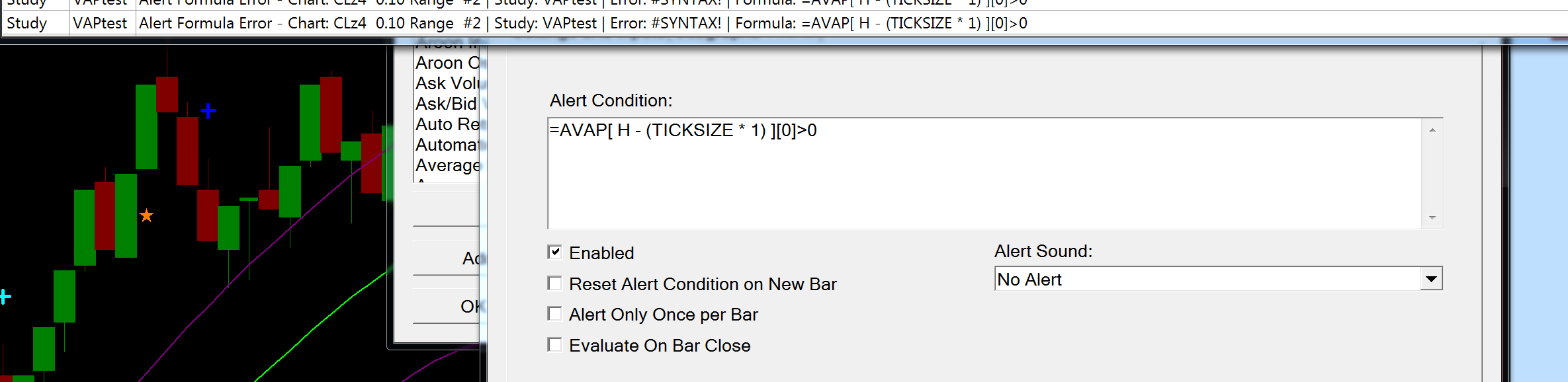

[2014-11-12 03:04:48]
Shane - Posts: 31
I get a syntax error when I try this. I'm using version 1211. Please see attached graphic. It shows both the (very simple) test formula and the error in the log.
regards,
shane
imageAVAPerror.png / V - Attached On 2014-11-12 03:03:31 UTC - Size: 88.72 KB - 740 views
[2014-11-12 03:27:40]
We will fix this.

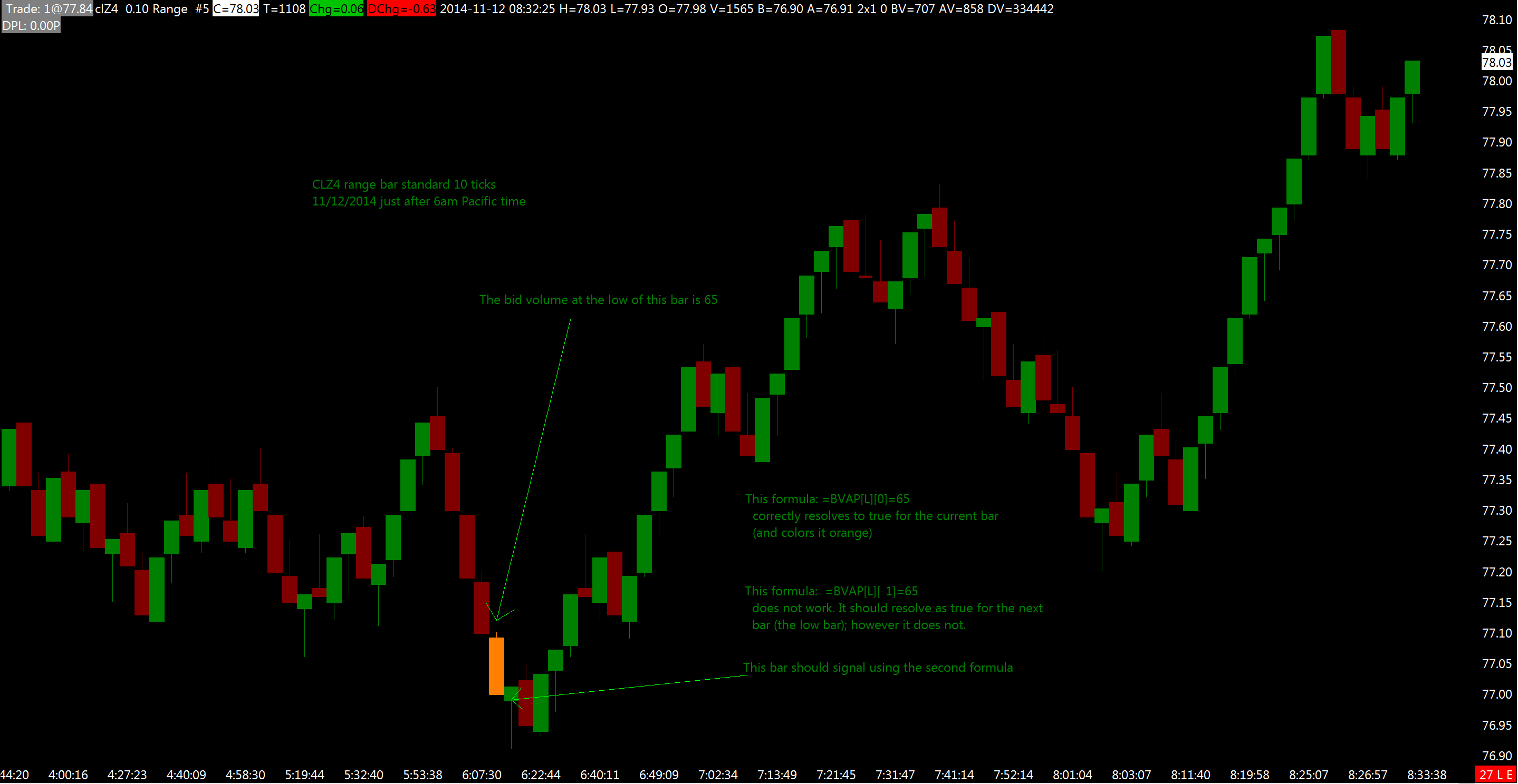

Shane - Posts: 31
In addition to this issue noted in #30, there is another problem. The syntax for BVAP is followed by two brackets where the first bracket is the price and the second bracket is the bar offset. The second bracket bar offset does not appear to work for anything except the current bar. In other words, it doesn't look back to the previous bars correctly.
Please see the attached graphic which demonstrates the issue in detail.
regards,
shane
imageBVAP.png / V - Attached On 2014-11-14 05:32:26 UTC - Size: 133.84 KB - 679 views

[2014-11-18 09:27:26]
We looked into this and this is what we determined:
When using a subgraph identifier together with an offset, such as in BVAP[L][-1], the offset does not affect how the subgraph identifier is evaluated. BVAP[L][-1] will get the bid volume of the prior bar at the low price of the current bar. To get the bid volume of the prior bar at the low price of the prior bar, that would be BVAP[L[-1]][-1].
The documentation has been updated.
