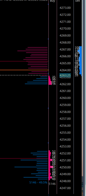

For the past several weeks, I've been having issues with my dom's data. As you can see from the image, that has been uploaded, it has gaps. As time sequences through the morning, the data starts to fill in the gaps. I have market depth data, I'm running the latest version. it was doing the samething on the previous version.
imageScreenshot 10-24-2023 09.10.47.png / V - Attached On 2023-10-24 13:16:07 UTC - Size: 39.98 KB - 386 views
[2023-10-24 14:42:59]
John - SC Support - Posts: 48438
Can you please get us that chart by following these instructions:
[2023-10-24 14:43:55]
What symbol is this for?
We want you to disable custom symbol settings:
Global Symbol Settings: Disabling Custom Symbol Settings
And reconnect to the data feed:

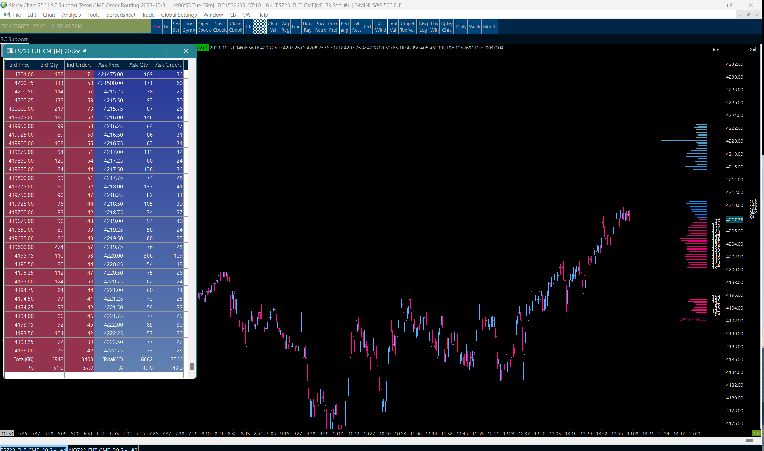

[2023-10-31 18:09:36]
User473031 - Posts: 72
I just completed latest update to SC. I'm still having issues, and it's only with ES.
I did a screen capture of market depth Window and you can see there is a gap in the DOM, and in the Market Depth Window, the pricing is six digits not the normal five digits.
imageScreenshot 10-31-2023 14.07.03.png / V - Attached On 2023-10-31 18:09:30 UTC - Size: 225.2 KB - 325 views
[2023-11-02 14:38:43]
*Disable* Use Custom Symbol Settings Values.
[2023-11-03 11:50:31]
I wanted to get back to let you know that you solved the issue. The custom symbol values was enabled. Once I disabled this, everything returned back to normal.
Thank you very much for your assistance.
