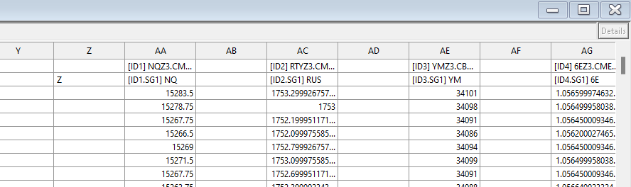

Hi Team,
how can i get value from overlayed SingleLine in Spreadsheet (see Screenshot)
Regards
imagecorr.png / V - Attached On 2023-10-16 11:39:14 UTC - Size: 12.52 KB - 298 views
[2023-10-16 15:55:03]
John - SC Support - Posts: 48438
In general, study results are displayed in the Spreadsheet Study starting at column AA. Refer to the following:
Working with Spreadsheets: References to Study Subgraph Columns when using the Spreadsheet Study

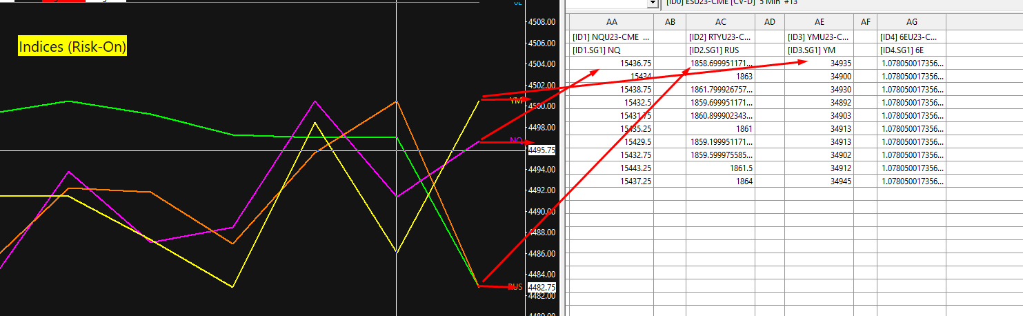

Bartezz - Posts: 18
I would like to compare which line is higher or lower then ES Line (Green), but in Spreadsheet i can see only current Instrument-Price, so i cannot compare ES- 4059 Price with NQ 13576 Price, for comparation i need the line-Prices from chart. As you can see in Attachment YM (yellow) is about 4501, NQ(Ping) is about 4495,75 and RUS and ES (Green and orange) is about 4482.75. But i can see it only on chart and not in spreadsheet.
imagecorr-question.png / V - Attached On 2023-10-27 16:57:14 UTC - Size: 53.19 KB - 236 views
[2023-10-27 17:25:02]
The prices you are viewing on the chart are not the prices of those instruments. The yellow line (YM), for example, does not have a price around 4501.00. The instruments on that chart that are not the main one (ES) are independent scaling. What is shown in the Spreadsheet is the correct value for those instruments.

[2023-10-27 19:23:19]
Sawtooth - Posts: 4359
The Overlay (Single Line) study defaults to Scale >> Independent, so its line will not appear on the chart at the price of the destination chart.
But it's price in the spreadsheet output will be accurate.
This study is intended to be used in a Chart Region other than Region 1.
If you put it in Region 1 with Independent scaling, you can make no comparisons between it and the price of other symbols.

[2023-11-05 18:57:52]
Is there maybe a way to solve it with ACSIL Code?
You cannot put more than one symbol in the same Chart Region and then expect to be able to compare whether one closed higher than another.
To even be able to place them in the same region you must choose the Independent scale, which then removes any correlation between them.
If you want to compare their percentage change since the Open, then those lines would be in the same region, but this is not a comparison of prices.
