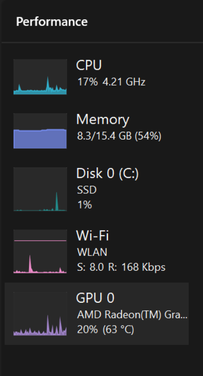

Dear support team,
I have recently a serious performance issue. I'm on vacation so I copied my chartbook to my notebook which has the same CPU as my desktop PC (Ryzen 5900HX with 16GB of RAM and no dedicated GPU). On my Notebook the cpu, gpu and memory consumption is on the lower level without any peaks (see attached screenshot). But when I try to draw something or move a chart it is very laggy to a extend that makes it unusable. Even scrolling through the message log is verry laggy. All other open applications run smoothly. I have in total 11 charts open in my workbook and no lvl 2 data. I reduced my workbook already by closing another 11 charts I rather do not need to check if this will help to increase the performance. Unfortunately it hasn't. I updated Sierra Charts to the most recent version and in addition to that I restarted my Notebook and Sierra Charts a couple of times without an improvement. The same workbook with the total of 22 charts run perfectly fine on my deskop PC with the same CPU and almost identical HW.
Addendum: I closed all charts except of 2. The issue is slighly better but still persists.
Please help.
Thank you.
Date Time Of Last Edit: 2023-08-29 14:42:41

[2023-08-29 15:17:28]
You stated that the notebook does not have a dedicated GPU. Check the setting for "Global Settings >> Graphics Settings - Global >> Other >> Use OpenGL for Chart Graphics". You would want this to NOT be enabled (i.e. disabled - no checkmark). If you change this, then you need to restart Sierra Chart.
See if this helps with your situation.

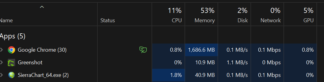

[2023-08-29 19:36:16]
__Kai__ - Posts: 15
No it is also an SSD installed. This notebook is also rather powerful and as I said the same CPU, RAM freuquency as the Desktop where everything runs smooth.
In the meantime I closed all charts exept of one and it stuck also on a frequent basis. I move the chart up and down with my mouse and on a frequent basis the movement is frozen.
The systemload does't even scratch the edges of the system (see screenshot). I've run benchmarks as well and the performance is just fine. Very strange.
