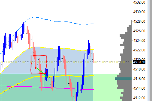

I entered a trade near perfectly then it gapped down to instantly to negative. Happened for NQ the same way. Went up to where I should be in profit but read break even then instantly closed at SL
attached photo

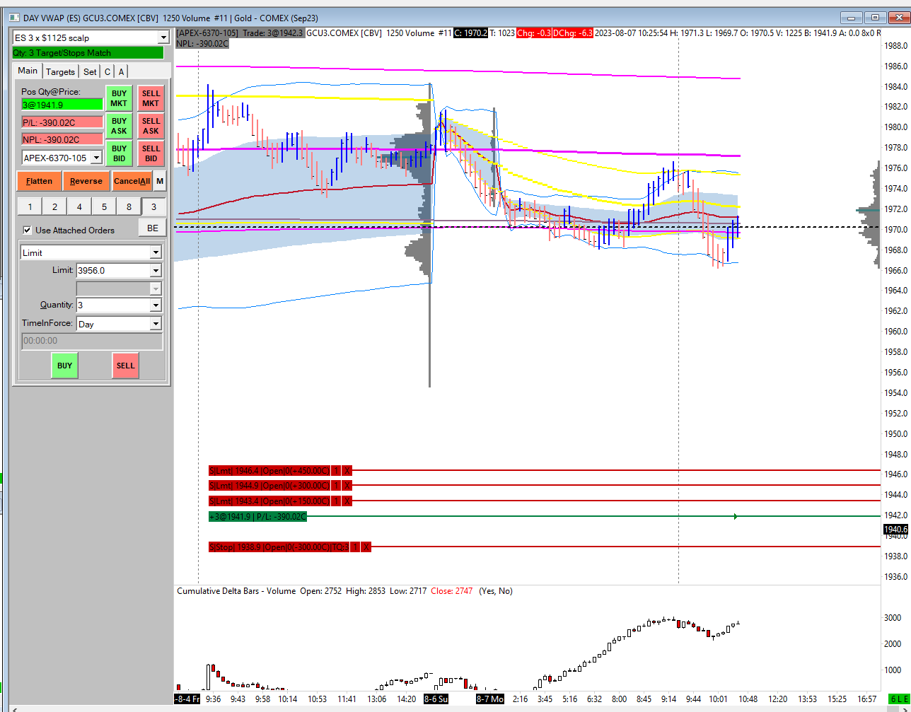

Here is a follow up. 2 contracts. It is impossible to be down $675 in this trade scenario.
imageimage3.png / V - Attached On 2023-08-07 14:16:58 UTC - Size: 11.89 KB - 176 views
imageimage5.PNG / V - Attached On 2023-08-07 14:49:18 UTC - Size: 78.55 KB - 253 views
[2023-08-07 15:20:34]
You need to look through your Trade Activity Log and see what is occurring for the orders you are putting in. We really do not understand how you have orders at 1941.9 as shown in image5.png. Your Trade Activity Log will give you all the information on what occurred for the orders. Refer to the following:
Trade Activity Log: Viewing Historical Trade Activity
What is your setting for "Chart >> Chart Settings >> Trading >> Open Position Average Price"?
[2023-08-07 15:34:54]
william bolger - Posts: 29
None of it makes any sense. But the gap down on the NQ and ES make no sense.

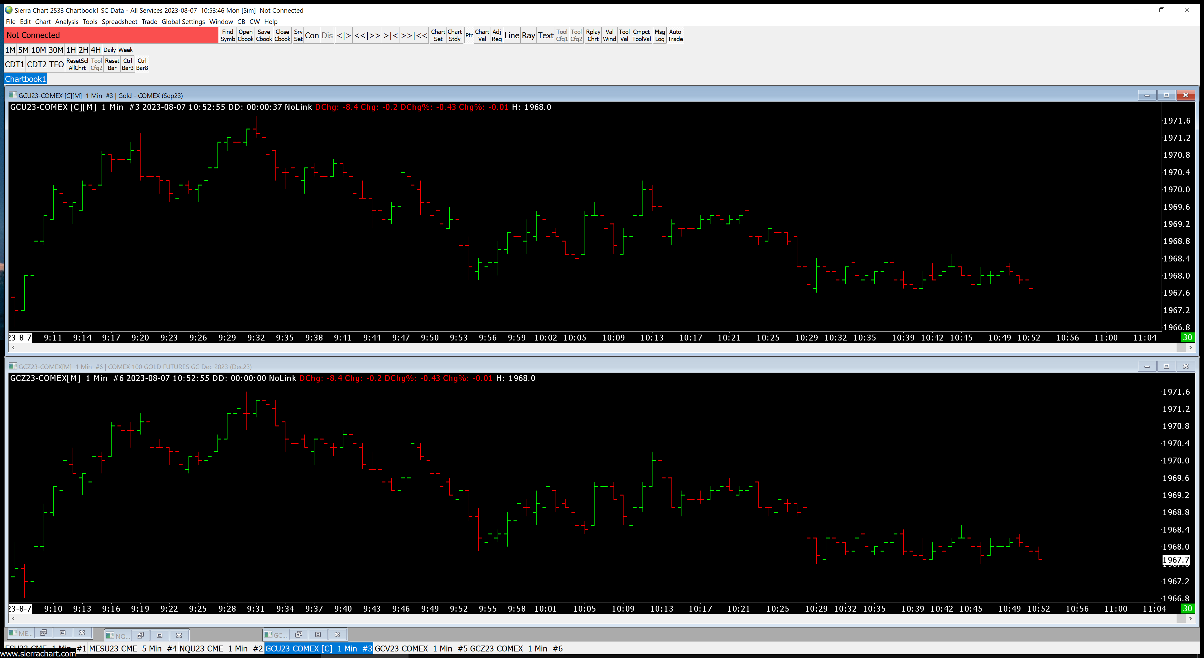

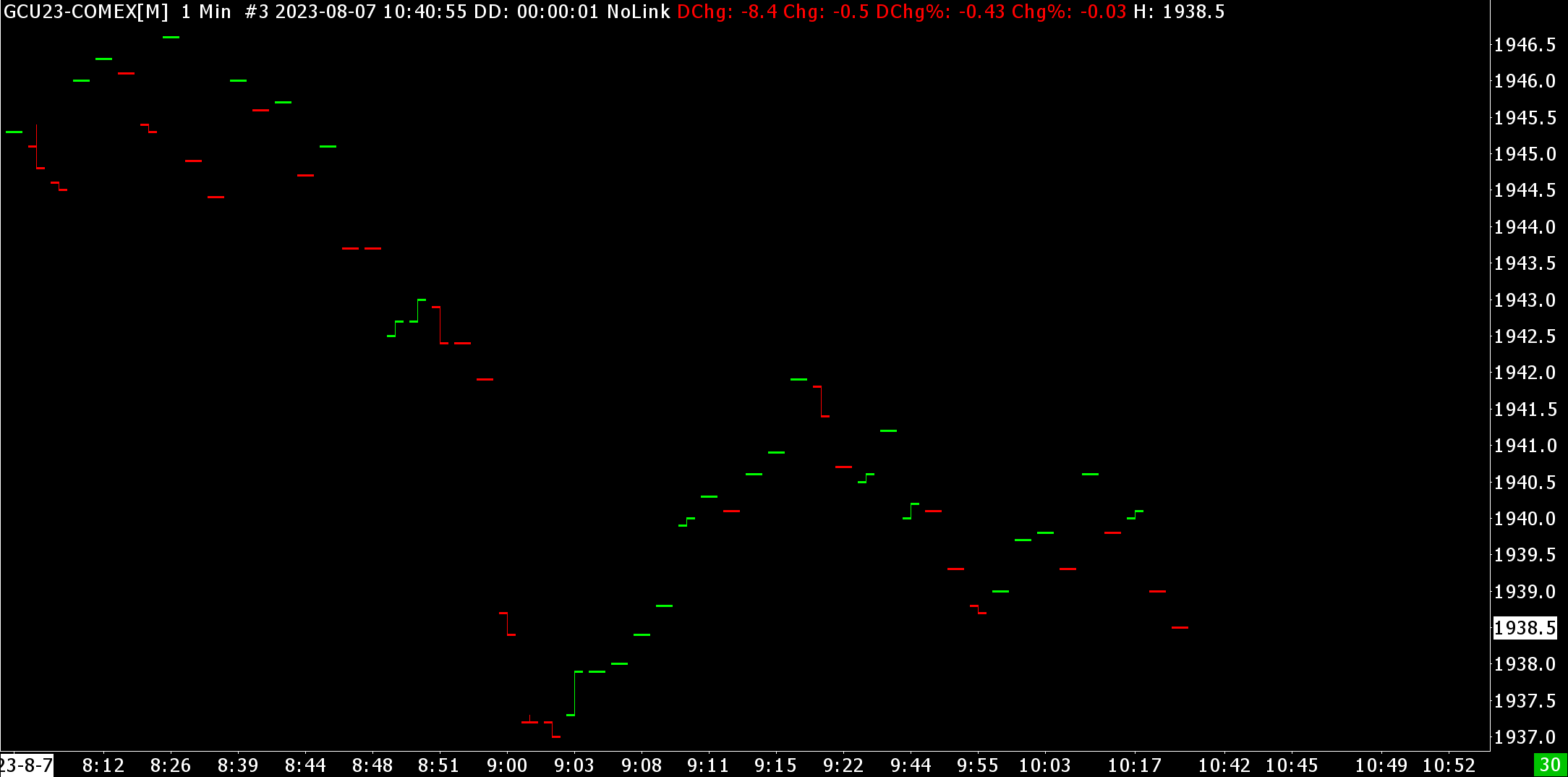

Let's start with the GC situation. In particular, we see that you are trading GCU3.COMEX, but the U contract is not a typical contract that is traded.
The reason you are having an issue with this is because you have the chart as a "Continuous Futures Contract Chart". As such, even though you have specified that the chart is a U contract, it is actually showing you the data for the Z contract (the current front contract).
The image named "GCU23-COMEX[M] 1 Min #3 2023-08-07 10_43_41.221.png" shows a 1 minute chart of the actual U 2023 contract for GC in 1 minute bars. The image named "Sierra_Chart_MainWindow_2023-08-07__10_53_44.853.png" shows the same U 2023 contract for GC in a Continuous Futures Contract (top) in comparison to the V contract (bottom).
Therefore, you are viewing the data for the Z contract but trading the U contract, which is why your prices are so far off.

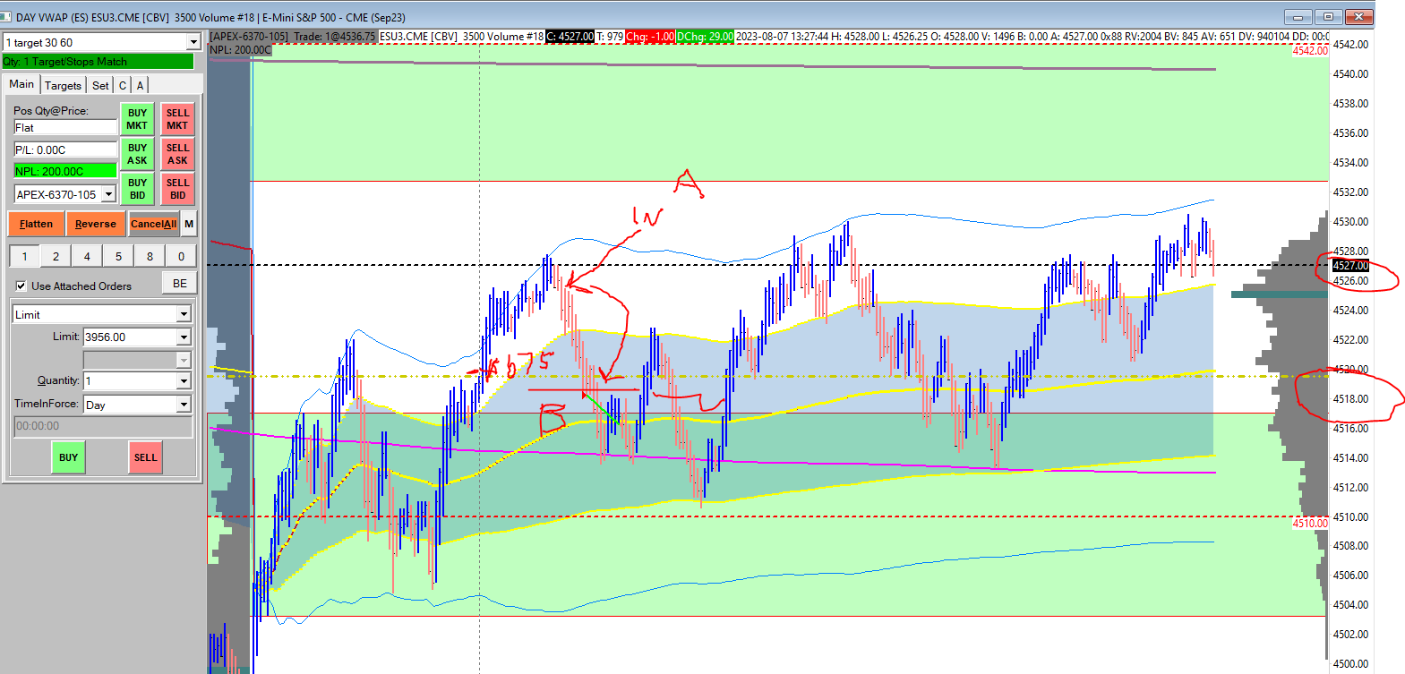

Let me try it this way. I entered at A. It stayed for a second then moved to B and put me -$675....almost instantly. I am using volume bars NOT time bars.
If you look at the trade there is NO way that it could have ever been more than 2 points negative with 2 ES contracts .
There is an error from somewhere that is not calculating my entries incorrectly.
I checked the time and it is correct...unless some weird way data is delayed and it is entering from what I see then correcting the entry to what it is to what it is supposed to be then deducting points as if I entered there. Which would still be a glitch because this trade was never more than 2 points negative .

[2023-08-07 23:23:47]
Look at above image6. I drew it out. I literally wrote it out 3 times.
Look at first image.
I entered with my chart at 4525. It instantly changed to 4518 and put me -$675. -note that the times on the chart were actually reading correctly to current time.
If you look first image you can see the entry way lower. If you look at image 6 and understand that I only took 2 contracts so there is no way I could have possibly been down -$675 as shown in the picture.
What happened is that it entered gapped down before the charting showed it(albeit may be data lag) but still sent a signal to Apex that I was in a loss, which I was not. It was not even possible.
My guess is that the data was delayed somehow and it showed a glitch in your system whereas it traded at current pricing but showed earlier prices and when I entered with old data it quickly went to the proper data but counted the current data but used the old data against me. When it should have just had the correct entry and exit showing in the pnl. It did work out correctly with the ES as far as entering the real market(which was not shown) but it did count against me with Apex. The same thing happened on Friday.
I have fiber with 1000megs each way and a high end gaming pc with a 5 ping to the west coast. Somewhere between SC and Rithmic there is an issue.
