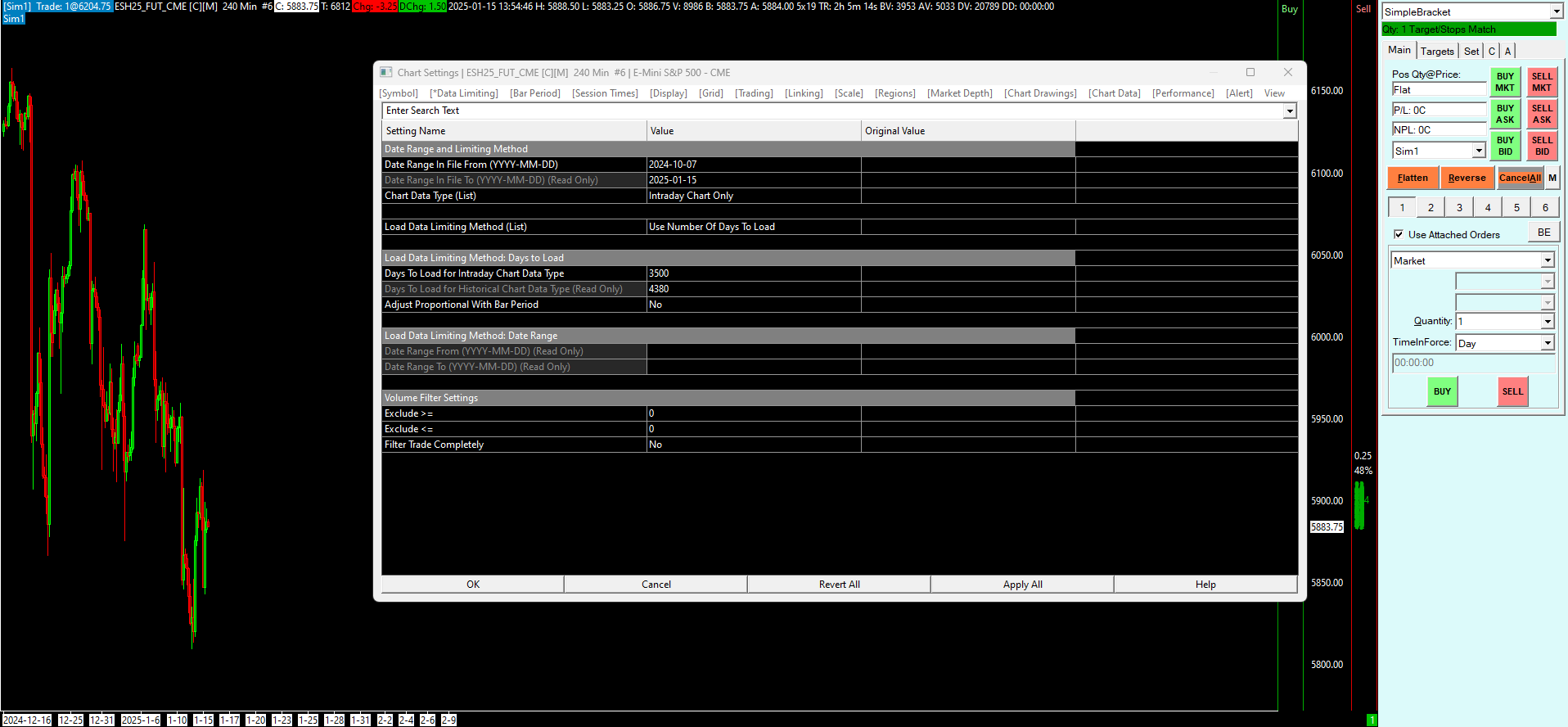

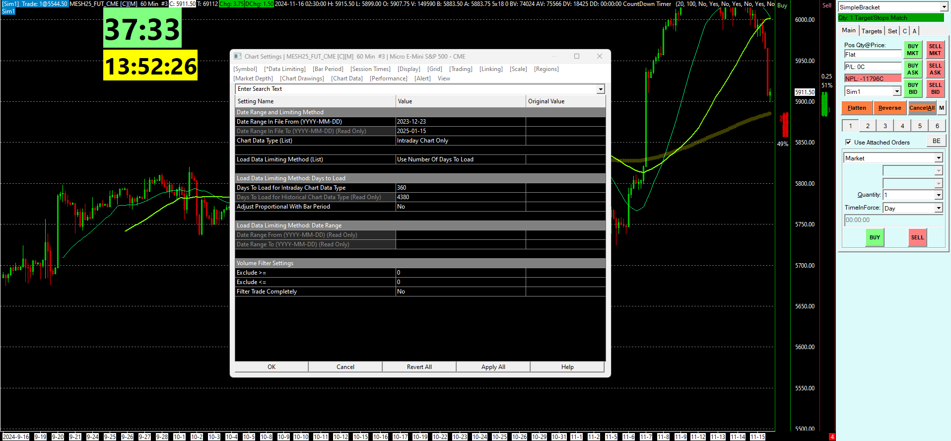

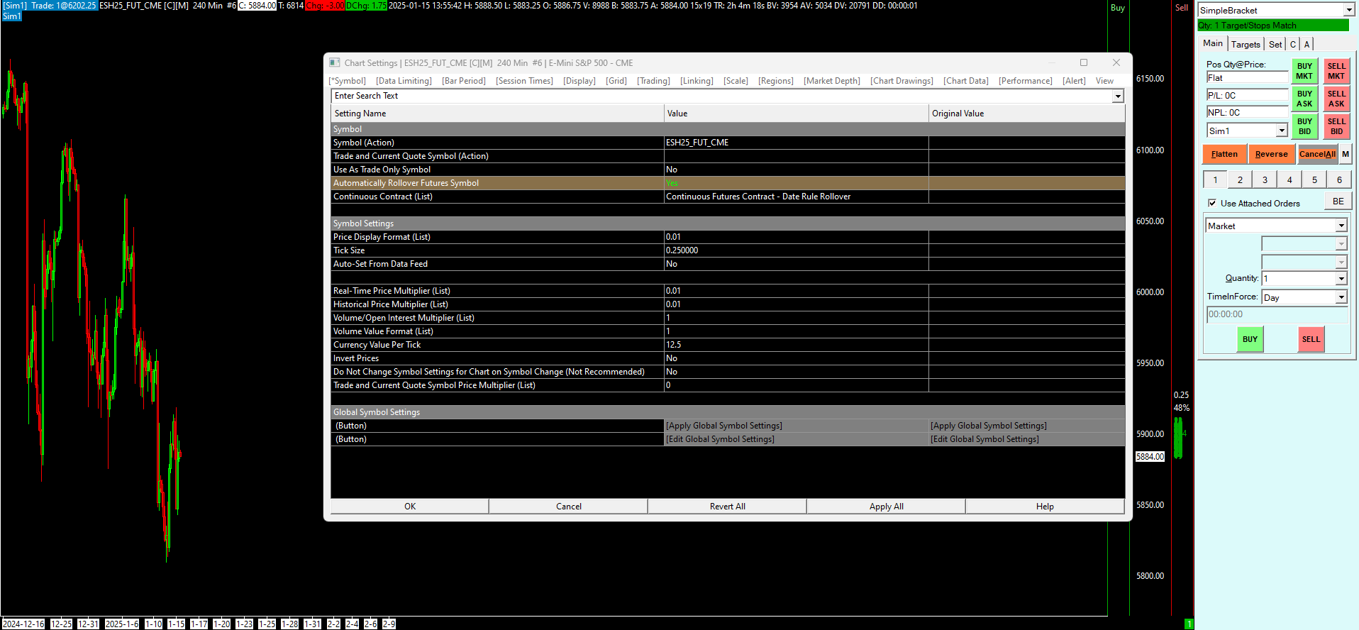

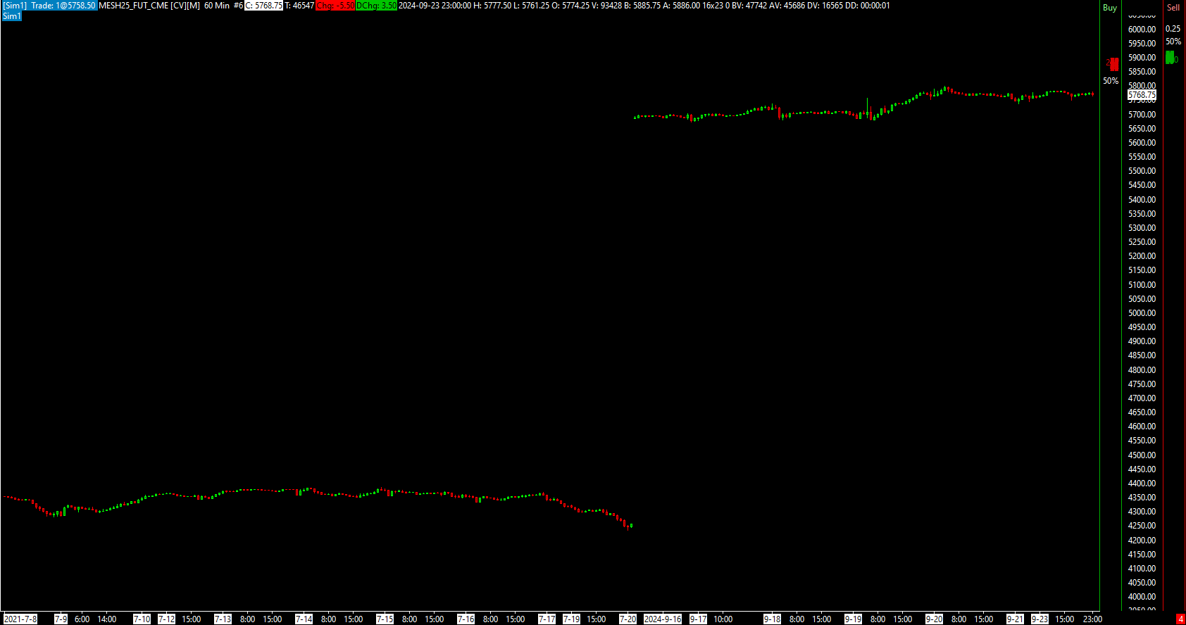

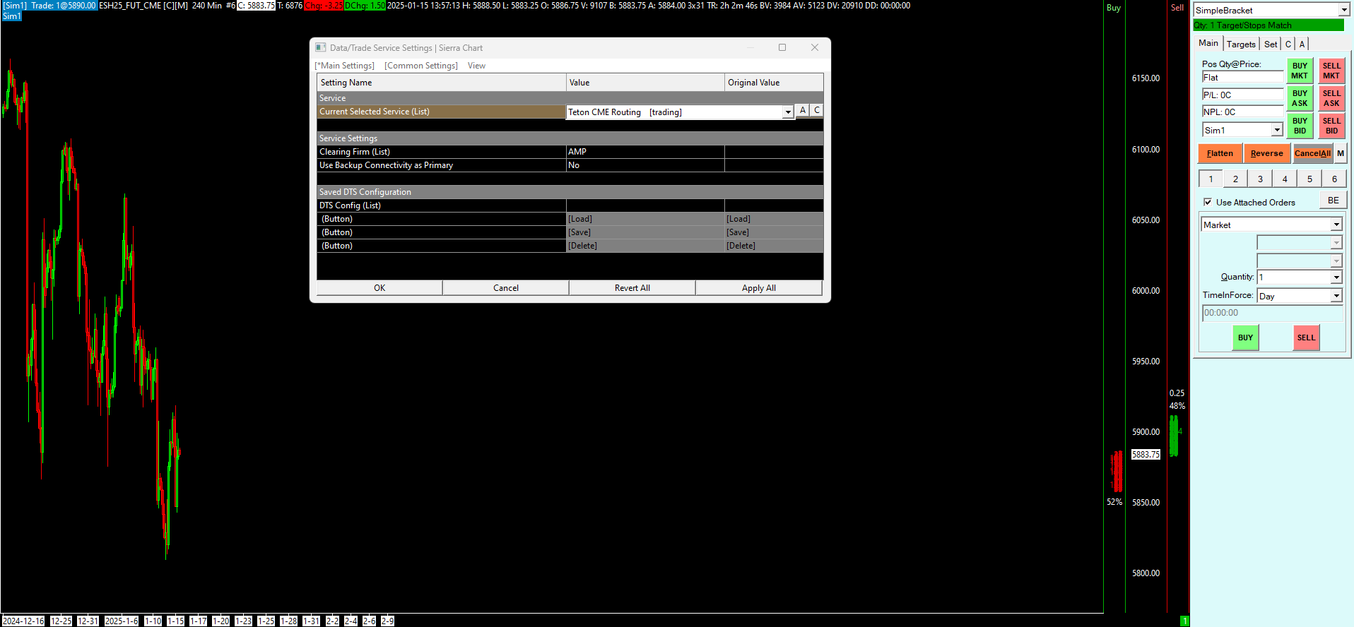

User104198 - Posts: 24
MES
I cannot get the data from 2021-2024.
I would like to have a 4hr chart with 4000 days of data.
As you can see on pics below I can get data BEFORE 2021 so I dont know what the problem is.
To fix it, Ive done
- futures data rollover
- deleted and downloaded data
- recalculated
- tried SC data to convert it but that also didn't load those years
- starte a new chartbook
- deleted all data in data folder.
Im at a loss. Please help.
Also the 1hour chart doesn't load anything before 10/7/24 when I have it loading 360 days.
Is what I want to do possible? Or have I missed something? I couldve sworn Ive had this before.
Am I better off reinstalling Sierra Charts? Hoping theres an easy fix.
Thank You.

[2025-01-15 17:05:10]
For the chart with the missing data from 2021-2024, please follow these instructions to get the missing data:
We definitely have the data - we just downloaded it ourselves to ensure there is not an issue.
For the chart that will not load data further back than October 2024 - select "Delete All Data and Download" and from the window that comes up asking what contracts to redownload, please tell us the earliest contract that is showing in that list.
[2025-01-17 11:55:09]
Thank You! That worked. I wasn't deleting and downloading ALLthe data.
It did fill the missing data!
