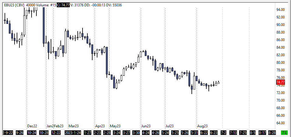

When I try to load EBU23 as a CBV chart on DTN IQFeed, it appears SC is not loading/backadjusting prior contracts correctly.
WTI from your Denali data feed works fine, but rollovers on Brent on IQFeed aren't. I want a continuous time series that looks similar to the IQFeed calculated continuous rolling contract EB#C. The reason I can't just use this is because I want rollover based on volume traded instead of day before expiry (EB#C IQFeed date based method). Something is not right because the amount of volume in the SC calculated continuous contract is much less than the EB#C comparison.
I have tried a number of ways around this, including delete/download of all data, restart of computer and connecting/disconnecting from IQFeed with full redownload, tried different symbols, checked session times and redownloaded latest SC update. I spoke to DTN and they said it was not a problem on their end and directed me to contact SC.
Could SC support compare IQFeed EB#C with SC continuous volume based difference back adjusted EBU23 [CBV] and see if you guys get the same problem?
Other attempts:
Charts appear to be rolling contracts on the wrong date and missing data (using date based rollover also couldn't imitate IQFeed's EB#C)
imageEB#C Example Time Series.PNG / V - Attached On 2023-06-26 10:24:48 UTC - Size: 22.26 KB - 319 views
imageEBU23 [CBV] Example Time Series.PNG / V - Attached On 2023-06-26 10:24:54 UTC - Size: 21.84 KB - 256 views

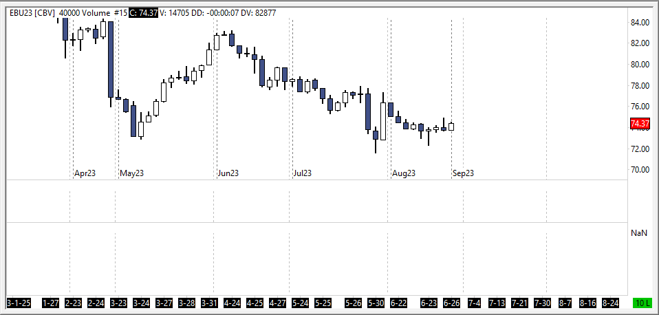

Have tried updating global symbol settings and deleted and downloaded all the data, still getting the same results. The aggregated EBU23[CBV] doesn't have nearly as much volume as the IQFeed EB#C, picture attached looks same as before. I'd be interested to know if you have been able to reproduce EB#C on your end with volume bars?
Date Time Of Last Edit: 2023-06-27 08:38:09
imageEBU23 [CBV] After updated global settings and redownload.PNG / V - Attached On 2023-06-27 08:35:21 UTC - Size: 29.44 KB - 339 views

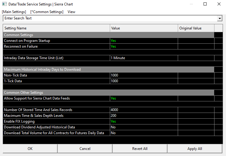

This is what we want you to do:
Set the Intraday Data Storage Time Unit to 1 Minute (Temporarily):
Data/Trade Service Settings: Intraday Data Storage Time Unit (Global Settings >> Data/Trade Service Settings >> Common Settings >> Common Settings)
Fully re-download the data for all contract months in the chart:
The above applies to when using IQ Feed.
Date Time Of Last Edit: 2023-07-07 16:29:37

Apologies, I was on holiday and just got back. Having followed each of the steps I still have the same problem where the contracts do not appear to be back adjusting correctly, image attached of graph and settings. Can we arrange a call to go through this?
imageAfter SC Instructions 12_07_23.PNG / V - Attached On 2023-07-12 07:56:43 UTC - Size: 77.93 KB - 312 views
imageAfter SC Instructions 2 12_07_23.PNG / V - Attached On 2023-07-12 07:58:22 UTC - Size: 21.37 KB - 341 views
