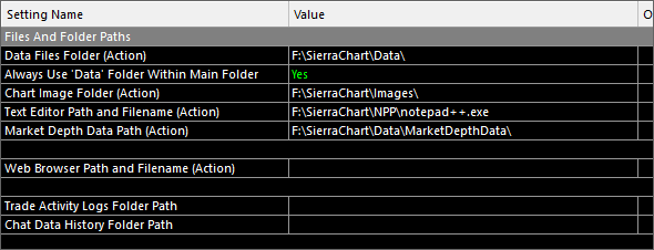

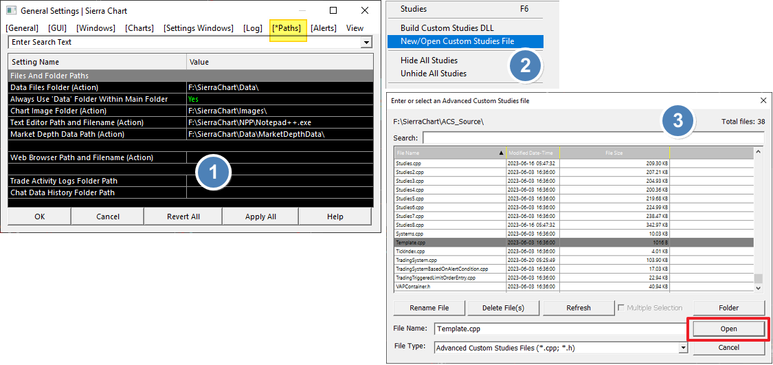

nicktrader - Posts: 813
Hello John,
from my point of view everything is set correctly (see pic#1)
First I open pic#2 and after selecting the file in pic#3 I click on the button "Open". But then unfortunately nothing happens.

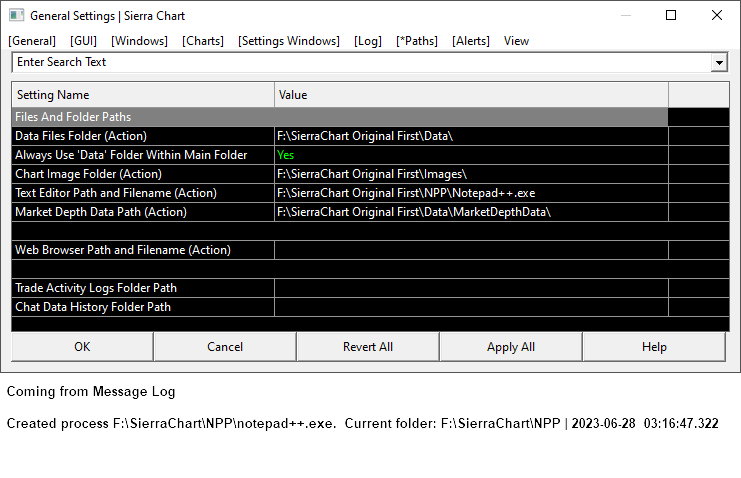

[2023-06-28 03:27:25]
I did the same in the "test version". But the MessageLog shows a different address (see pic)
This is the address of my "Standard Version".
Date Time Of Last Edit: 2023-06-28 03:29:59
imageMessageLog TestVersion.png / V - Attached On 2023-06-28 03:28:04 UTC - Size: 20.22 KB - 171 views
