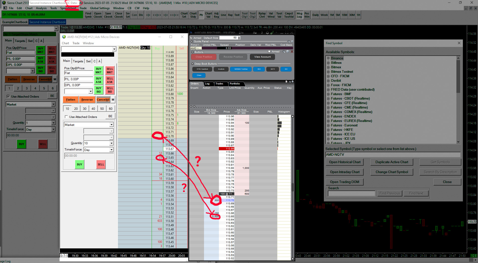

AntoineOpala - Posts: 91
In response to post number 10, I have done what you wrote. I have installed a second Sierra Chart instance and set its data to SC Data-All Services.
[M] is present on charts. Top of the book is shown. For level 2, I'm entering **-NQTV symbols but part of the bid/ask quantities are absent.
Please view my first attached picture for an example:
According to TWS, 300 bids exist at $113,70. Sierra Chart displays none at this price.
According to TWS, 5500 bids exist at $113,65. Sierra Chart displays only 25.
Besides, placing an order in the second instance of Sierra Chart automatically turns trade simulation mode on. Live trades still have to be taken in the first instance.

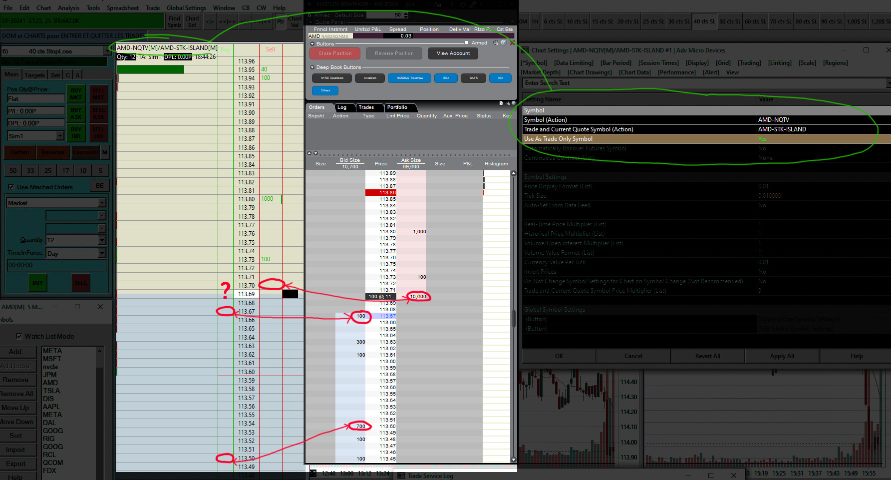

Distinguishing "symbol" and "trade current symbol" ("use as trade symbol only" being set to yes) works fine for level 1 symbols such as AAPL. Level 2 symbols such as AAPL-NQTV miss some of the bid/ask quantities just like in the first example above. Please view the second attached picture.

[2023-07-06 13:43:12]
The reason for the difference in the Bid/Ask is that the NQTV Market Depth data is only for the NASDAQ exchange, the same as the volumes for that data feed. It is not the consolidated Market Depth data.
We are working on putting everything together, but it is still a works-in-progress.
