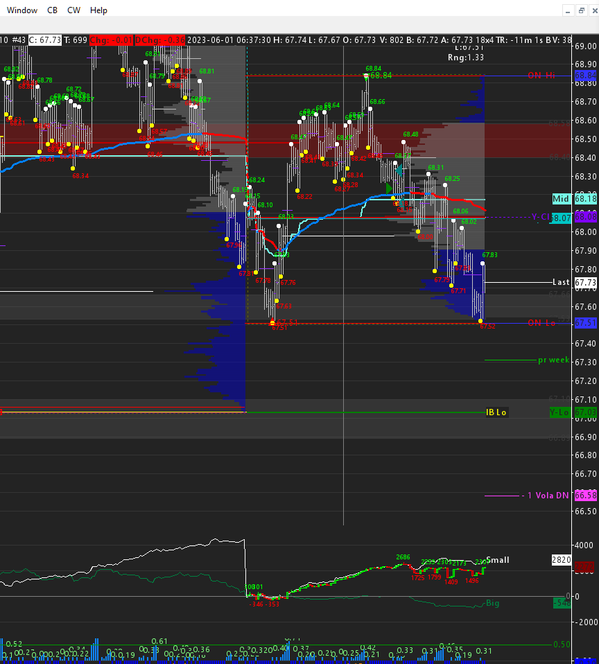

Pls help - in order to be able to see support resistance levels lines on the right hand side of the chart -
is it posible to create a drawing type - 'line from last bar to end' and then that drawing will easily be copied across various charts?
Pls see images,
Many thanks
images r line after last bar.PNG / V - Attached On 2023-06-01 14:22:34 UTC - Size: 183.15 KB - 359 views
images r line drawing overlay.PNG / V - Attached On 2023-06-01 14:22:40 UTC - Size: 84.42 KB - 284 views

I was using a tool - Horizontal line non extended.
( For S/R levels, I have in the past used many line studies in a big study collection to paste over my charts, bu it is very laborious when it comes to the overlay, as you have to save the original stdies, and apply them aswell, so have stopped doing that.
Was looking for a faster easier method , like I draw my support zones like extending rectangles and the easily replicate over charts as they are drawings. The propblem with actual S/R lines is that I dont want them all over my charts, but just after the last bar.

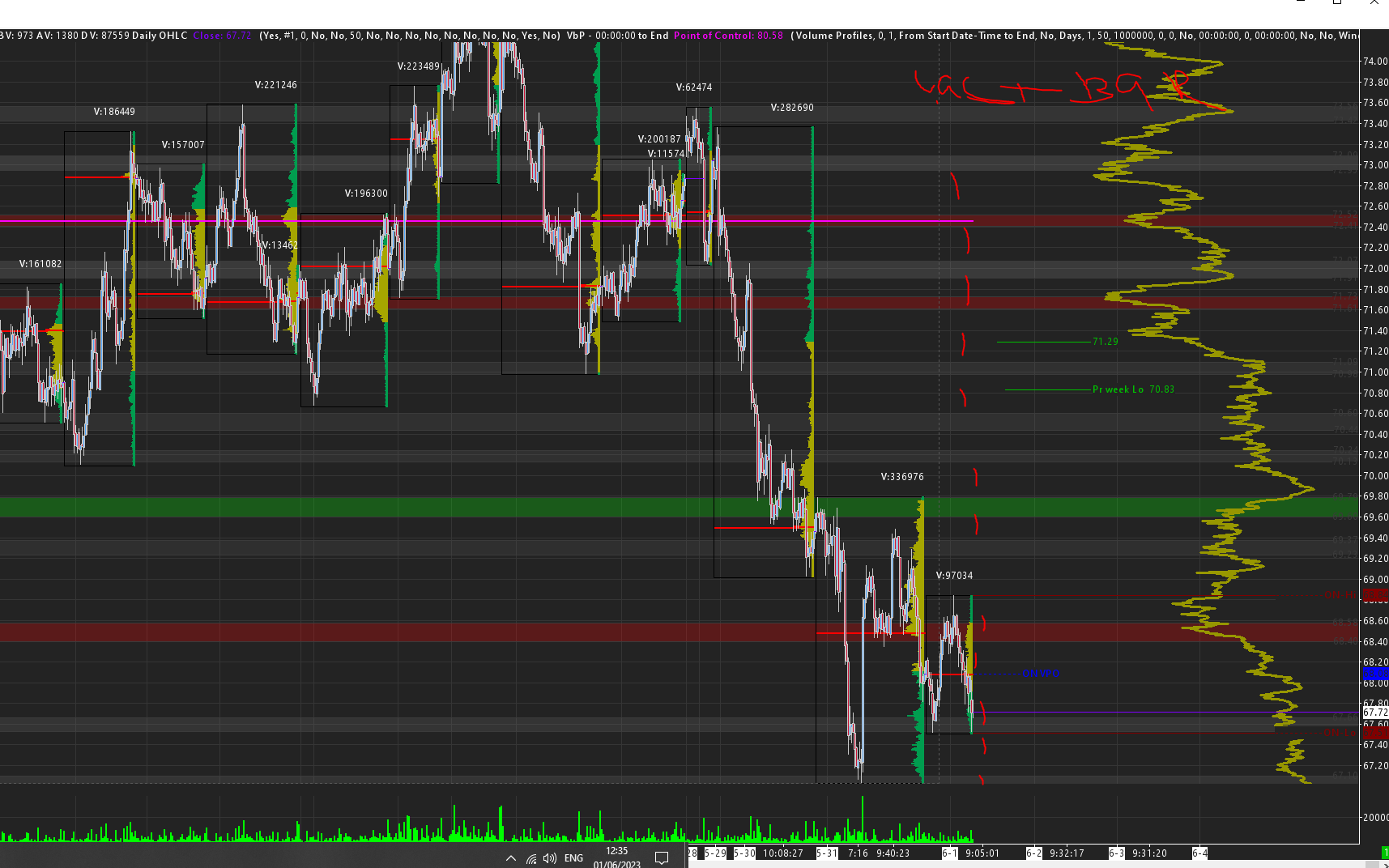

Hi, thanks -
Please see an example of S&R lines. There is no easy way of having these and adjusting them easily...
hence i thought of 'drawings' that only appear after the last drawn bar, when replicated over multiple charts
imagesr levels.PNG / V - Attached On 2023-06-16 10:40:55 UTC - Size: 414.19 KB - 274 views
