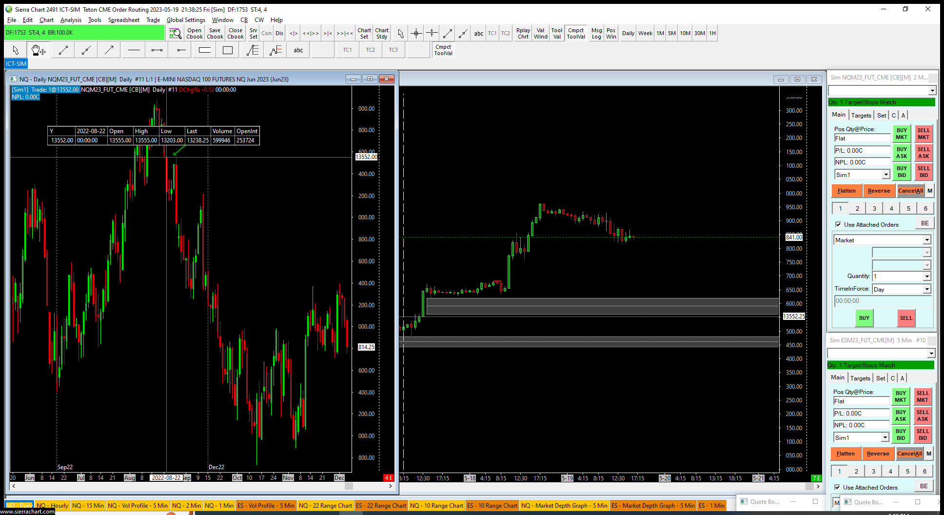

I'm seeing a discrepancy in historical pricing. When viewing August 22, 2022 on my chart the NQ Mini shows a high of 13,555.5. However when viewing the same day in Tradingview and Barchart I see a high of 13,226.5. I've tried deleting and downloading the data, but it shows the same. Days around that Aug 22, 2022 date are also wrong. Any thoughts on why and how to correct? |

| Delta Tango Foxtrot - Posts: 32 |
Here's an image showing the bar with price and date. https://www.sierrachart.com/image.php?Image=1684546706904.png |

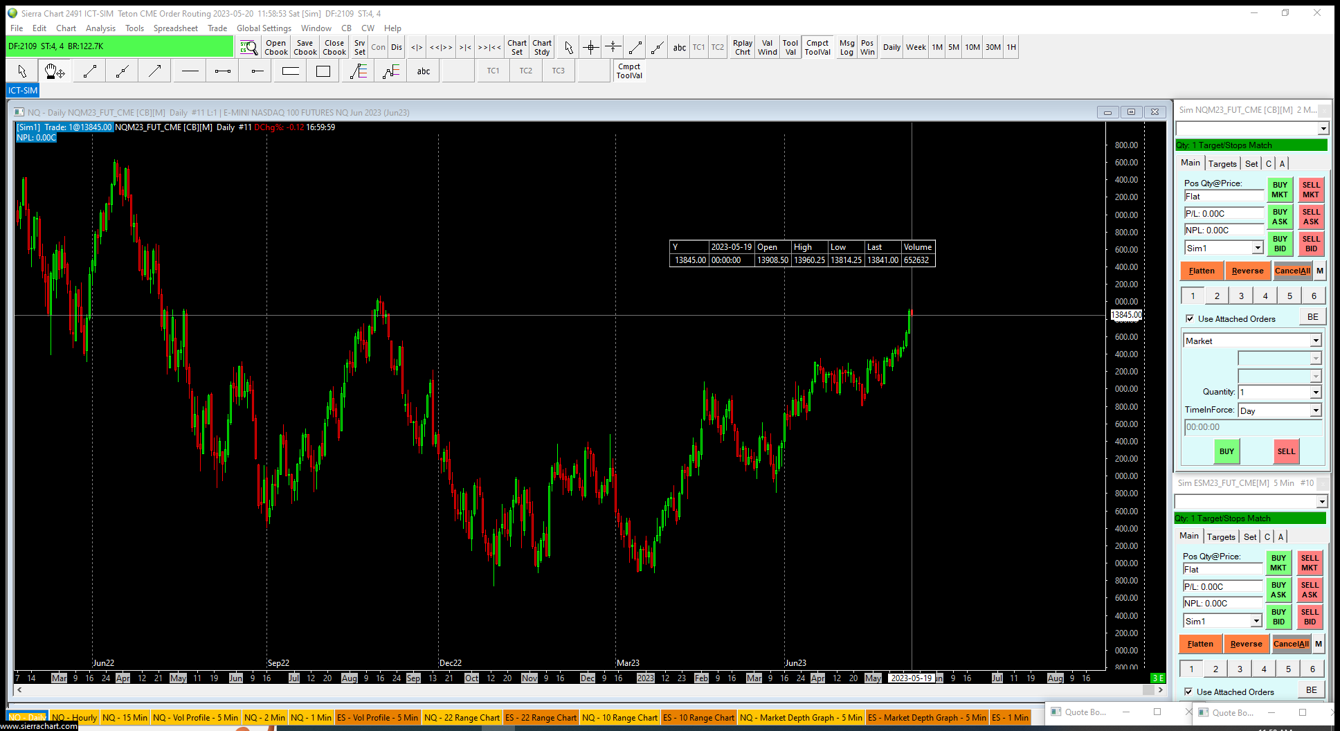

Also see this image showing that on the same chart the most recent candle shows an accurate price. https://www.sierrachart.com/image.php?Image=1684598336629.png |
| [2023-05-20 16:01:21] |
| Sierra_Chart Engineering - Posts: 25424 |
You are looking at a continuous back adjusted chart. You need to choose a rollover option that is not back adjusted: Continuous Futures Contract Charts: Continuous Futures Contract Rollover Options Sierra Chart Support - Engineering Level Your definitive source for support. Other responses are from users. Try to keep your questions brief and to the point. Be aware of support policy: https://www.sierrachart.com/index.php?l=PostingInformation.php#GeneralInformation For the most reliable, advanced, and zero cost futures order routing, use the Teton service: Sierra Chart Teton Futures Order Routing Date Time Of Last Edit: 2023-05-20 16:01:34
