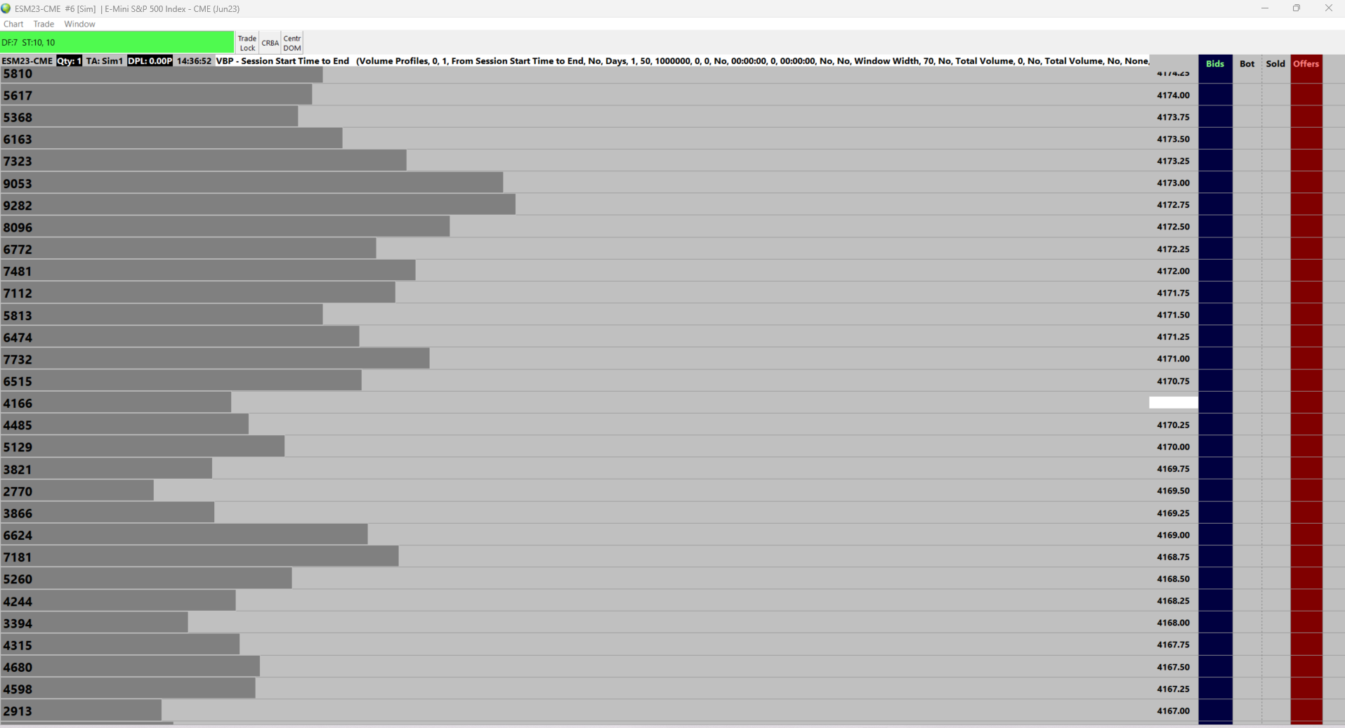

Hi, please how can i get my price moving on the chart plus contracts(Bids/offer) to appear on the Depth of Market.
I cancelled my Denali data feed yesterday, went from service package 11 to Service Package 5 Base Advanced. I have all the current symbols set correctly on the charts and have changed the setting to SC Data - All services for me to use delayed data feed but is not working.
I have also deleted the chartbook and re-installed but still won't show as attached in the image.
Thank you and looking forward to hearing from you.
imageImage.png / V - Attached On 2023-05-17 18:20:17 UTC - Size: 526.73 KB - 212 views

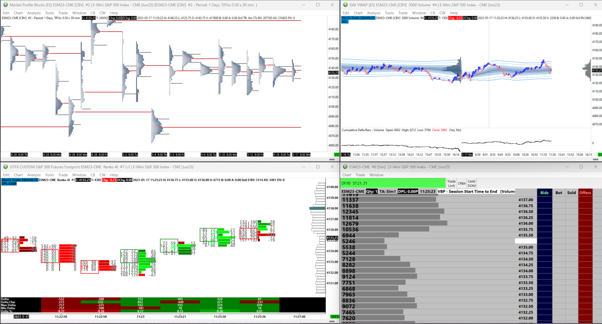

The symbol is ESM23-CME.
Software version: 2502 64-bit | 2023-05-17 14:40:31.811
Primary Thread ID: 21080 | 2023-05-17 14:40:31.811
Usage end date: 2023-12-23 | 2023-05-17 14:40:31.811
Enabled for: Advanced Features 2. | 2023-05-17 14:40:31.811
Enabled for: Sierra Chart Historical Data Service. | 2023-05-17 14:40:31.811
Enabled for: Delayed Denali Exchange Data Feed. | 2023-05-17 14:40:31.811
Enabled for exchange2: CME (Trading Account Required) | 2023-05-17 14:40:31.811
Enabled for exchange2: CBOT (Trading Account Required) | 2023-05-17 14:40:31.811
Enabled for exchange2: COMEX (Trading Account Required) | 2023-05-17 14:40:31.811
Enabled for exchange2: NYMEX (Trading Account Required) | 2023-05-17 14:40:31.811
Enabled for exchange2: fairx_exchange.data | 2023-05-17 14:40:31.811
Allow Support for Sierra Chart Data Feeds is enabled. | 2023-05-17 14:40:31.811
Current selected Data/Trading service: SC Data - All Services | 2023-05-17 14:40:31.811
Custom symbol settings values: enabled | 2023-05-17 14:40:31.811
Chart Update Interval: 500 | 2023-05-17 14:40:31.811
Intraday Data Storage Time Unit: 1 | 2023-05-17 14:40:31.811
Time Zone: -04:00:00 (EST-05EDT+01,M3.2.0/02:00,M11.1.0/02:00) | 2023-05-17 14:40:31.811
2023-05-17 18:40:31 Local computer time in UTC | 2023-05-17 14:40:31.811
2023-05-17 14:40:31 Local computer time in SC Time Zone | 2023-05-17 14:40:31.811
2023-05-17 18:28:44 Server time in UTC | 2023-05-17 14:40:31.811
Local computer UTC time and Server UTC time difference: 1 seconds. | 2023-05-17 14:40:31.811
Program path: C:\SierraChart\ | 2023-05-17 14:40:31.811
Data Files path: C:\SierraChart\Data\ | 2023-05-17 14:40:31.811
OS Version Number: 10.0 | 2023-05-17 14:40:31.812
Locale Setting: C | 2023-05-17 14:40:31.812
DLLs: UserContributedStudies_64.dll | 2023-05-17 14:40:31.812
Allowed protected custom studies: | 2023-05-17 14:40:31.812
Crash reporter started: true | 2023-05-17 14:40:31.812
File >> Disconnect selected. | 2023-05-17 14:42:12.297
SC Data - All Services | Disconnected. | 2023-05-17 14:42:12.327
SC Data - All Services | Connected to server complete. | 2023-05-17 14:46:46.475
Triggering next historical data download in queue. | 2023-05-17 14:46:46.475
Subscribing to symbol for symbol alert. ZNH22-CBOT | 2023-05-17 14:46:46.475
Using symbol data fast lookup vector | 2023-05-17 14:46:46.475
SC Data - All Services | Starting real-time market data updates for: ZNH22-CBOT. ID: 1 | 2023-05-17 14:46:46.475
SC Data - All Services | Subscribing to streaming market data in the service client is not supported. Symbol: ZNH22-CBOT | 2023-05-17 14:46:46.475
SC Data - All Services | Requesting security definition data for: ZNH22-CBOT. ID: 1 | 2023-05-17 14:46:46.475
Subscribing to symbol for symbol alert. ZNM22-CBOT | 2023-05-17 14:46:46.475
SC Data - All Services | Starting real-time market data updates for: ZNM22-CBOT. ID: 2 | 2023-05-17 14:46:46.475
SC Data - All Services | Subscribing to streaming market data in the service client is not supported. Symbol: ZNM22-CBOT | 2023-05-17 14:46:46.475
SC Data - All Services | Requesting security definition data for: ZNM22-CBOT. ID: 2 | 2023-05-17 14:46:46.475
Subscribing to symbol for symbol alert. ZNU22-CBOT | 2023-05-17 14:46:46.475
SC Data - All Services | Starting real-time market data updates for: ZNU22-CBOT. ID: 3 | 2023-05-17 14:46:46.475
SC Data - All Services | Subscribing to streaming market data in the service client is not supported. Symbol: ZNU22-CBOT | 2023-05-17 14:46:46.475
SC Data - All Services | Requesting security definition data for: ZNU22-CBOT. ID: 3 | 2023-05-17 14:46:46.475
Subscribing to symbol for symbol alert. CLZ22-NYMEX | 2023-05-17 14:46:46.475
SC Data - All Services | Starting real-time market data updates for: CLZ22-NYMEX. ID: 4 | 2023-05-17 14:46:46.475
SC Data - All Services | Subscribing to streaming market data in the service client is not supported. Symbol: CLZ22-NYMEX | 2023-05-17 14:46:46.475
SC Data - All Services | Requesting security definition data for: CLZ22-NYMEX. ID: 4 | 2023-05-17 14:46:46.475
Subscribing to symbol for symbol alert. MESH23-CME | 2023-05-17 14:46:46.475
SC Data - All Services | Starting real-time market data updates for: MESH23-CME. ID: 5 | 2023-05-17 14:46:46.475
SC Data - All Services | Subscribing to streaming market data in the service client is not supported. Symbol: MESH23-CME | 2023-05-17 14:46:46.475
SC Data - All Services | Requesting security definition data for: MESH23-CME. ID: 5 | 2023-05-17 14:46:46.475
Subscribing to symbol for symbol alert. ESH23-CME | 2023-05-17 14:46:46.475
SC Data - All Services | Starting real-time market data updates for: ESH23-CME. ID: 6 | 2023-05-17 14:46:46.476
SC Data - All Services | Subscribing to streaming market data in the service client is not supported. Symbol: ESH23-CME | 2023-05-17 14:46:46.476
SC Data - All Services | Requesting security definition data for: ESH23-CME. ID: 6 | 2023-05-17 14:46:46.476
Subscribing to symbol for symbol alert. ESH23-CME | 2023-05-17 14:46:46.476
Subscribing to symbol for symbol alert. ESM23-CME | 2023-05-17 14:46:46.476
SC Data - All Services | Starting real-time market data updates for: ESM23-CME. ID: 7 | 2023-05-17 14:46:46.476
SC Data - All Services | Subscribing to streaming market data in the service client is not supported. Symbol: ESM23-CME | 2023-05-17 14:46:46.476
SC Data - All Services | Requesting security definition data for: ESM23-CME. ID: 7 | 2023-05-17 14:46:46.476
Subscribing to symbol for symbol alert. CLF23-NYMEX | 2023-05-17 14:46:46.476
SC Data - All Services | Starting real-time market data updates for: CLF23-NYMEX. ID: 8 | 2023-05-17 14:46:46.476
SC Data - All Services | Subscribing to streaming market data in the service client is not supported. Symbol: CLF23-NYMEX | 2023-05-17 14:46:46.476
SC Data - All Services | Requesting security definition data for: CLF23-NYMEX. ID: 8 | 2023-05-17 14:46:46.476
No download requests in the queue to start downloads for. | 2023-05-17 14:46:46.502
Added historical Intraday data request for ESM23-CME to the queue. | 2023-05-17 14:46:46.503
Intraday data recording state for symbol ESM23-CME is set to download 'Pending'. | 2023-05-17 14:46:46.503
Triggering next historical data download in queue. | 2023-05-17 14:46:46.503
Delaying start of download for ESM23-CME. | 2023-05-17 14:46:46.508
SC Data - All Services | Starting real-time market data updates for: ESU23-CME. ID: 9 | 2023-05-17 14:46:46.577
SC Data - All Services | Subscribing to streaming market data in the service client is not supported. Symbol: ESU23-CME | 2023-05-17 14:46:46.577
SC Data - All Services | Requesting security definition data for: ESU23-CME. ID: 9 | 2023-05-17 14:46:46.577
SC Data - All Services | Starting real-time market data updates for: ESZ23-CME. ID: 10 | 2023-05-17 14:46:46.577
SC Data - All Services | Subscribing to streaming market data in the service client is not supported. Symbol: ESZ23-CME | 2023-05-17 14:46:46.577
SC Data - All Services | Requesting security definition data for: ESZ23-CME. ID: 10 | 2023-05-17 14:46:46.577
Requesting market depth updates for: ESM23-CME if supported. | 2023-05-17 14:46:51.470
Separate subscription for market depth updates not supported. ESM23-CME | 2023-05-17 14:46:51.470
HD Request # 3 | Downloading Intraday chart data for ESM23-CME to the file ESM23-CME.scid. Service: cme | 2023-05-17 14:46:51.812
HD Request # 3 | Download start date-time: 2023-05-17 14:23:25.000000. File last date-time: 2023-05-17 14:23:25.993000 | 2023-05-17 14:46:51.815
HD Request # 3 | Using server: ds28.sierracharts.com port 10150 | 2023-05-17 14:46:51.815
Socket (1) | Creating socket. | 2023-05-17 14:46:51.816
Socket (1) | New receive buffer size: 5242880 | 2023-05-17 14:46:51.816
Socket (1) | Connecting to IP: 142.215.18.147. | 2023-05-17 14:46:51.816
HD Request # 3 | Setting DTC encoding to Binary VLS | 2023-05-17 14:46:52.028
HD Request # 3 | Sending historical data logon request message. | 2023-05-17 14:46:52.028
HD Request # 3 | Requesting Intraday data. Start date-time: 2023-05-17 14:23:25. Record interval: 1. Symbol: ESM23 | 2023-05-17 14:46:52.667
HD Request # 3 | Decompressing data. | 2023-05-17 14:46:52.772
HD Request # 3 | Receiving Intraday data for ESM23-CME starting at 2023-05-17 14:23:25.993000 | 2023-05-17 14:46:52.883
Socket (1) | CloseSocket call. | 2023-05-17 14:46:52.883
Socket (1) | Shutdown started. Waiting for graceful close. | 2023-05-17 14:46:52.884
Historical data download thread signaled to stop. | 2023-05-17 14:46:52.884
HD Request # 3 | Timestamp of first Intraday data file record written: 2023-05-17 14:23:25.993000. | 2023-05-17 14:46:52.884
HD Request # 3 | Received 698 Intraday data records from 2023-05-17 14:23:25.993000 to 2023-05-17 14:36:52.075000 (13.4 minutes. Delay: 10.0 minutes) and wrote 698 records for ESM23-CME | 2023-05-17 14:46:52.884
HD Request # 3 | Add time&sales data | Remembered last file record date-time: 2023-05-17 18:36:52.075000 | 2023-05-17 14:46:52.884
HD Request # 3 | Completion time: 1s. | 2023-05-17 14:46:52.884
HD Request # 3 | Intraday data download complete for ESM23-CME. Unique request ID: 3 | 2023-05-17 14:46:52.884
Removing historical data download ID 3. | 2023-05-17 14:46:52.884
Real-time Intraday chart data file updates started for ESM23-CME | 2023-05-17 14:46:52.884
Opened cached Intraday file: C:\SierraChart\Data\ESM23-CME.scid. Thread ID: 21080 | 2023-05-17 14:46:52.885
Intraday chart data file opened for ESM23-CME | 2023-05-17 14:46:52.885
HD Request # 3 | Enabling Intraday chart updating for symbol. | 2023-05-17 14:46:52.885
Triggering next historical data download in queue. | 2023-05-17 14:46:52.885
No download requests in the queue to start downloads for. | 2023-05-17 14:46:52.885
Socket (1) | Socket gracefully closed by remote side. | 2023-05-17 14:46:52.987
Socket (1) | Closed. | 2023-05-17 14:46:52.987
ESM23-CME #6 | StartDateTimeForLoadingOrderFills: 00:00:00 | 2023-05-17 14:47:38.993
ESM23-CME #6 | StartDateTimeForLoadingOrderFills: 00:00:00 | 2023-05-17 14:47:39.881

Hi John,

These lines indicate a problem with the Symbol Settings:
If updating the symbol settings does not help, when it should, we want you to exit from Sierra Chartand delete this folder: C:\SierraChart\SymbolSettings completely. And then start Sierra Chart again.
Date Time Of Last Edit: 2023-05-18 13:14:35

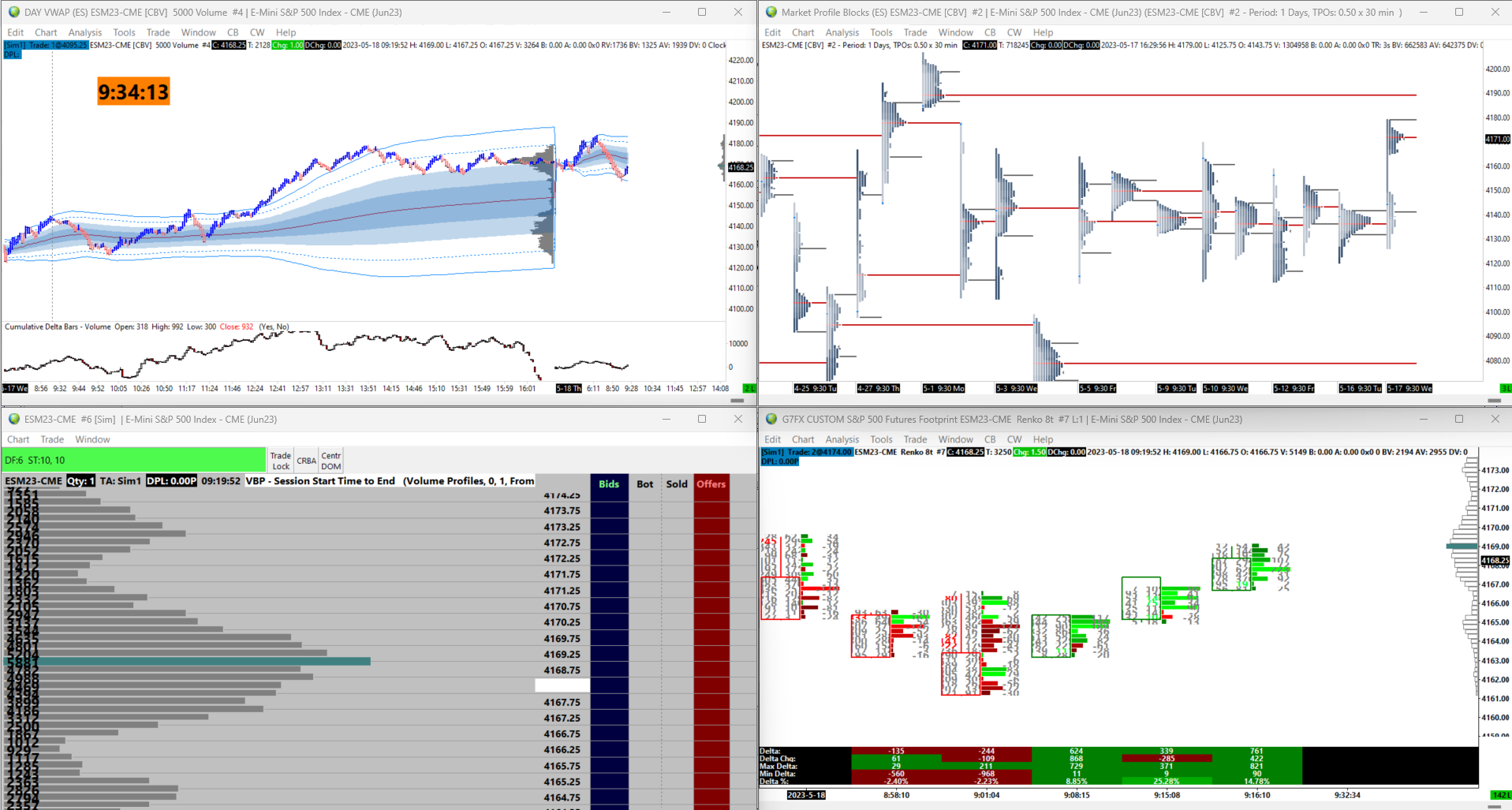

User577062 - Posts: 6
Deleted the folder and restarted Sierra Chart, issues still exists. I have attached my charts for you to see.
imageimage1.png / V - Attached On 2023-05-18 13:36:50 UTC - Size: 555.95 KB - 258 views

Sierra_Chart Engineering - Posts: 25424
Disregard the above. We think the problem has to do with the fact that you have an exchange active on your account but being you are on Service Package 5.
We made a change to your account. We want you to restart Sierra Chart now.
Date Time Of Last Edit: 2023-05-18 13:44:58
[2023-05-18 13:55:10]
Is all sorted and working nicely now. You are a star, thank you.
