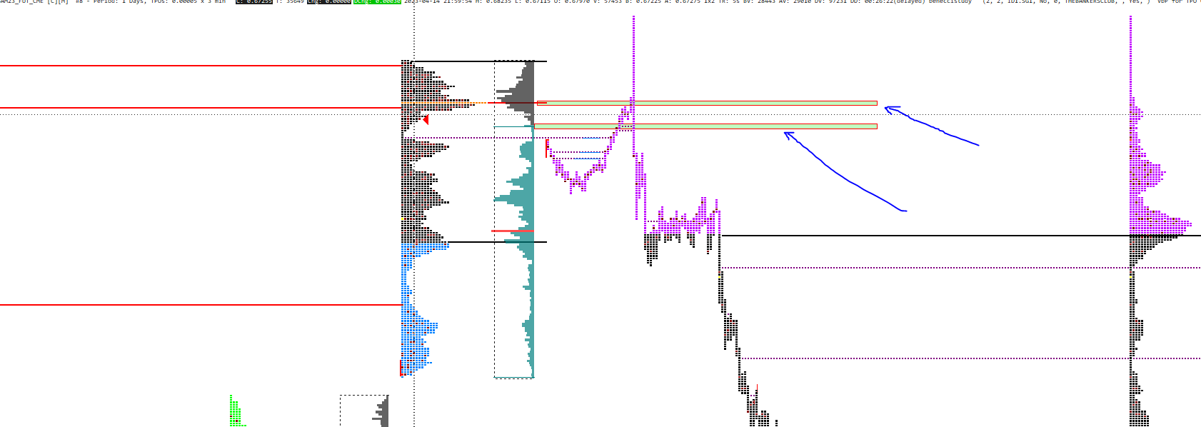

hello i want to insert an alarm if the price touch the rectangle. secondly i trade multiple pairs and i only have one screen so i switch between pairs.so as an example i do my analysis on eurusd and switch to gold chart but i still want to get the alert of eurusd when it reaches the desired level how can i do that.

You could either setup a drawing alert or use the options to reference a drawing in the simple alerts.
Refer to the following for drawing alerts:
Chart Drawing Tools: Chart Drawing Alerts
Refer to the following for how to reference a drawing in a simple alert:
Study/Chart Alerts And Scanning: Referencing Chart Drawings
You would have to have a chart for EURUSD open and have the rectangle on it in order to get the alert.
If you have a price that is not changing that you want to get an alert for, then you could use the Symbol Alerts. Refer to the following:
Alerts Manager: Symbol Alerts
