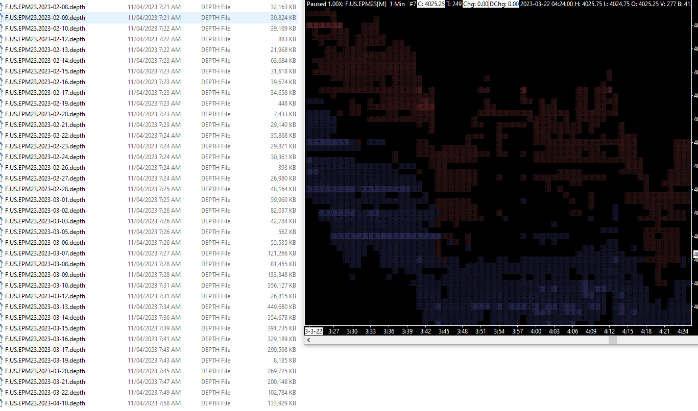

Hi - While utilizing the replay mode on Sierra Chart my dom will not replay and only displays a 1. I've been going through previous support tickets and I have been following the suggestions given by SC technicians to the best of my ability and I am unable to rectify the issue. I went through the Sierra Chart/Data/MarketDepthData and I have noticed there are many days where the file size is very low compared to what was recommended. I've tried downloading new data on serval occasions and I have also added the Market Depth Historical Graph study as recommended.

Correct. I am not seeing market depth data during the replay. The dom will stay stagnate as per the image I have attached while the remainder of my chartbook charts replays as normal. Yes, I see market depth data for the date and time I'm replaying, but only on the chart where the Market Depth Historical Graph Study has been applied.

It looks to be the data that is the issue. I was able to replay today's session on the DOM. I've been through the help sections on downloading missing data over the weekend and it still doesn't appear to be downloading the data correctly for me to replay on the Dom. I can see an obvious file size difference in today's session versus every other session that is recorded in the Data/MarketDepthData file. Any idea what might be causing the issue?

I spent all weekend going through the links you've put up and others I've found with similar issues. I believe it to be a data issue. For example, I wanted to replay the Dom for the 22nd of March 2023, and according to my market depth data file and the market depth historical graph study I had the data. Yet, the replay sent me to the 03rd of April 2023 which I had no file in the market depth data file or data on the market depth historical graph study. I followed the instructions to ensure my computer's time and date matched Sierra's as well. I apologize if I am missing something so simple, but I just can't seem to find a fix.
