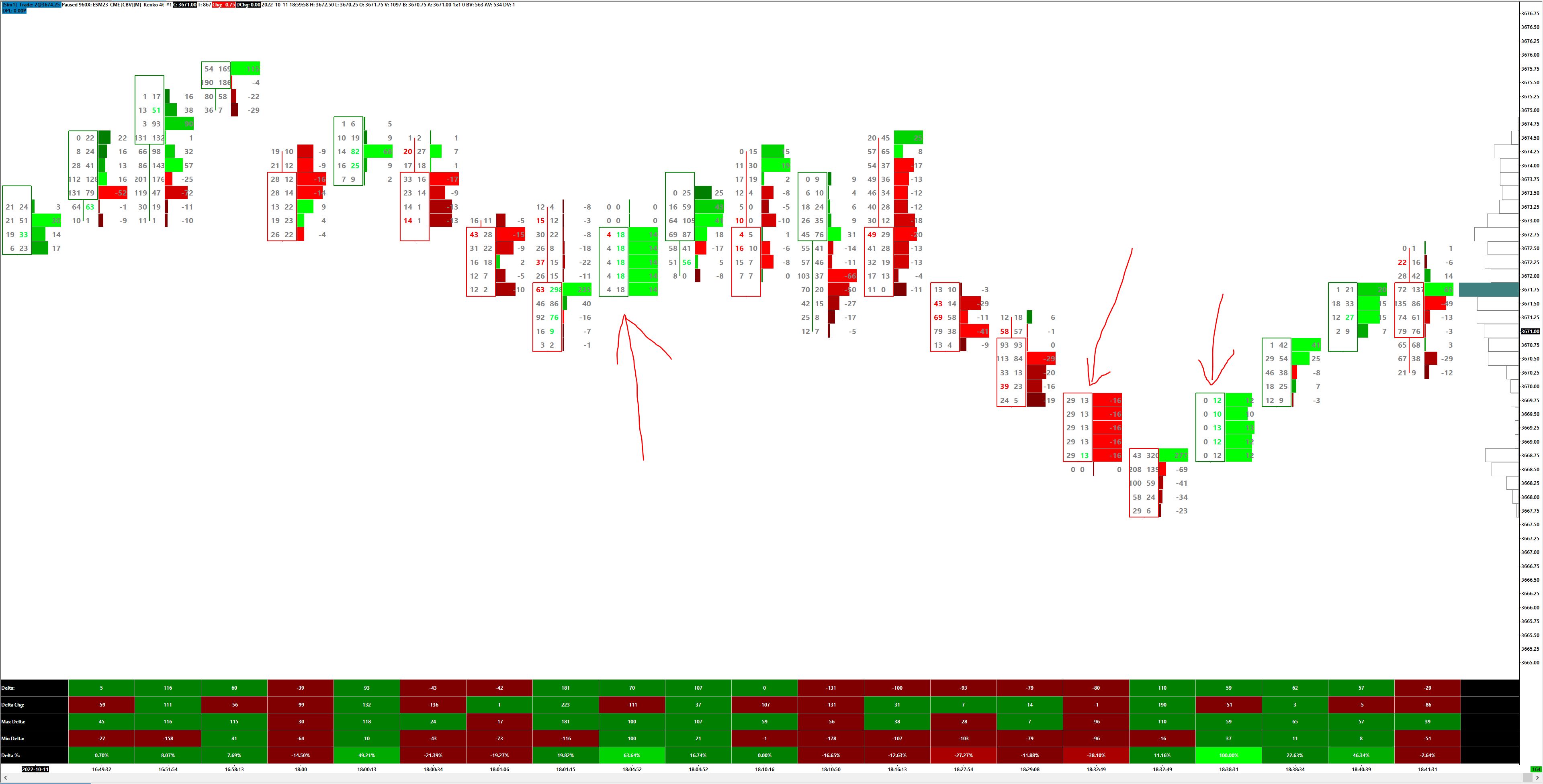

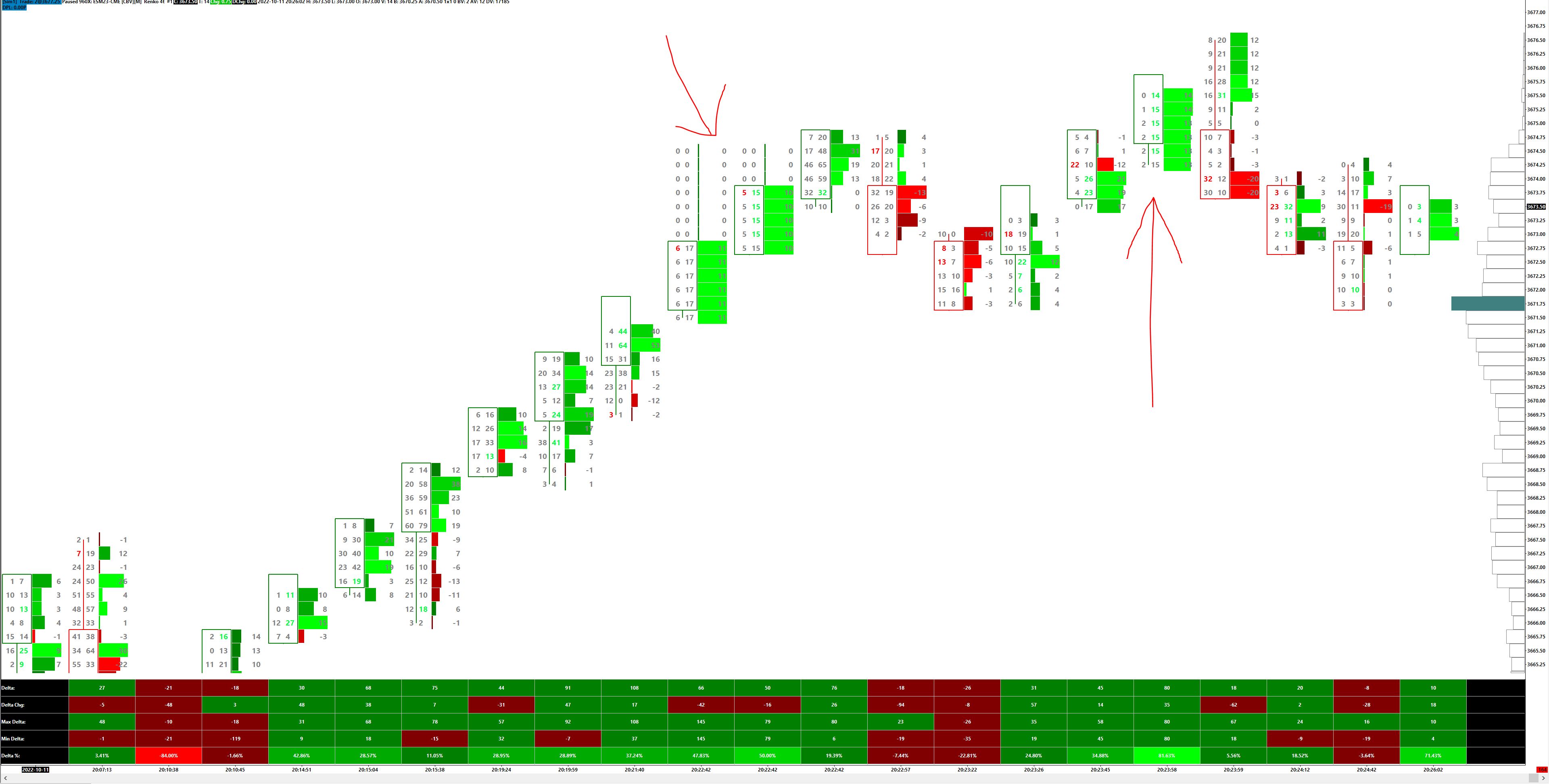

I’ve been doing backtesting on footprint, everything was fine until it started to show data like this -> picures in attachement.
My continuous contract is set for backtesting as well as intraday storage on 1 tick.. I updated sierra too but it’s still the same.
Waht else can be a problem here I can't find a solution.
Thank you for your help.
Regards,
Dennis
imageFootprint problem.2.JPG / V - Attached On 2023-03-29 18:53:10 UTC - Size: 448.89 KB - 595 views
imageFootprint problem.1.JPG / V - Attached On 2023-03-29 18:53:19 UTC - Size: 471.63 KB - 470 views

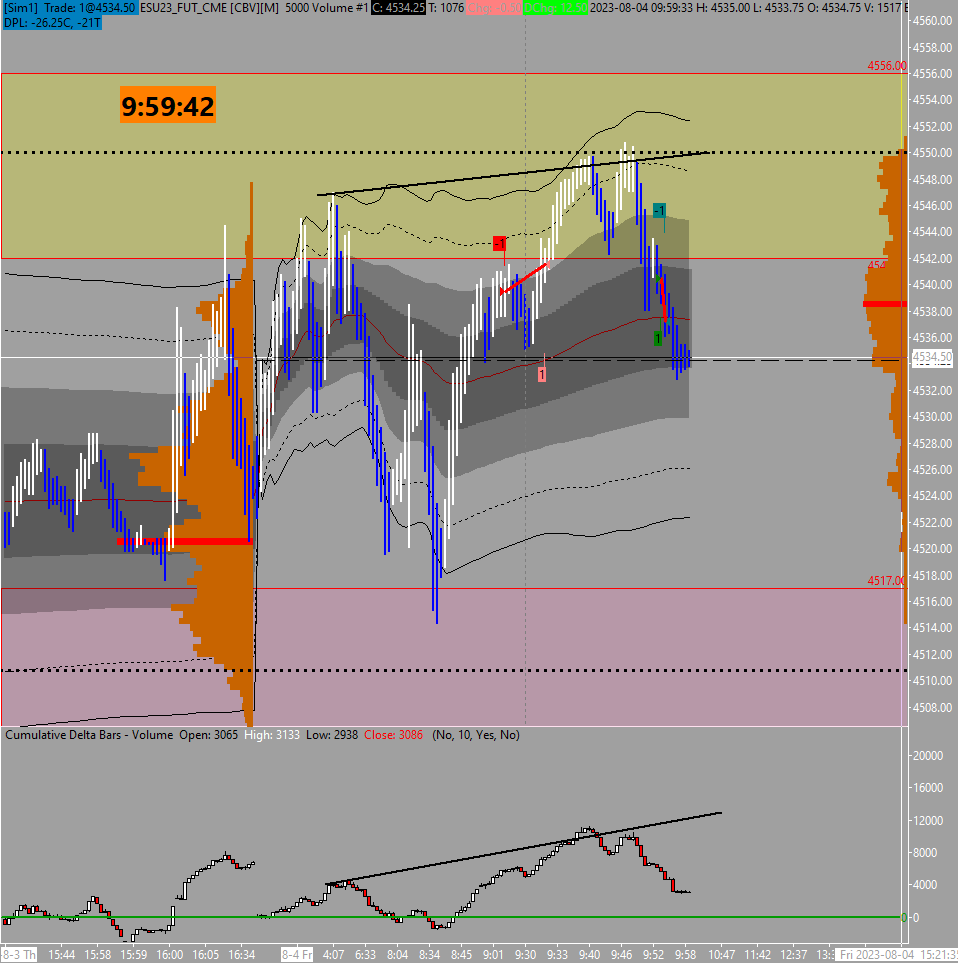

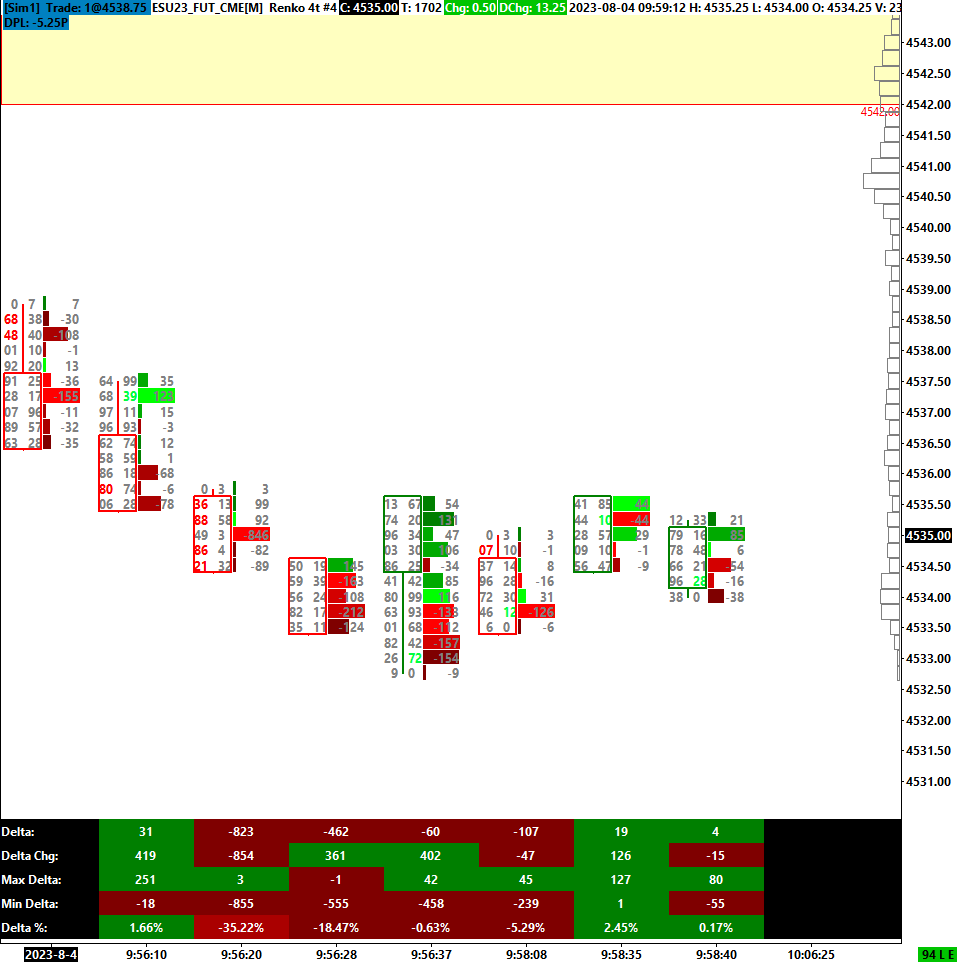

Yes ofcourse, this is live mode when its working normal:
https://www.sierrachart.com/image.php?Image=169115755327.png
https://www.sierrachart.com/image.php?Image=1691157574403.png

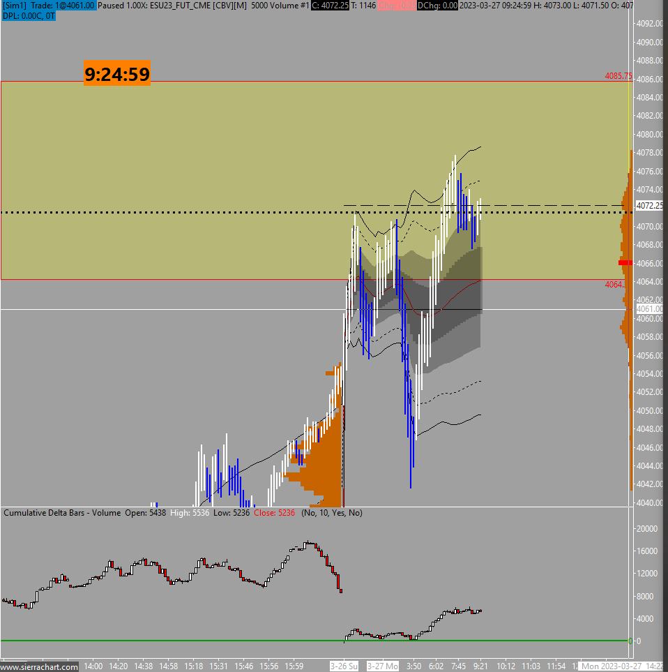

This is replay
https://www.sierrachart.com/image.php?Image=1691157641613.png
https://www.sierrachart.com/image.php?Image=1691157683947.png

We need to see the "Live" Numbers Bars `chart from the same time period as the replay is showing (around 08:00, but we can not see the date, so we are not sure of that).
Most likely the data is simply not there in the live mode either. If it is not, then you would need to delete and redownload the data from where the data is showing an issue. Refer to the following:
Data Errors or Spikes in Charts, Flat or Flat Line Graph, Compressed Graph, Errors with Date/Time Values: 2.1.2 Deleting and Re-downloading Data. (Easier and Recommended Method)

What we need to see is a Footprint chart from when you are in replay where it is showing the zeros in the footprints, and then an image from a "live mode" chart (not in replay) that shows the exact same time period for which you took the image from the replay.
In other words, if you are running the replay and the displayed date and times are from July 12, 2023 08:08 to 08:17, then we need to see an image of your "live mode" (not replay) chart from July 12, 2023 08:08 to 08:17 (or as close as you can get, it does not need to be perfect, but the times do need to overlap.
