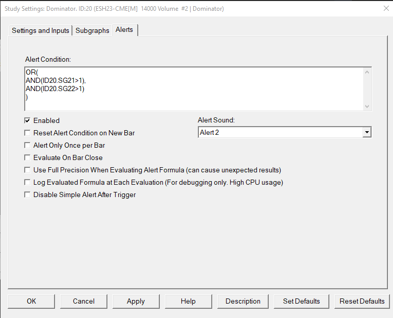

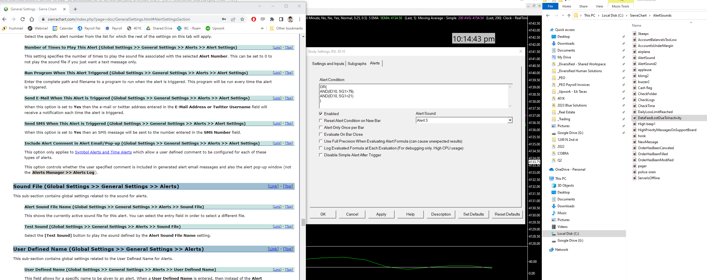

Thanks, The alert sounds don't work. I have alerts for certain conditions when they happen... how do I add them? Please see attached screenshot. I want a sound to happen when that condition is met. I tried Alert 2 & Alert 1, and no sound is made. Sometimes it happens, but then other times it does now. Any help on how to make this consistent? When this study setting occurs... I want a sound to play. But no sounds are played. And there are 200 alerts in the drop down menu... but only 2 alert sound wav files (see 2nd screenshot). Where are the rest?

[2023-02-10 16:38:36]
We see you have Alert 2 setup for the alert you created. Go to Global Settings >> General Settings >> Alerts and select Alert 2 in the Alert entry. This sets Alert 2 as the alert that is being edited on this page.
Go down to the Alert Sound File Name entry and select the .wav file you want to use as the sound. Any .wav file can be used, it does not just have to be one that has the word "Alert" in it. you can also add your own .wav files if you want. Refer to the information at the following link:

Once the alert is setup the way you want it, then it should work properly in your Alert. If you have an issue, check the Alert Manager window. Refer to the following:

This is very very odd. The default output device is correctly labeled. Do you have other .wav files I can use? When I test the sounds... some still work, the "alert" wav files don't seem to. Maybe they are oddly formatted or something?
Everything seems correct, except the alert files don't work / make any sound
