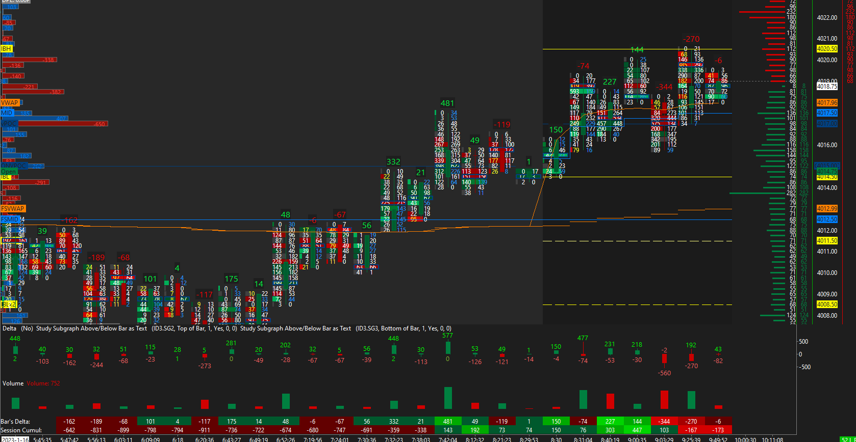

I am curious on how on this picture (@smashelito from Twitter) programmed the volume indicator above the number bars (the yellow rectangle), see picture attached.
How could I do the same on my charts?
Thank you

It's just a matter of setting the appropriate Region for the studies. For example, put the Volume study in Region 2 and the Numbers Bars Calculated Values in Region 3. Refer to the following:
Chart Studies: Settings and Inputs Tab >> Chart Region

OriolCasas - Posts: 190
I tried that, but it doesn't look quite the same.
First of all, I would like to remove the title of region ยบ, 2 and 3, where it says:
- Delta (No) Study subgraph....
- Volume Volume...
Then: There is an significant space between the volume and the number bars indicator. How can I change that?
Thank you

To remove the region data line, which will also remove the space, set the option under Chart >> Chart Settings >> Regions >> Region Number x to Hidden. Refer to the following:
Chart Settings: Region Data Lines (List) (Chart >> Chart Settings >> Regions >> Region Data Line menu)
